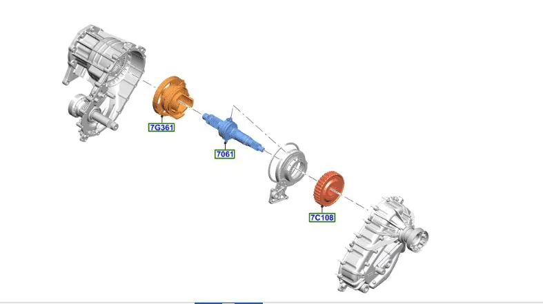

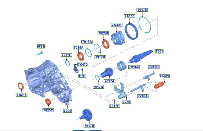

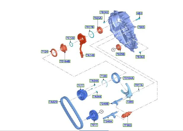

Could you share the diagrams you’re referring to? Watching the video @Snacktime shared earlier I’m not understanding how there is a lock on the 4A tcases. (There’s a lot of fluff watching him struggle with clutch plates. 4:46 and 15:58 are notable timestamps)
Advanced Tcase
Ford Bronco Transfer Case Technical Discussion IMG_5938
Non 4A tcase with locking mechanism:
Ford Bronco Transfer Case Technical Discussion IMG_5936
Ford Bronco Transfer Case Technical Discussion IMG_5937

This is the video where I had the “ah ha!” moment realizing there was no mechanical lockup! Actually sent it to @5GENIDN this morning with the timestamps to look at to show it.
When I replace the clutch I’m going to leave the Tcase installed. Doesn’t look like it should be too much of a hassle especially with the extra clearance of the body lift. But I’m certainly not opposed to pumping as much fluid in as possible until it seems the fill rate doesn’t match the spill rate then throwing the plug on as quickly as I can…
Your missing rhe part where the internal splines on the shaft actually do travel far enough to engage, makeing a mechanical connection. I'm driving mine with no front drive line right now and when I spin the rear tires in all-wheel drive the code comes on the dash and says " temporarily locked 4x4"...this happens when the motor pushes PAST the awd clutches mode, and engages the inner splines past the clutch pack.
