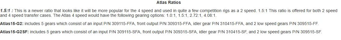

My part time case has been good, no chain noises! The fact 2.72 ratio works means we should have some compatibility with a 4 Speed Atlas. Really just need to focus on what sensors we currently have in the transfer case and how to dummy them out.
https://www.advanceadapters.com/3-a...ZTp4dsjapV-y-qfnsmdx9dWdNZH2YMMMZXzjXXHs9Nqh_
Personally I would be happy with the 2- speed. I know Loren Healy put one in, but there were no details only pictures but that Bronco got wadded falling off the trailer into a ditch :sneaky:
