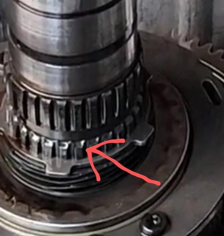

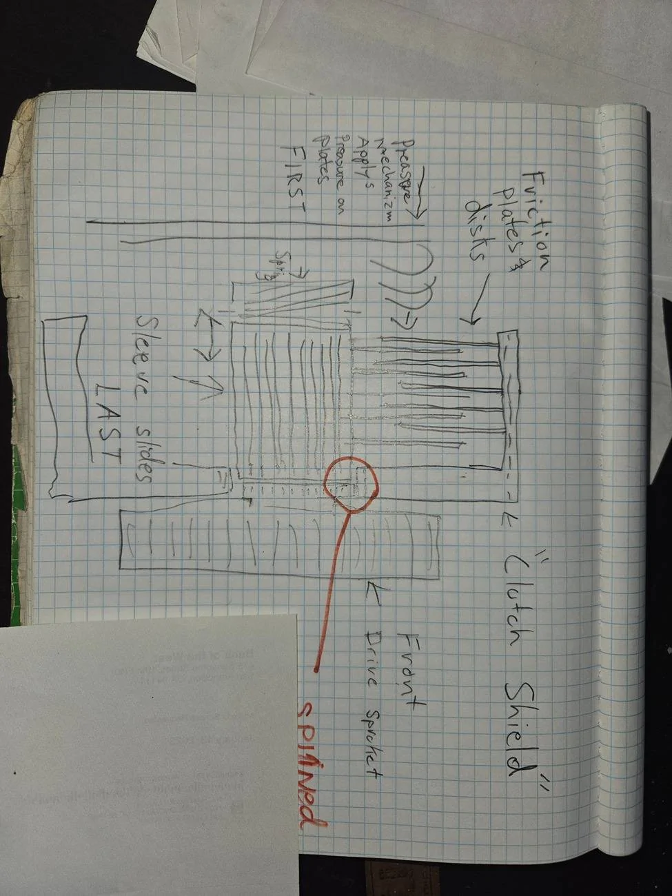

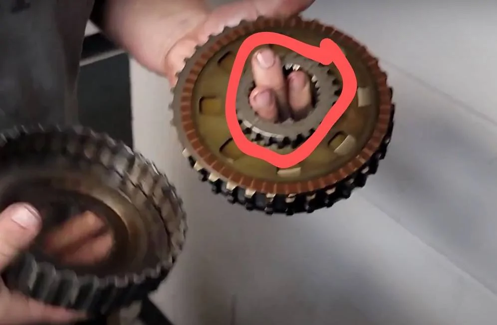

The inner sleeve also moves as well otherwise it wouldn't have a spring attached to the four prong washer behind it
I think it works like this, for the first portion of the movement the squish is on the clutch plates themselves then once it gets to a certain point it begins to slide the inner splined sleeve the last portion of the movement which causes the engagement of the splines at the same place the gear has the splines
Could you draw what part you’re referring to on the picture? Brain no haz understand

this part slides
Ford Bronco Transfer Case Technical Discussion Screenshot_20250316_101535_Chrome~2

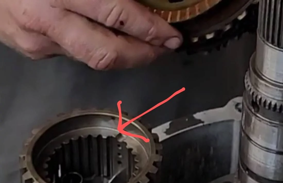

and engages with the same splines as this part.
Ford Bronco Transfer Case Technical Discussion Screenshot_20250316_101807_Chrom
which is the inside edge of this part
Ford Bronco Transfer Case Technical Discussion Screenshot_20250316_101654_Chrom
So in 4H or 4L they share the same female splines ...

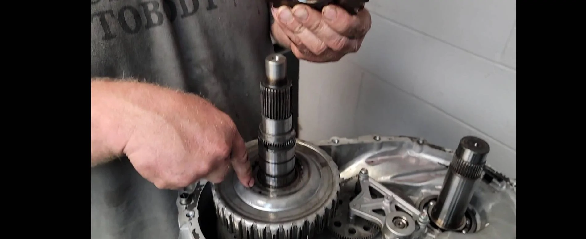

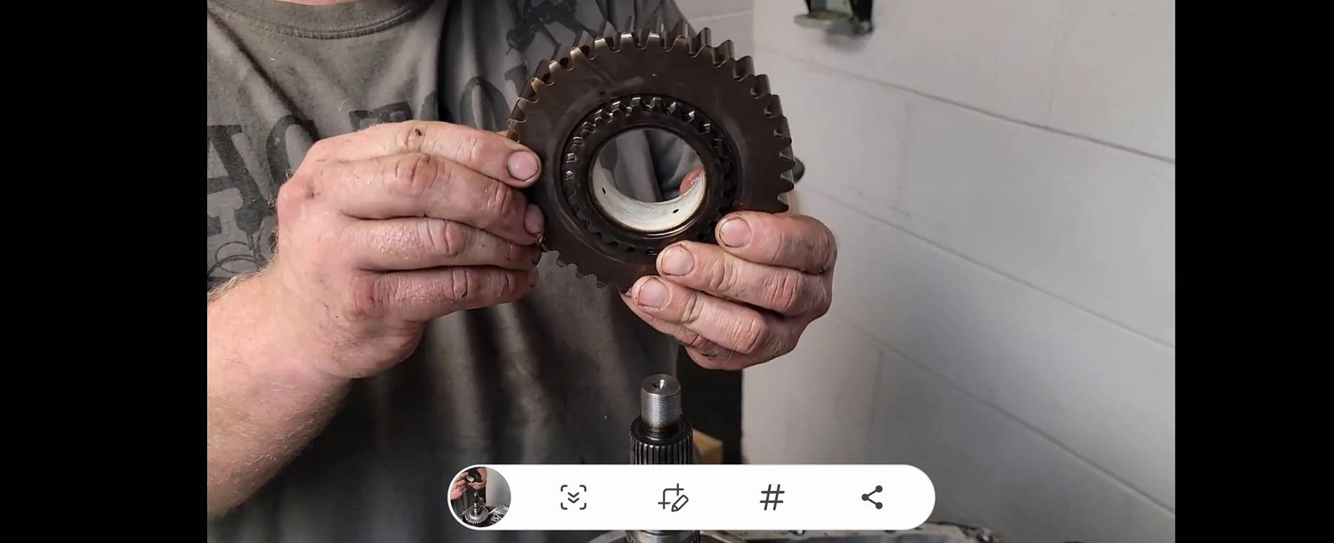

These bottom teeth attached to shield on the front drive chain gear.
Ford Bronco Transfer Case Technical Discussion Screenshot_20250316-110703
Fit into the shell
Ford Bronco Transfer Case Technical Discussion Screenshot_20250316-110656
Which does not key into the splined drive
Ford Bronco Transfer Case Technical Discussion Screenshot_20250316-110525
The friction coated disks key into the center and steels key into the shell no mechanical connection to the front drive sprocket.
Fit into the shell
This is what it looks like to me also. None of those pieces are actually sliding along the shaft. Just the internal parts of the clutch that are fixed on the spline.
Fit into the shell
I
Maybe, but it looks like it functions like this...especially because the splines on the side of the front drive gear are the SAME shape and size and number of splines as the inner sleeve 🤔

it also appears this sleeve moves
inside of here
I think... and again I could easily be wrong but I think... that spring is exerting movement down not up... I think it is the return spring for the pressure plate.
The shaft has to be able to split or disconnect or de- spline at some point there ...here's the reason, how else would you get reduction gearing in low range to the rear drive line Shaft or either of them, unless before that clutch it can decouple itself from 1:1 and become 3:1... the center shaft cannot be solid or it would not work

The shaft has to be able to split or disconnect or de- spline at some point there ...here's the reason, how else would you get reduction gearing in range to the rear drive line Shaft or either of them, unless before that clutch it can decouple itself from 1:1 and become 3:1... the center shaft cannot be solid or it would not work
Oh agree but that is on the other side of the case isn't it? That should be like the simple old gears of the old transfer cases.... I would hope it is happening downstream of the clutch pack but for some reason I doubt it. I bet it is upstream... And that would place considerably more torque on the clutches. Should be able to tell by aligning the input with this power shaft... If the input is aligned with this shaft the gear reduction would have to be down stream... If it is not then the reduction is upstream. (probably)

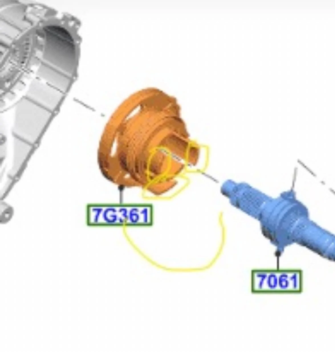

These are engaging into the clutch housing if I’m interpreting the picture correctly?
I believe that portion is the planetary gear set that gives us 3:1, by engaging the two keys on either side, depending on where the motor pushes that sleeve back depends on if it engages BOTH then its 1:1, engage only 1/2 way and it likley reverts to 3:1...the blue shaft shows 3 lines at the wide point which would make sense, first is input side, inner center is for rear drive, and goes through the hollow outer (rearward) shaft for front engagement.
