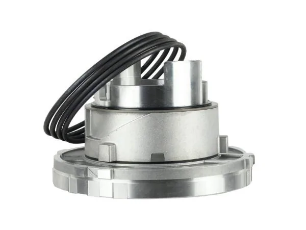

Ford Bronco Transfer Case Technical Discussion 1742985454783-0y
Ford Bronco Transfer Case Technical Discussion 1742985498391-hl
You’re gonna need to help me out with some words to explain what you’re getting at.

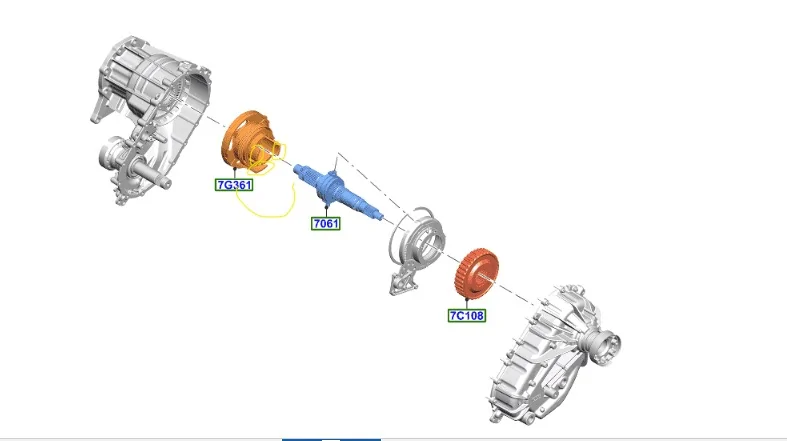

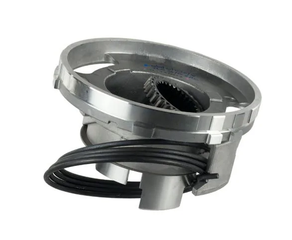

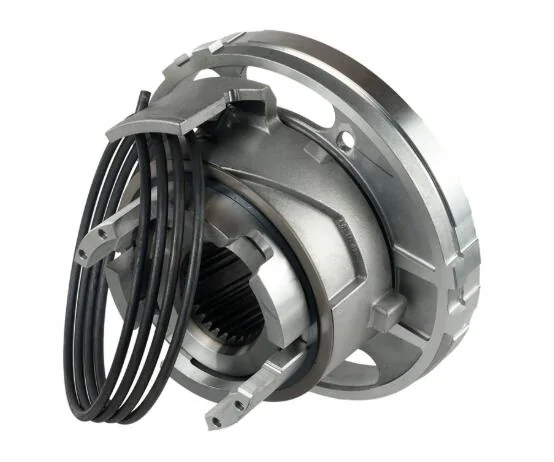

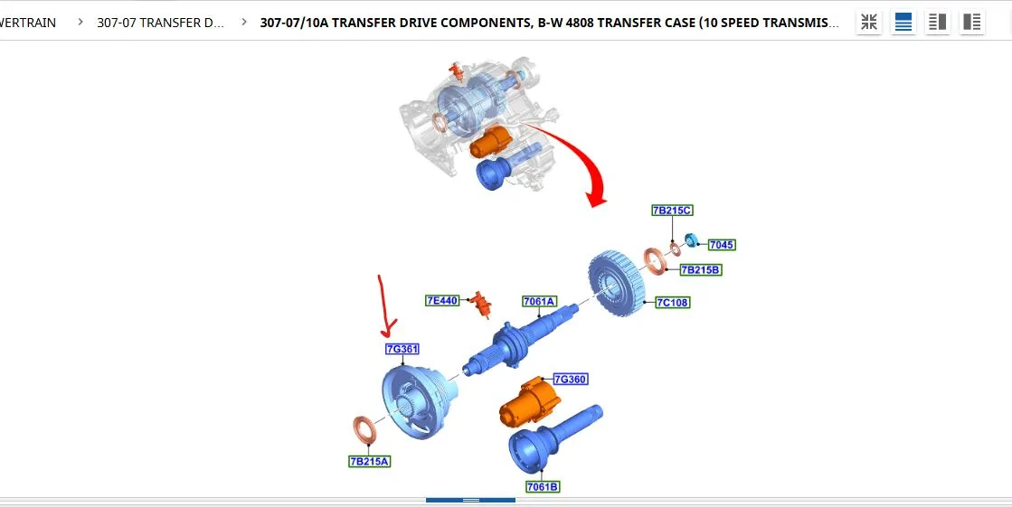

Sorry, in between 7 things and doing none well at the moment. The catalogue, at least Microcat, does not have much on the BW-4808 so the illustration is about all there is for Raptor internals for now. The first pic (7G361) is what they're calling a spring. Obviously the following two were of the main shaft and the clutch assembly. Just thought posting them would provide some visual clarity for these three pieces. I have nothing to else of substance to add and have not read the whole thread.

I gotcha. Much appreciated. Trying to go back and forth between the two it looks like the big difference is the unlabeled silver gear mechanism in the normal case and 7G360 in Rappy case? But that could just be not shown in this angle, like how all the other components aren’t shown. Also 7061 vs 7061A? 🤔🤔

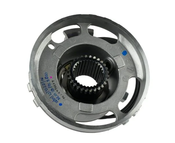

This part looks very similar to H3s 4494 4:1 Gearset

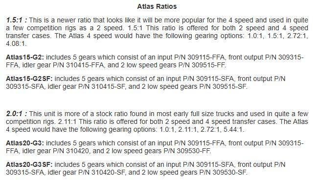

The hope is the planetary reduction between the cases swamp around. That would make for a quick gear reduction and testing. I will still be holding out for a 4 speed atlas as I want a higher low range for snow wheeling. I haven't fully decided on 1.5:1 or 2.11:1 reduction for snow. My transmission gets to hot in high range and low range lacks wheel speed.
