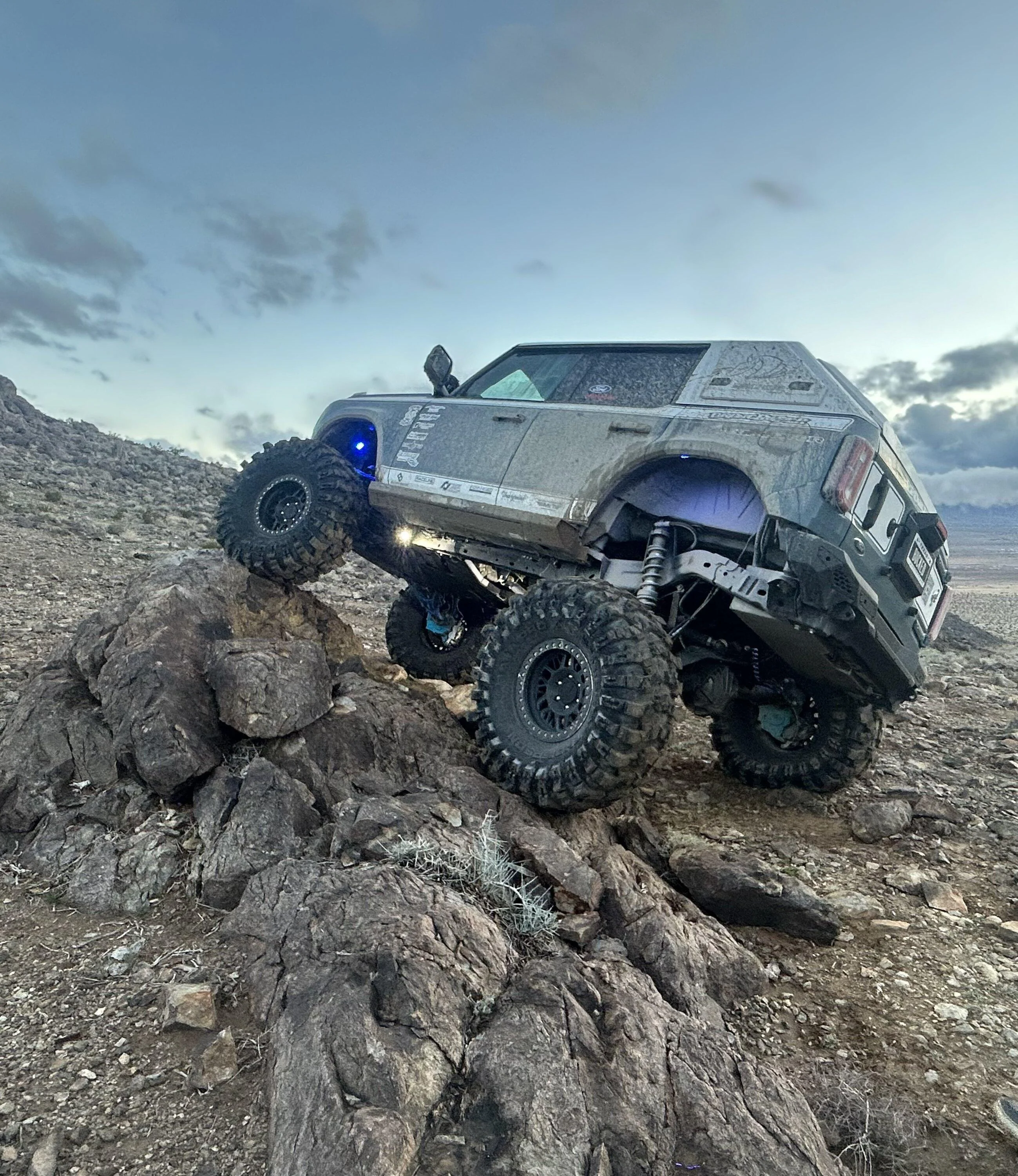

Thanks for sharing! What is the lift and wheel/tire details?
2-1/2 inch coil overs.....
the portals raise the axles 3.88 inch.
40x13.5 Nitto trail grapplers.
No real rub so far.... did ever so slightly catch the edge of the front capable bumper while in reverse with a slight flex and turning.... Easy trim.... Still need to cycle and check everywhere but it has been sitting in the garage as I have been driving my daily to work and it has been raining pretty constantly while in the high 30s and low 40s for the highs...

Curious, did you have to recalibrate speed with Forscan after the portal install?
Speedo is off a little bit right now but not drastically... May 2 or 3 MPH at 35 to 40.... Have my ProCal tune on order.

There’s a Bronco on portals just down the road from me. (not 74weld though) One of Bronco Buster’s.

I don’t know anything about that other than our friend’s son had it in his shop a few weeks back, possibly rebuilding those portals. They took 2 Broncos out to California last week. Pic above taken out there.
