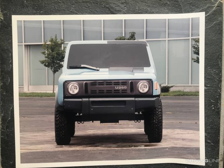

Was reading through an old article this morning on the U260 prototype in the early 2000s, and I couldn't help notice the ground clearance (helps that there was no powertrain on the roller). I immediately thought of your build @5GENIDN .

See how you are... Now you have me going down another rabbit hole... :unsure: ;) That undercarriage looks high and tight. No pumpkins, shock mounts, or trailing arm links visible. Square fenders too! Well on some of the models. If they are taking anything from that study today maybe we will see that roadster!

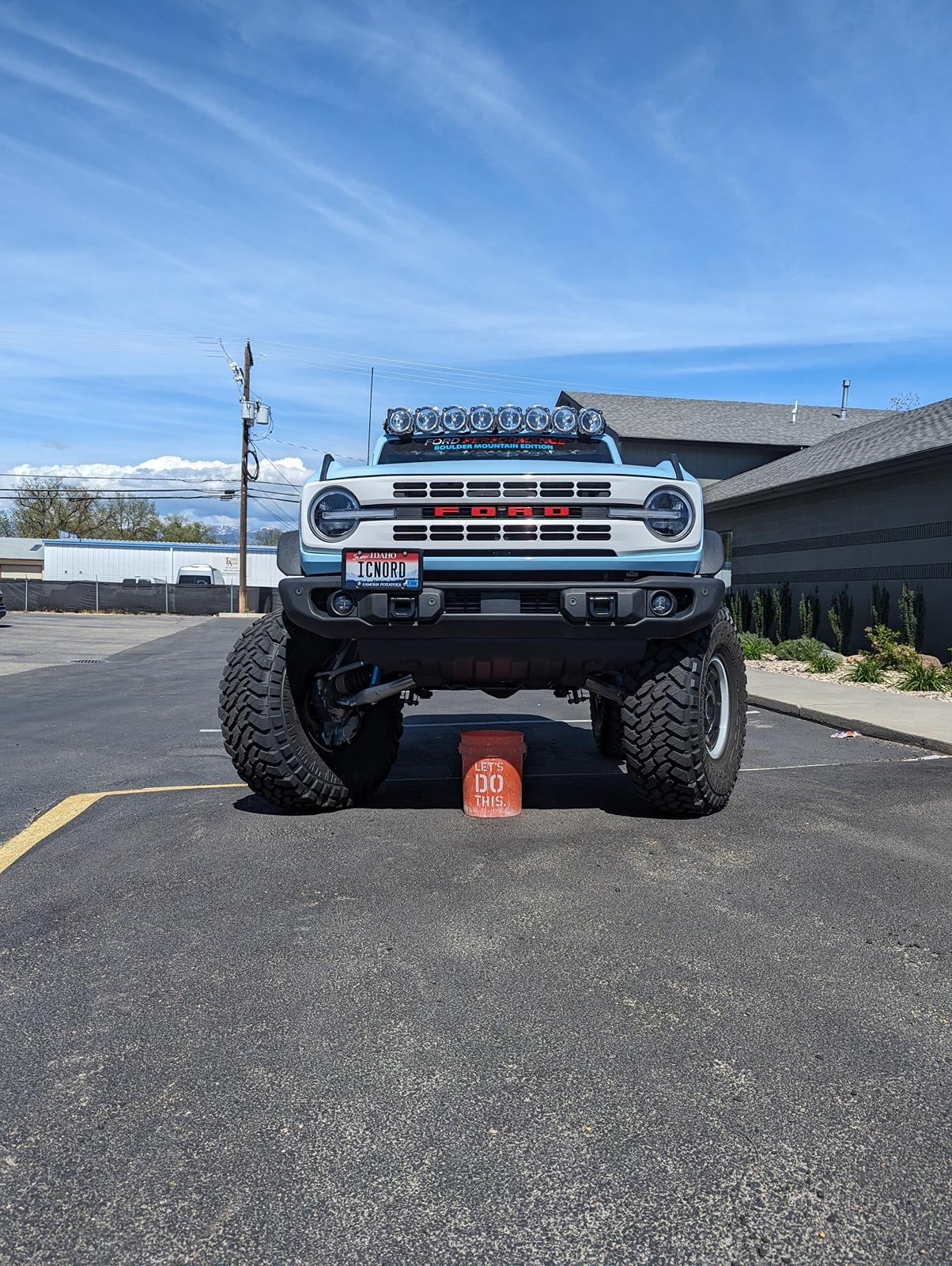

Ford Bronco The new Boulder Mountain Edition Build .... (prototype) Clearance for days
Yes that is a full size 14.5 inch homer bucket under there....

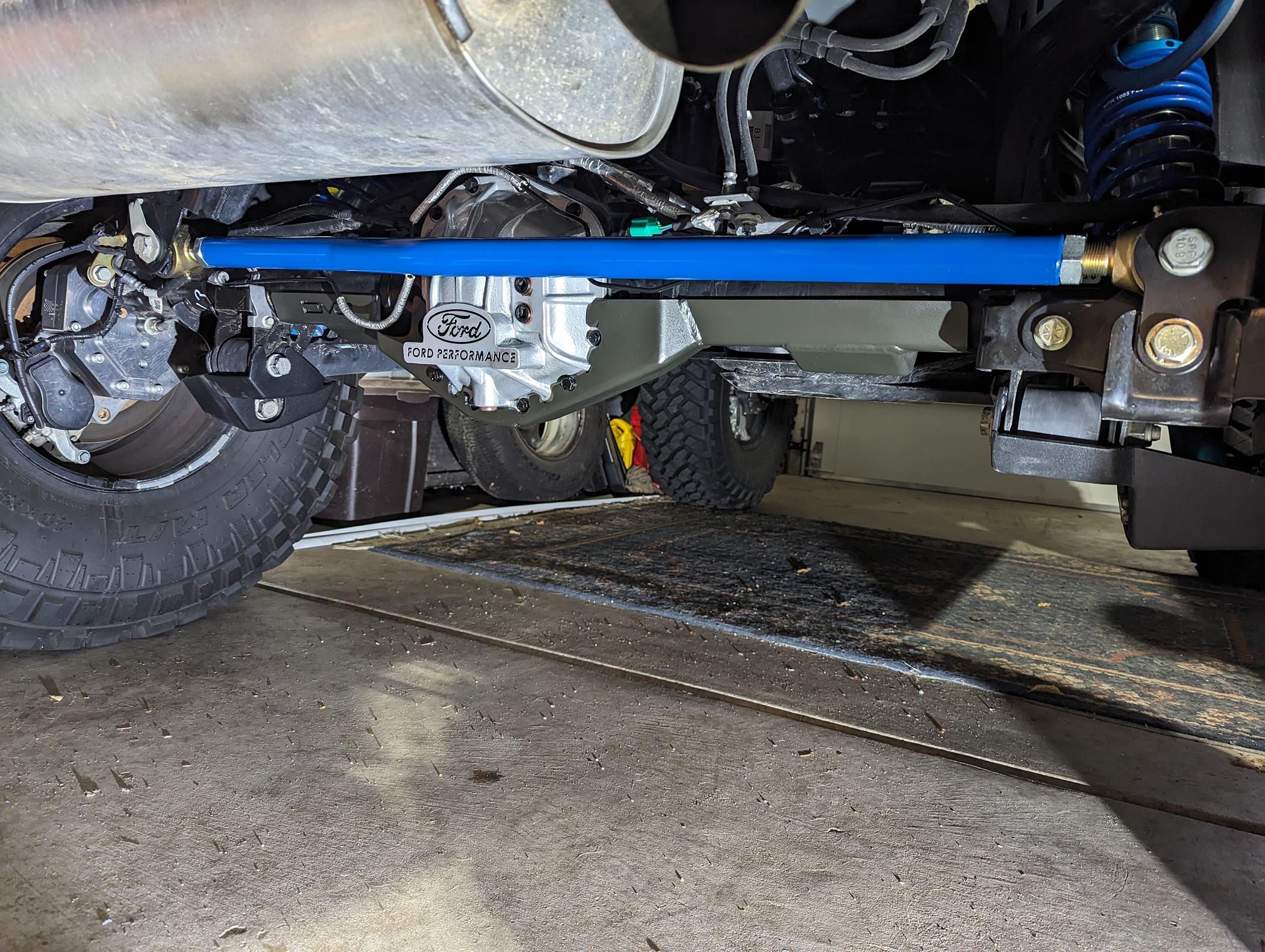

Installing track bar and diff skid and shock skids this weekend... Hope to get the new core 4x4 trailing arms on next week.

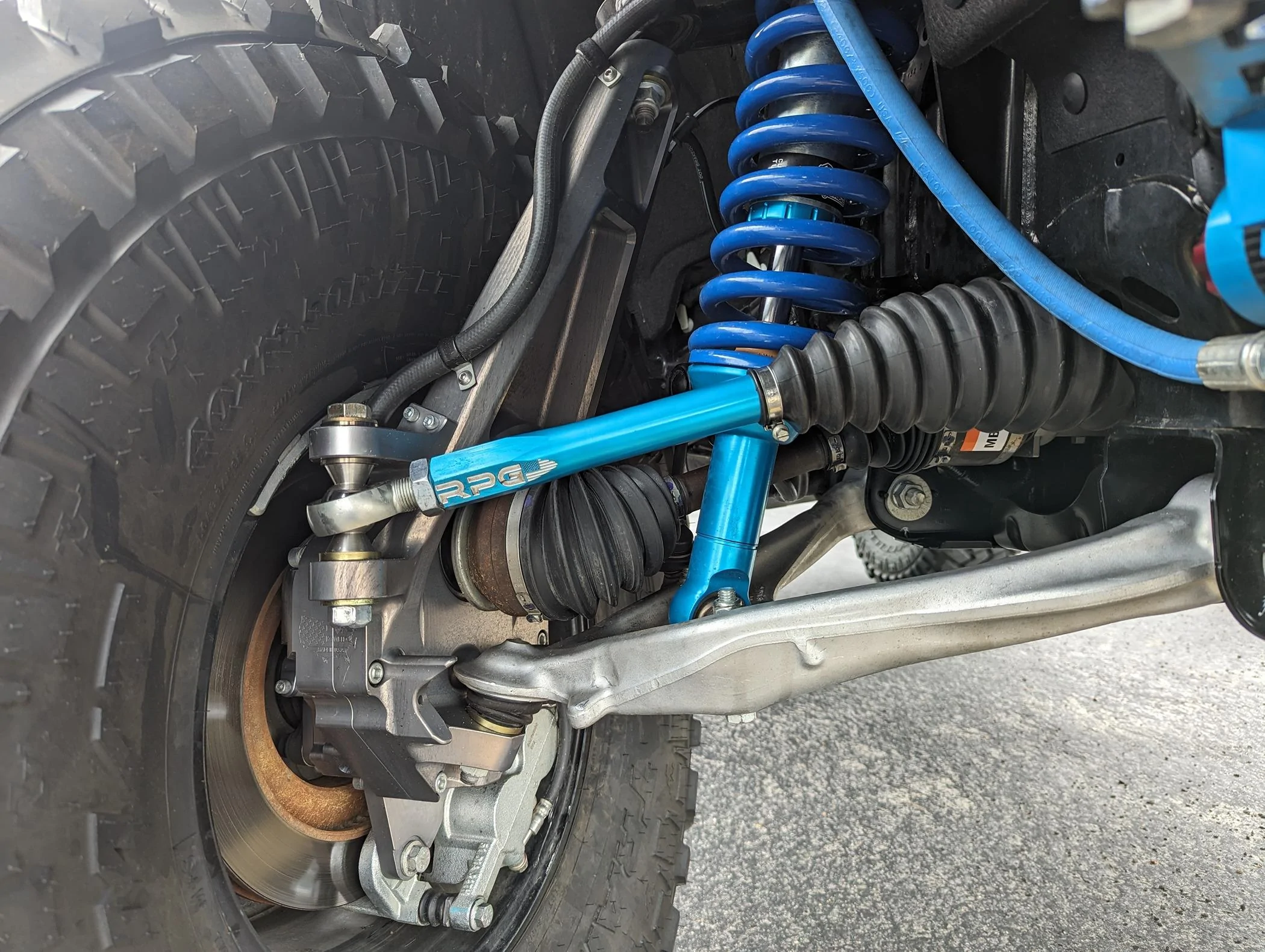

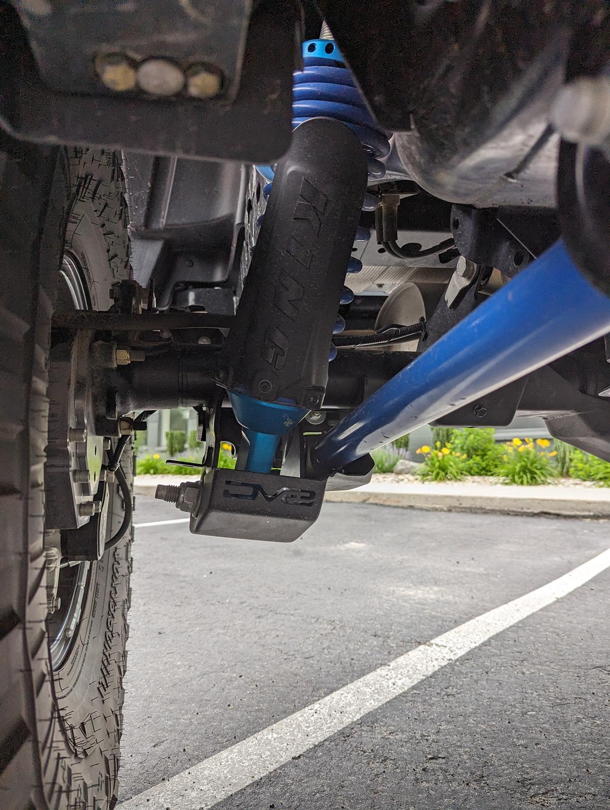

Finally got my upper and lower trailing arms from Core 4x4 on. With the Johnny joints at each end I am hoping they will give me about 2.5 to 3 inches or more additional articulation... We will see. And I Also got the RPG Tie rods with double shear hiems mounted!
Ford Bronco The new Boulder Mountain Edition Build .... (prototype) RPG Tie Rods
Very nice! Sounds like you’re not going with the triangulation kit?
Not at this time.... I think the triangulation kit probably rides better (no lateral movement during cycling) and well I ordered these about a week before the triangulation kit was released. They have been sitting in my garage for a while now. I think I should be able to get close to the articulation the 4 link is capable of because of the Johnny joints at both ends, I will not be able to match it but should be close. With my pan hard flat I really do not get very much bump steer. Some but not terrible. The 4 link should eliminate all of it.
We must be lucky as we never felt that steering issue going over expansion joints and bumps. I will be curious to see what bump steer is like with the rpg double shear heim tierods. Not using ours for high speed desert stuff it’s not really an issue anyway but still of interest to see if there’s a difference
Well it will be very different. The rear track bar as it cycles moves the entire body left and right. Only a fraction of an inch but enough that it redirects the front tires. The biggest problem when this happens is over correction by the driver. The ever so slightly shorter tie rod cycle will create a toe change. Only hundredths up to tenths of a degree, not dramatic. but it does not change the vector direction of the front tires. So far I have not even noticed any pull or change in direction.... But time may change my experience and opinion. What few miles I have on them I have not noticed any effect.

If the stock rear control arms are limiting articulation because they don’t allow twist like a spherical type, then they are putting a tremendous amount of stress on the mounts and maybe why some are cracking. Rear control arms might be my next upgrade. Our main offroad thing is technical rocks.
How much twist do the Johnny Joints allow compared to spherical rod ends?
Johnny Joints are a specific type of spherical end. I think they will remove some of the resistance to twist that the polymer bushings have innately. That should eliminate SOME of the twisting pressure on the frame mount. It is that resistance to twisting with the poly bushing on the axle side that put twisting pressure on the frame mount because the arm itself wants to stay aligned with the axle and at the same time wants to stay aligned with the frame. each working against the other. The spherical or Johnny joints allow that twist with very little resistance.
Check out Core 4x4.... very impressed with their product and with the price. I went with the new crawler series. The damn arms are twice the weight of the stock arms.... 14 lbs 8 oz vs 8 lbs (lower arm weights).
