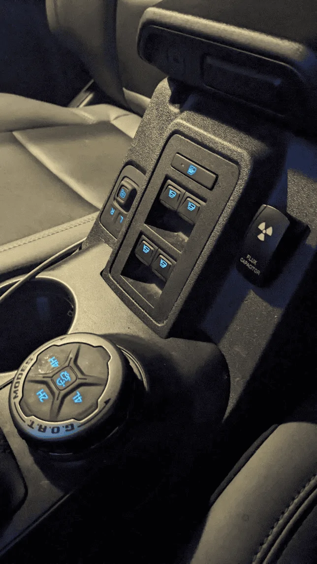

Front locker is hooked up, 15amp fuse to the battery with the relay being powered by key on power. Picked up the hood latch plug off ebay and put my switch near the the magic dial.

Most canned tunes map for whatever, but usually take a few tanks of 93 to get where it should once using 87. Now it’s another story if you’re actually on a dyno. I Like the location of the switch and looking at your interior I gotta get to scrubbing on mine.
We've loved following your build journey! Thanks for sharing :love:
