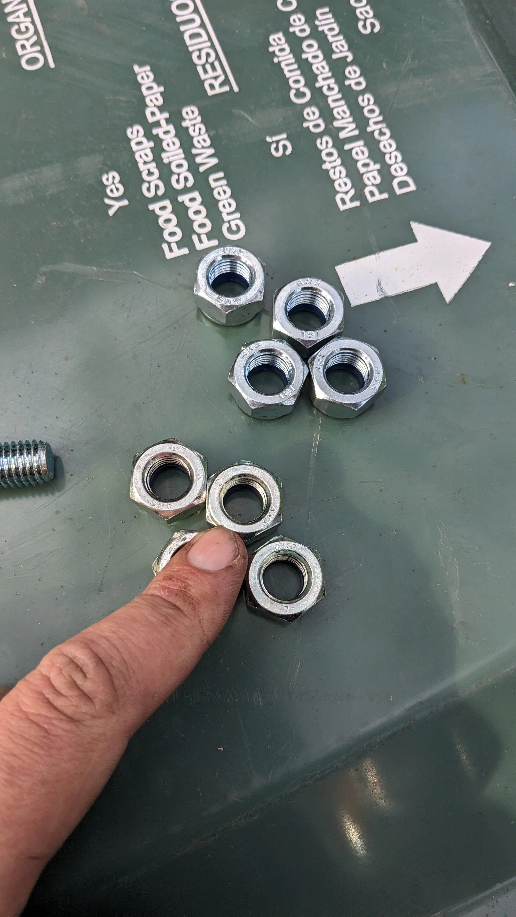

new design from down under. just ram em home as they're the new style lock nut:rolleyes:
are they plated and stainless sets of nuts? pic looks like ss on the lower set

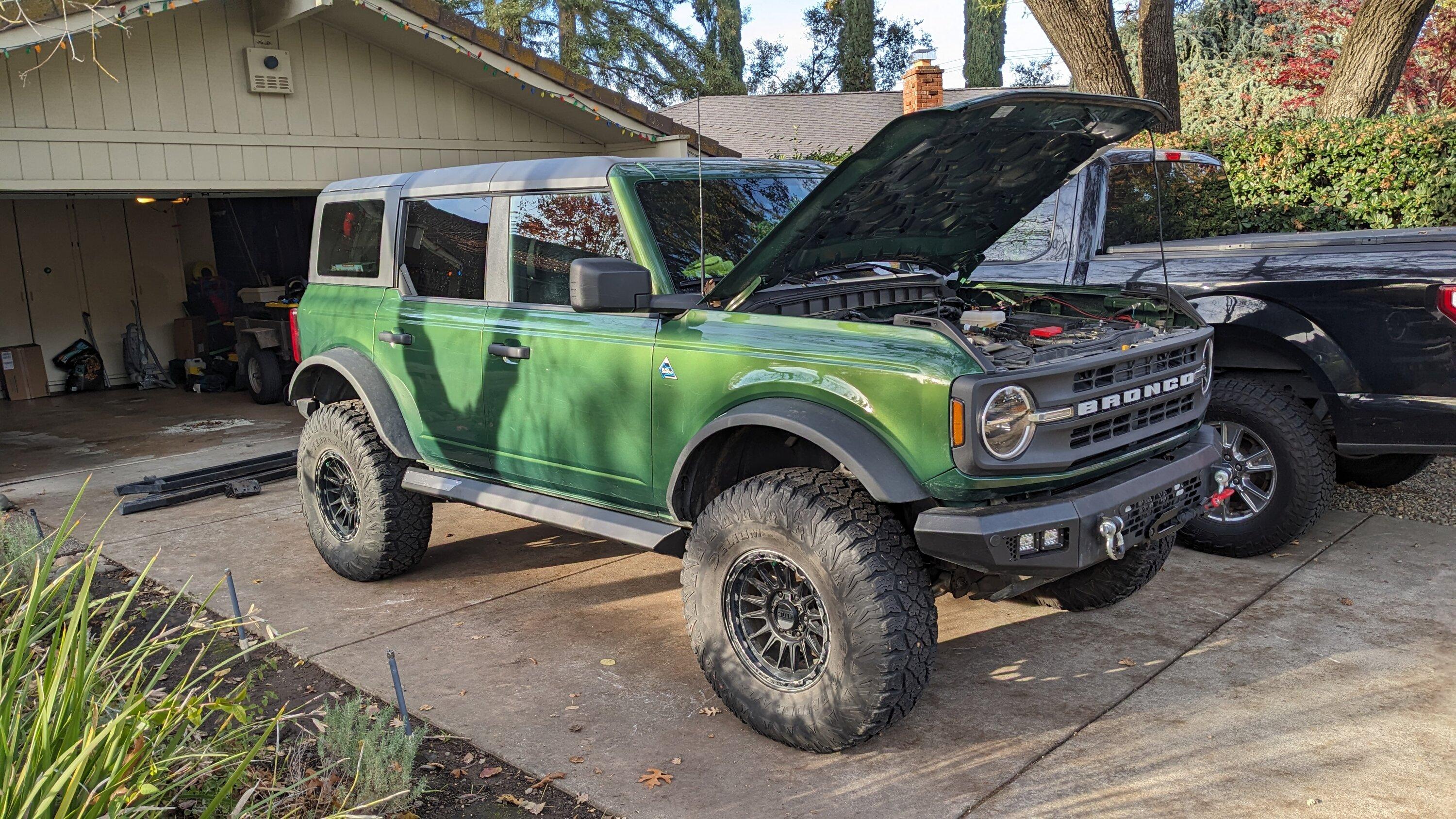

Missing 2 bolts on the front of each slider, will hit ace hardware to grab nuts latter. All back together and got a metal on metal clunk when I hit the driveway curb on my test drive. I have 1/4" of in and out movement in the passenger cv. Going to sleep on it but the passenger side might have to come apart again and see if the outer slieve moved during assembly.

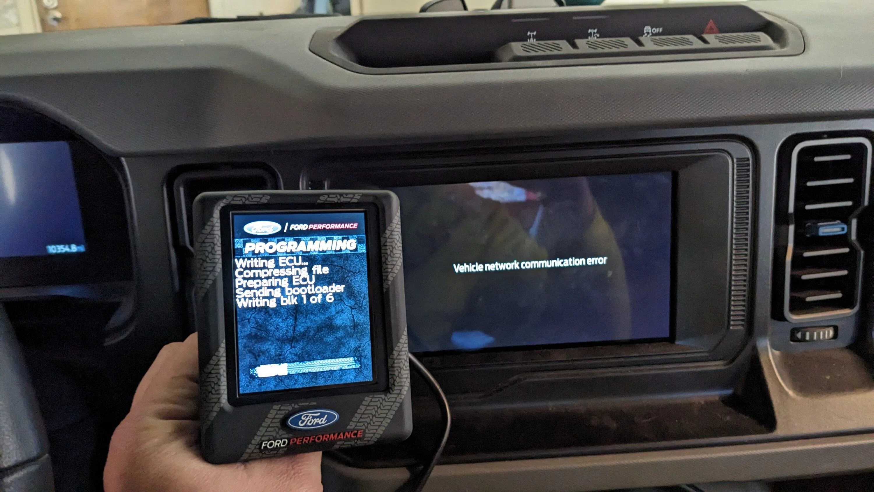

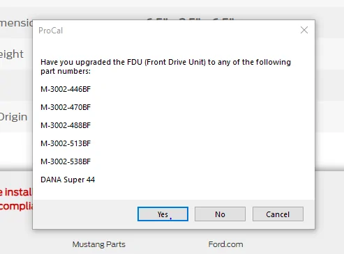

@Dusty so you plug the procal into the computer for 20 minutes, then into the bronco, then back into the computer and this box comes up after you log in. Nice run on sentence I must say!
