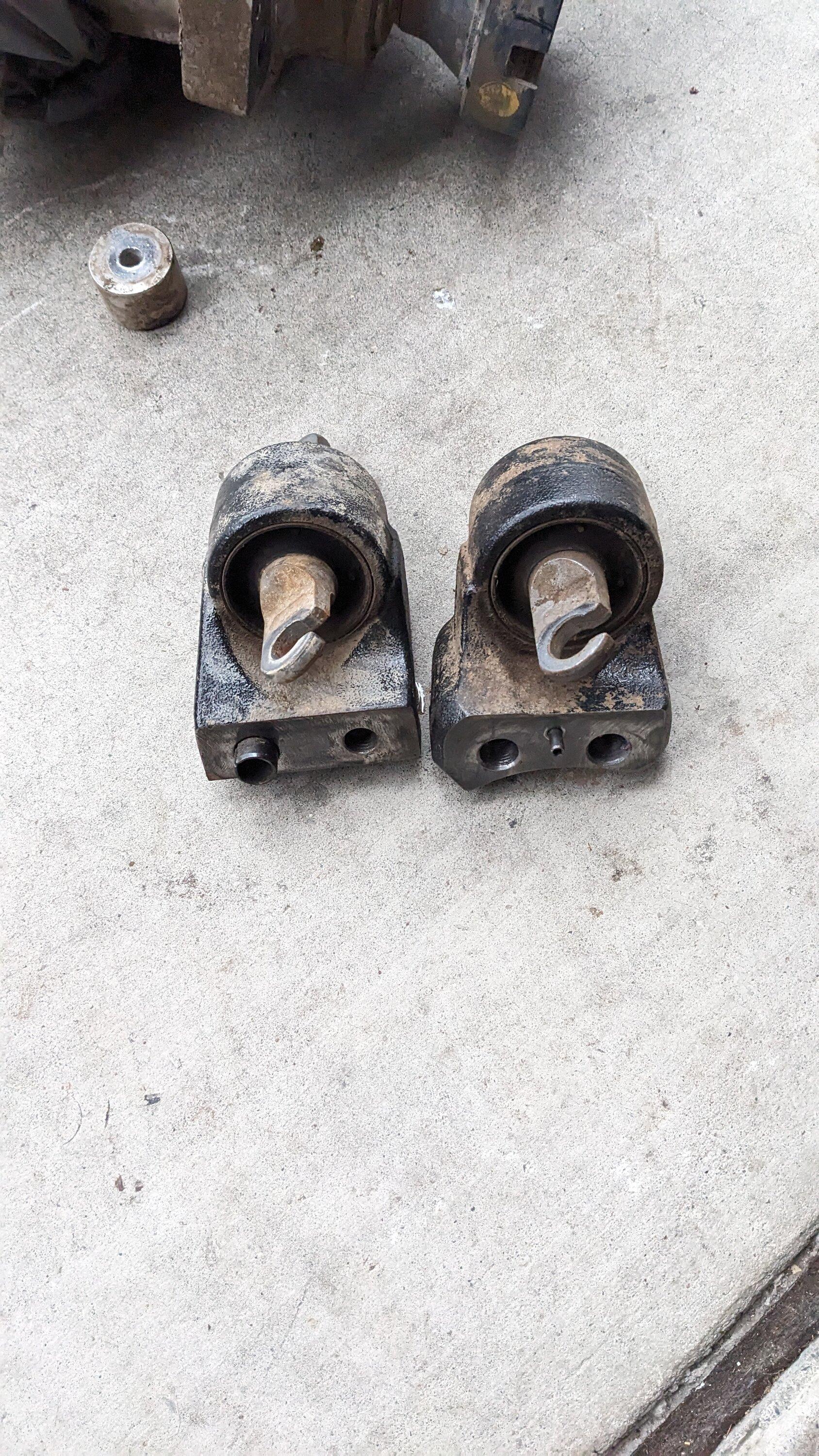

Fuk me they are different
Set the front mount w/ a marlin spike & pass mounts bolt lightly in to hold it. Then you can get the top mount sorted. 🤠

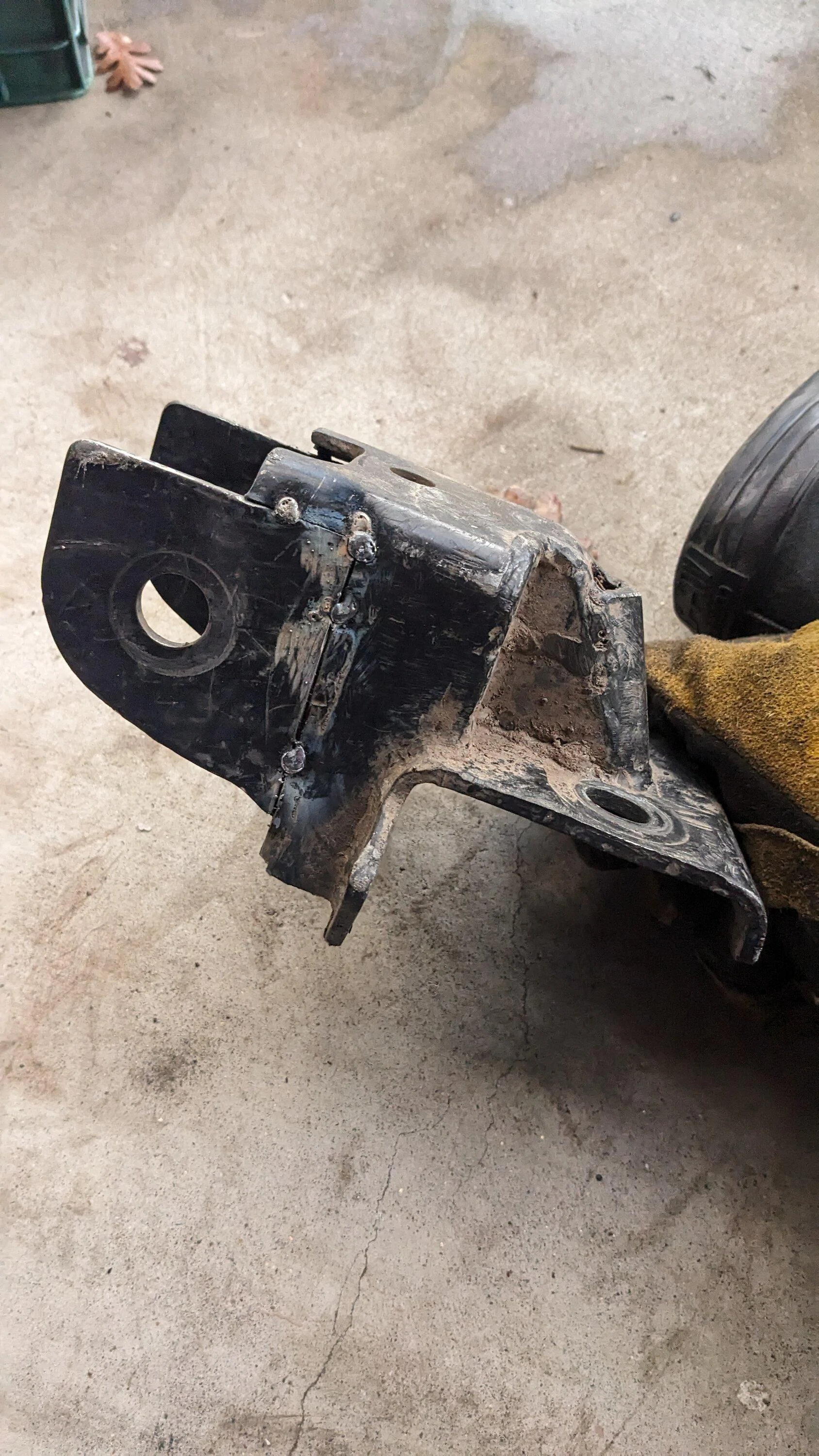

Let me fix my passenger side a second time, accidentally have to much drop right now after bust the stud and welding a bolt on. Passenger side is 1.25" of drop and driver is .75".

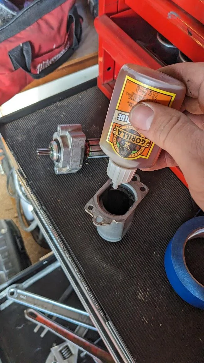

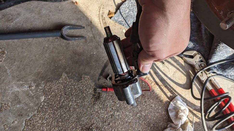

So the actuator worked with the magnets housing removed. Could switch between 2Hi and 4hi no issues, no codes. Glued it back together so the motor would stay put and no go. If you stall the motor out you get no codes. Does not operate of position switches so my original attempt at using a relay was a waste of time.

I approve of the use of Gorilla Glue in an automotive setting. :p
