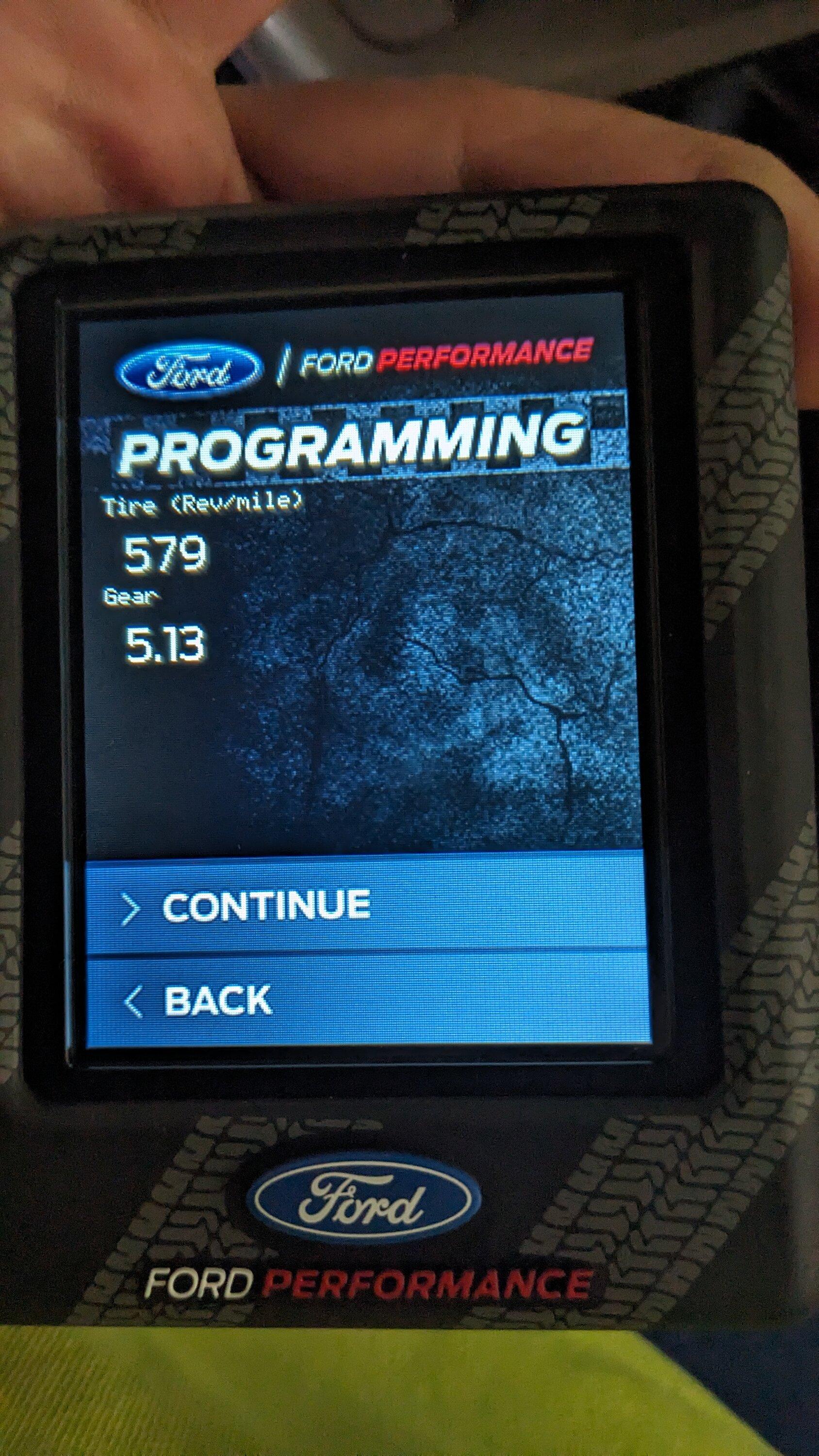

@Dusty so you plug the procal into the computer for 20 minutes, then into the bronco, then back into the computer and this box comes up after you log in. Nice run on sentence I must say!
Cool! So I guess I'll just use the p/n for the 5.13 even though I Frankensteined mine together rather than buying that p/n. Wonder why it needs 20 minutes to think about it.
EDIT: Still not happy it cost me $600 just to delete the FAD :(

Well that didn't answer the question you replied to but I've already bought mine. It includes the tune and I got it for $600 during Lethal Performanc'es Black Friday sale. It is my understanding that the ProCal by itself would not do the FAD delete as that feature comes with the tune from Ford (though I may be wrong about that, it was just an assumption). So like I said, $600 just to stop the computer from throwing a code for deleting the FAD. I have no complaints about the performance of the 2.3L engine, and I can't benefit from adjusting shift points because I have a manual transmission. So yeah, $600 to delete FAD. I've already bought it. But I'll still bitch about it LOL
That said, if by chance there is some small performance benefit running regular gas I'll take it, as a bonus. But I'm not going to run premium gas to do it. I live behind the iron curtain (California) where gas is already too expensive.

You have to have the tune to get the FAD delete. It asks you if you changed the front diff when uploading the performance tune to the Pro-Cal. This is why Ford says you have to buy the Bronco Pro Cal.
