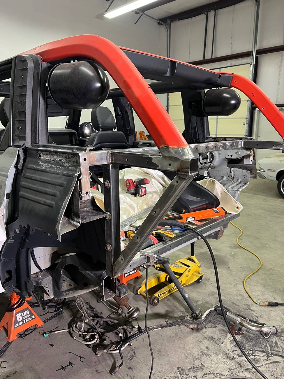

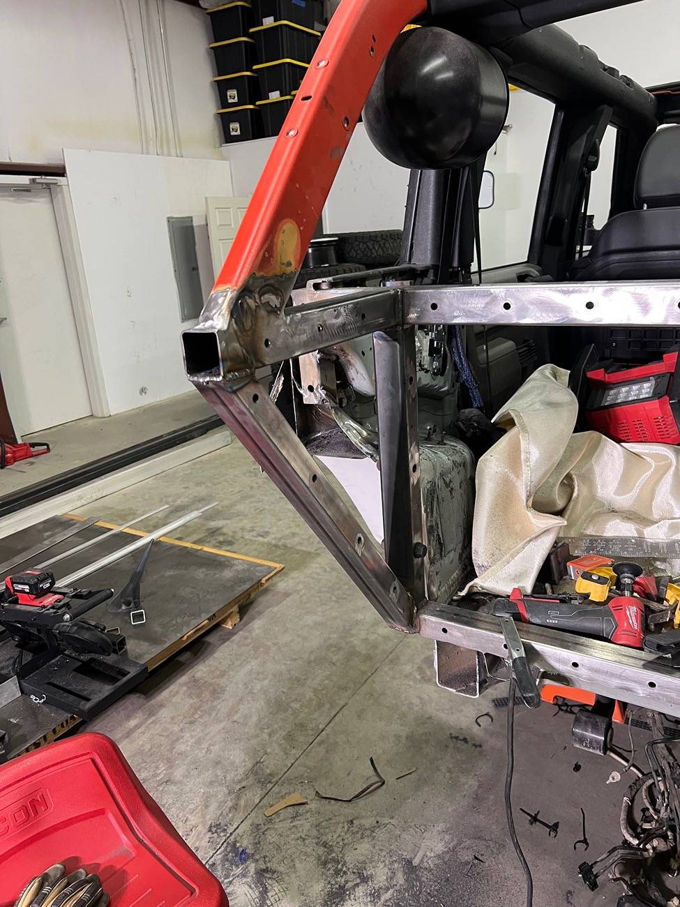

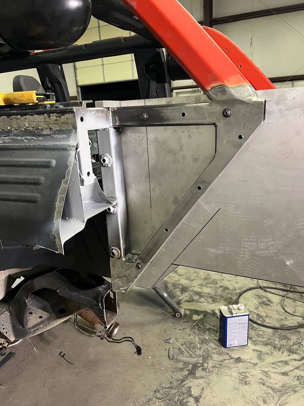

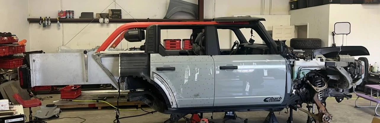

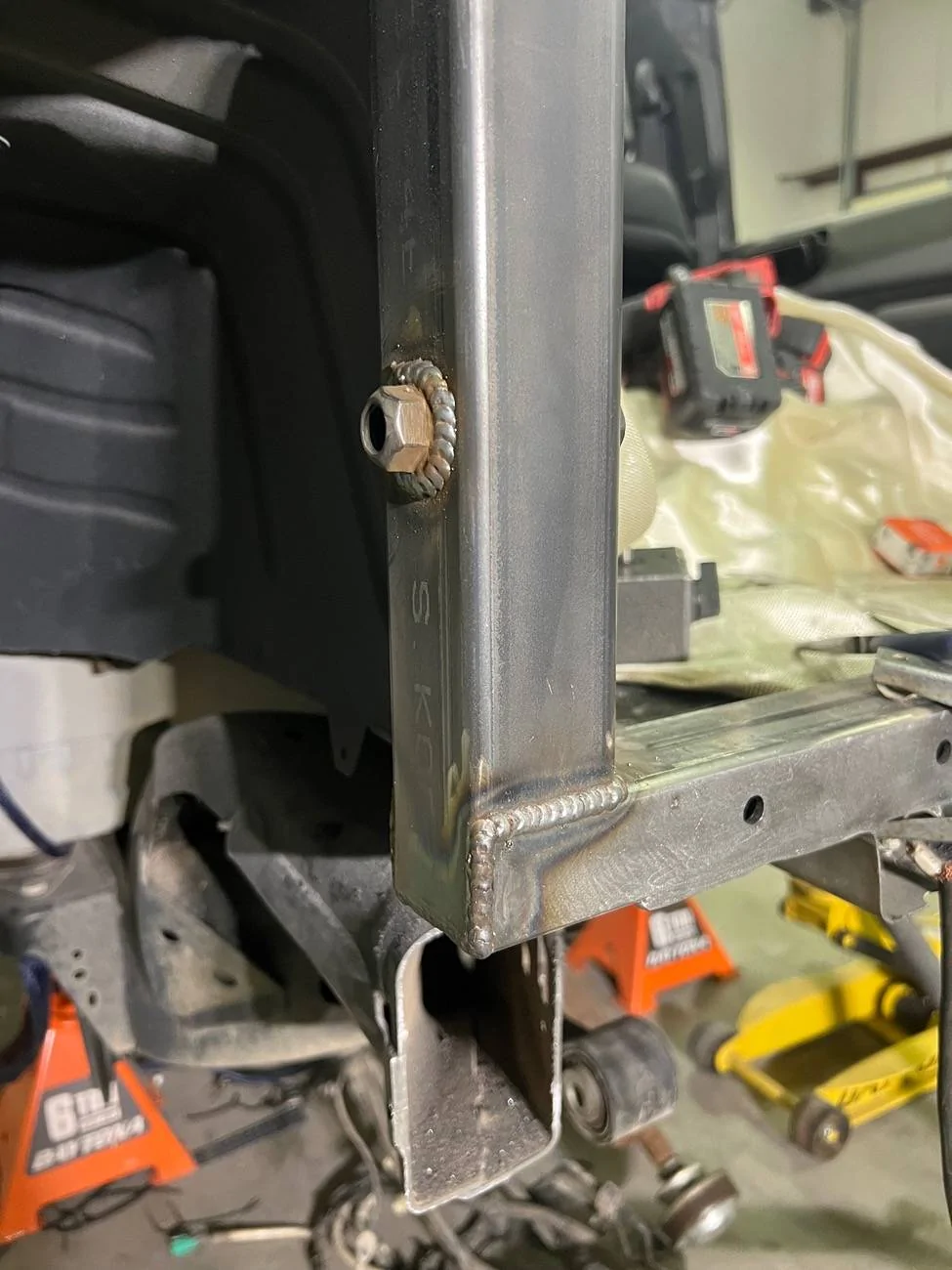

Small update, I’ve been busy with other aspects of life.. Anyways, this is the final pieces of the cab-to-bed structure before I seal the side with sheet metal and start on the aluminum bed. The bed bolts into the structures you see here. Frame work should be soon, very soon.

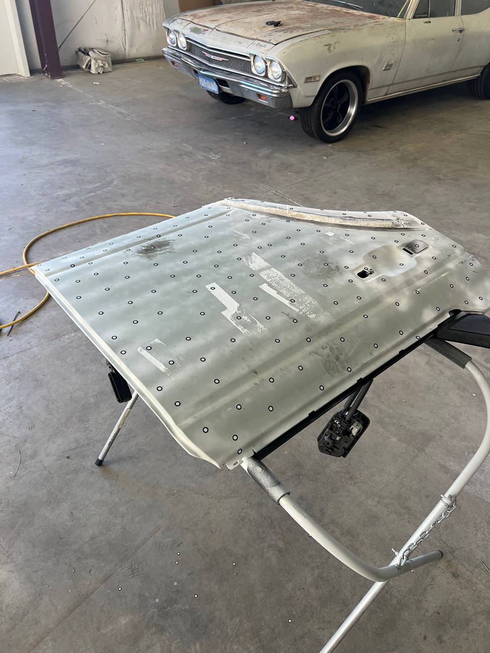

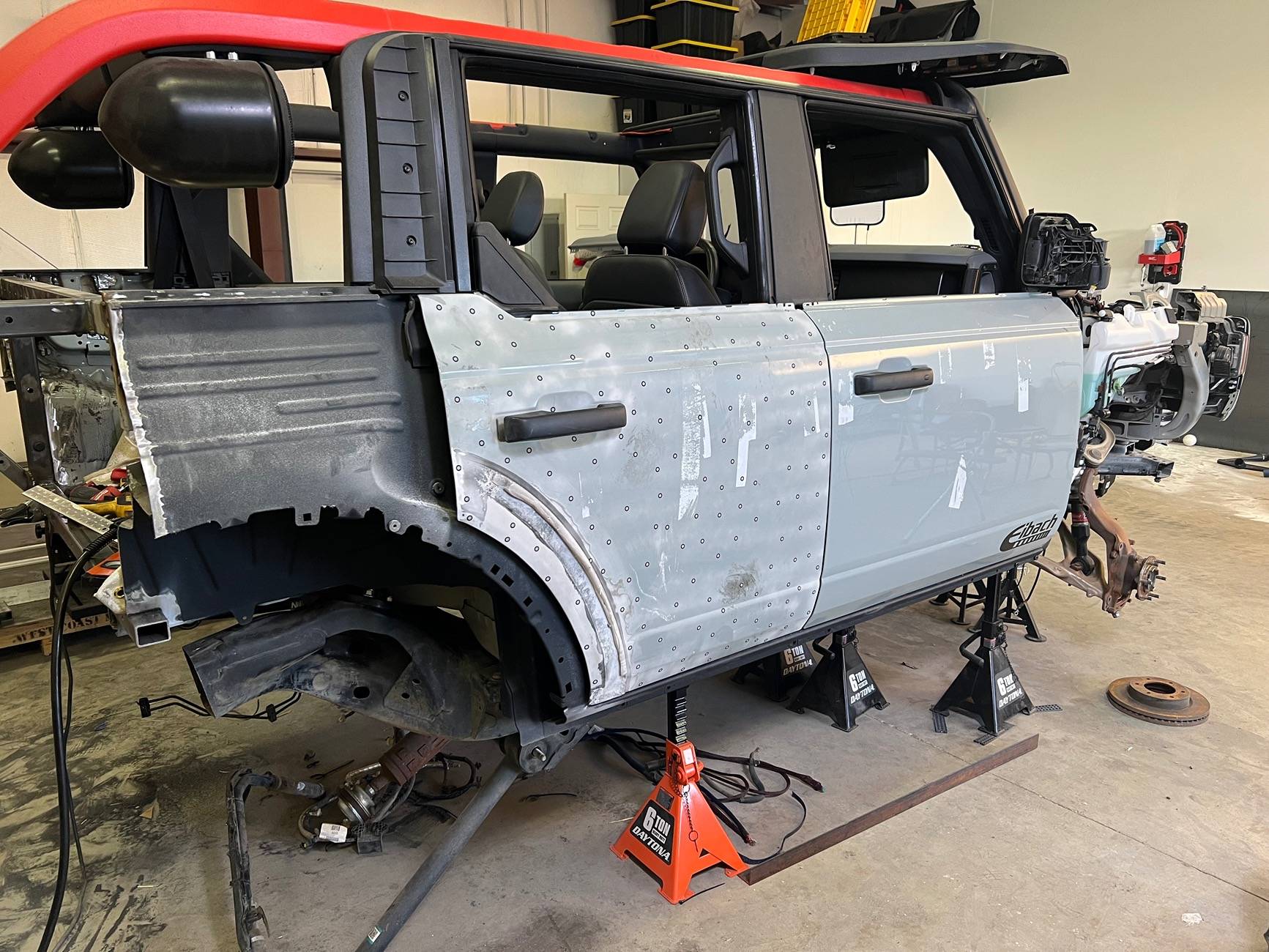

Been working on the body design so that I can get parts printing to make molds. I have several months of printing to complete so that I can make the custom body. The idea is to get parts designed and printed while I am working on the other pieces. Printing a single front fender will take about 6 days…. The rear more like 10 days. Hood probably another 15 days because it’s multiple pieces. You get the point, lots of time needed to print the parts. After I print them I have to finish them and pull a mold off them so that I can make the end use part.
The rear door I will have to make a new skin for it because I do not use the arched opening for the tire.
So just bringing you along for the process.
This is the door as I am scanning it for reverse engineering.
Ford Bronco Bronco Truck Build IMG_8553
From here I will take the mesh model and import it into a program that will allow me to make surfaces and export it to another program that I will use to model the final design. Rinse and repeat for most of the custom parts. I scanned both the front fender and rear door today while I was working on the project.

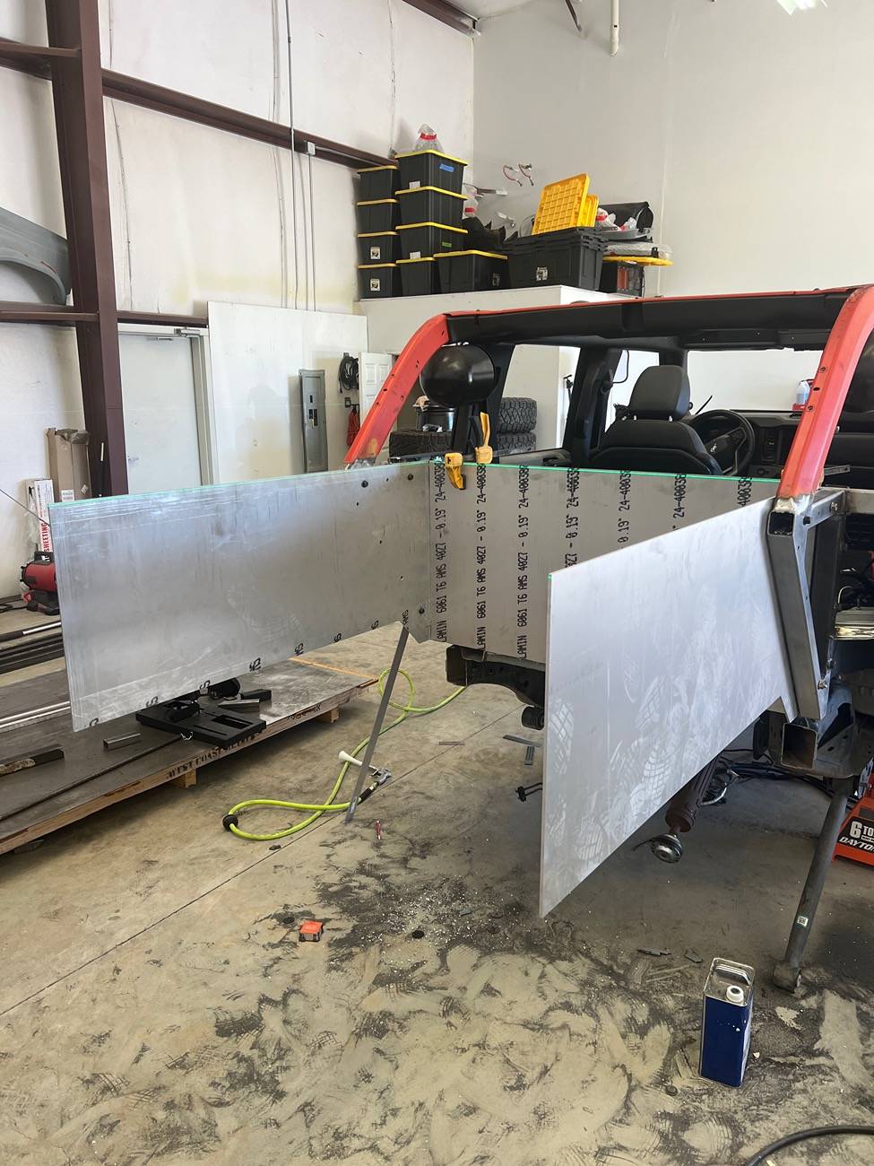

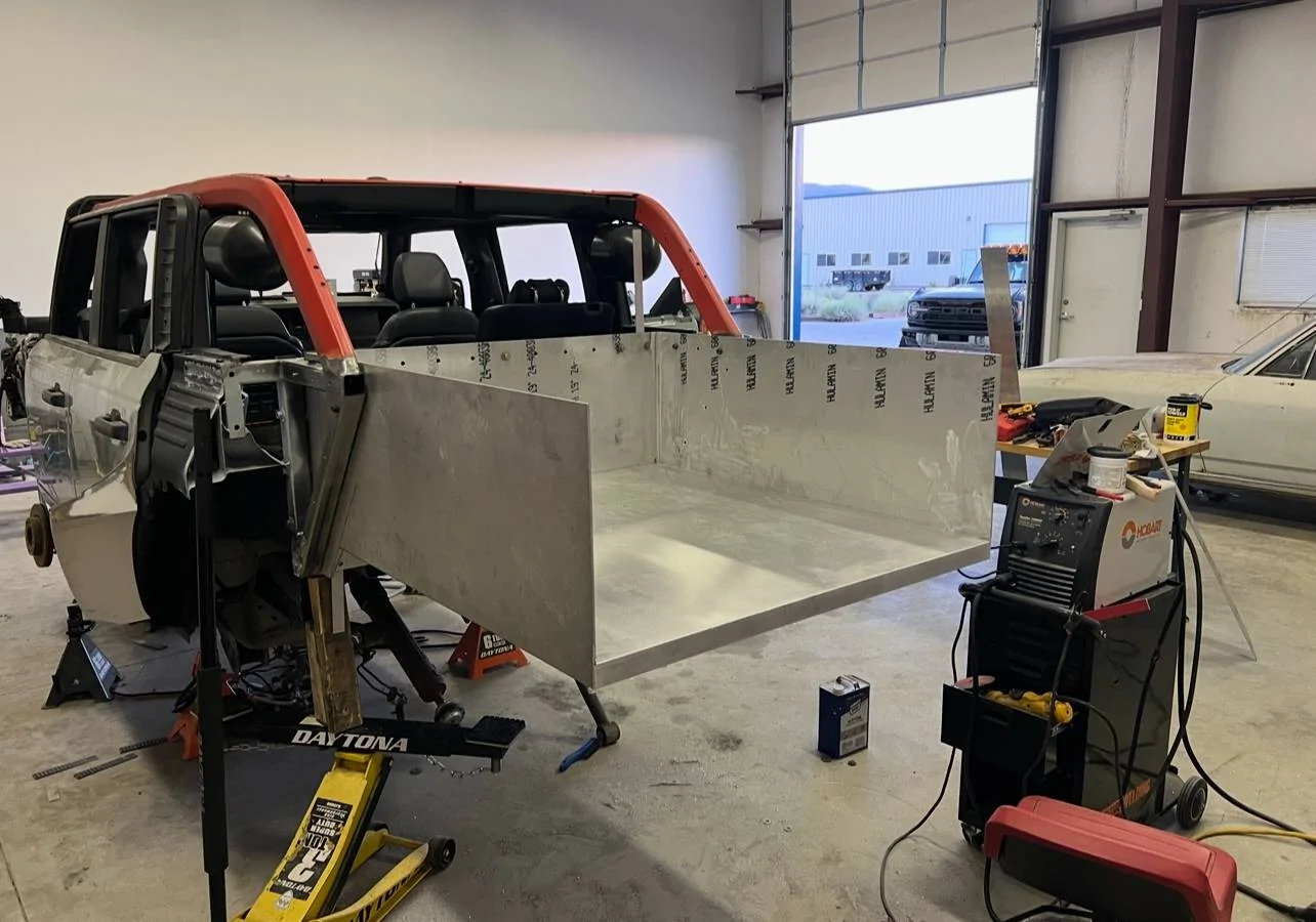

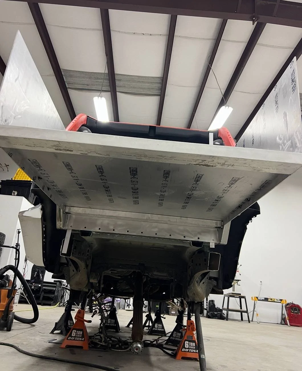

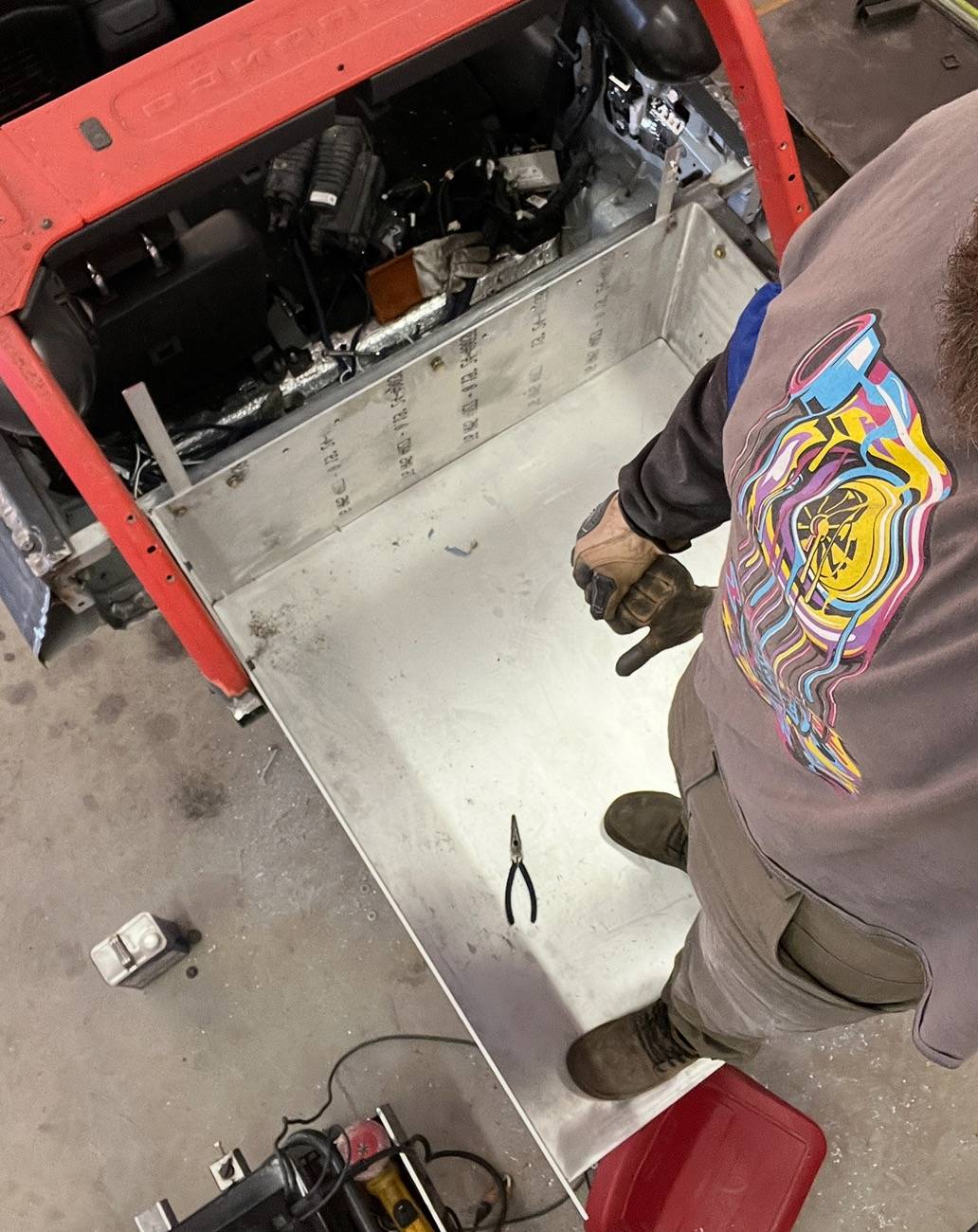

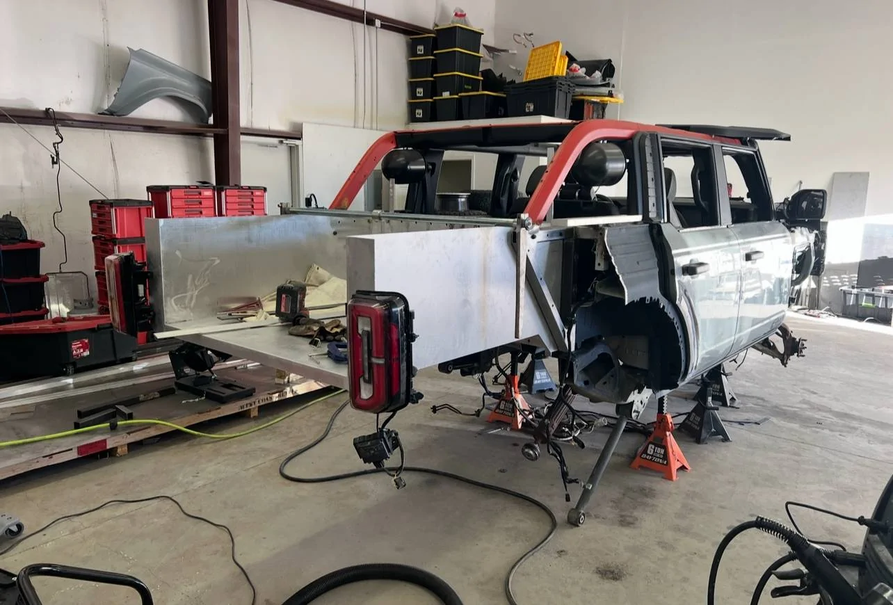

Here’s the process on the bed. Cut stuff, weld it, grind it down.
Going to get into the frame this Weekend 😎
Ford Bronco Bronco Truck Build IMG_8727
The bed is 3/16 6061 aluminum
Ford Bronco Bronco Truck Build IMG_8716

are you worried about the bed floor not being stamped for rigidity? Seems ripe for denting/bending once you actually start using it.
Honestly no, I’m 275# standing in the middle of it and it’s insanely strong. I am going to be doing Eva foam in it for a few reason. I’m not putting anything crazy back there, bikes, cooler, etc.

That’s funny. Honestly it’s so thick at 3/16, I’m already in the overkill zone. Yet the bed still come in around 100lb so it fit what I needed and didn’t add a bunch of weight.
