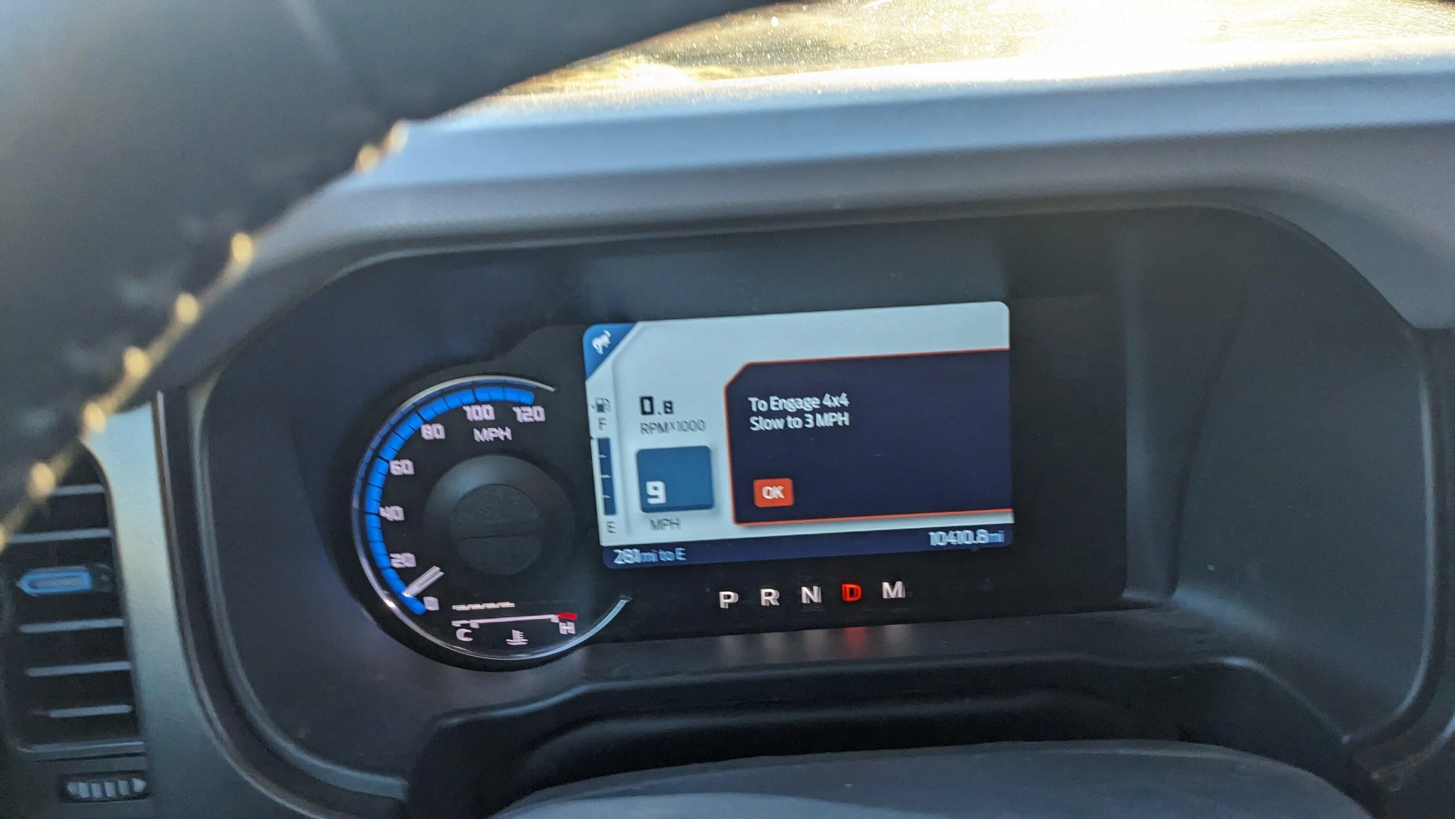

Well that's disappointing, I wonder if this is only a program issue for us part time 4wd transfer case people, they must have thought the transfer case can't handle that. Wonder if they also do it on BD with advanced 4x4 with the m190.
I have a BD with Advanced 4x4 and do not have to slow down to put into 4Hi.

I've engaged Baja mode at speed and don't recall ever getting that message. Is this from some new module update? I'm not sure I've ever tried switching to 4H in Normal mode.
I hate the you have to come to a complete stop for 4L. If I now have to do that for 4H I'm going to be extremely mildly annoyed.

This is brand new as of Pro Cal tune install. 4hi somehow is requiring 4lo activation speed to engage.
That's just crazy! I can see a change to maybe delay the programmed shifting in some cases, Like if your accelerating hard, But to require a complete stop just seem stupid...

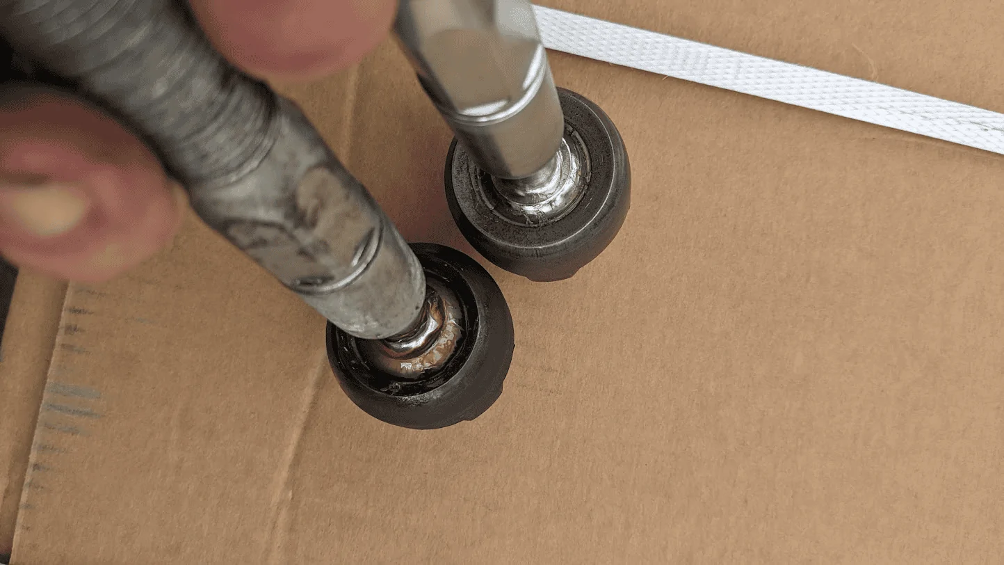

Talked with Ford Performance tech support and they are going to run it up the ladder. Tech support thinks something is a miss as far as wiring, like a wheel speed senor or the likes.
On to a better note, I saw 21psi of boost! Coupled with some air at Prairie City and we get the following picture. Notice the ball cup design is different! I will say I am impressed with the Icon taking a beating while being hurt, definitely a slow failure. I will say that having a slow failure was very acceptable and why I am still running the Icon tie rods. Now I damaged the tie rod winching out of Hells Gate as my steering wheel was off-center immediately after but didn't develope play in the steering for another 500 miles. Have probably a good 1000 miles on the tie rod post failure.
