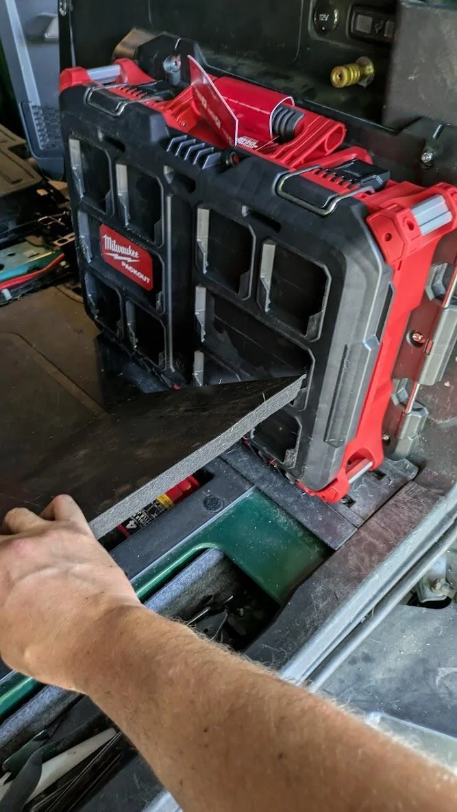

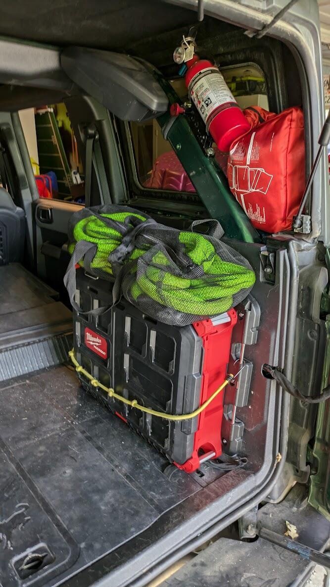

So working though a few things that needed to get fixed. My rear bags saddle bags lasted a year, so I am trying some Milwaukee Pack outs. Replaced my lower control arms which proved difficult to find something not gold plated. Stuck on some new upper control arms to help with steering. Had to install spacers for my ARB sliders that slowly moving into the doors.
Haven't been wheeling due to family stuff. Got a few more little things to mess with but pretty happy with the outcome. Got a week to go, then beer, fishing and beer.

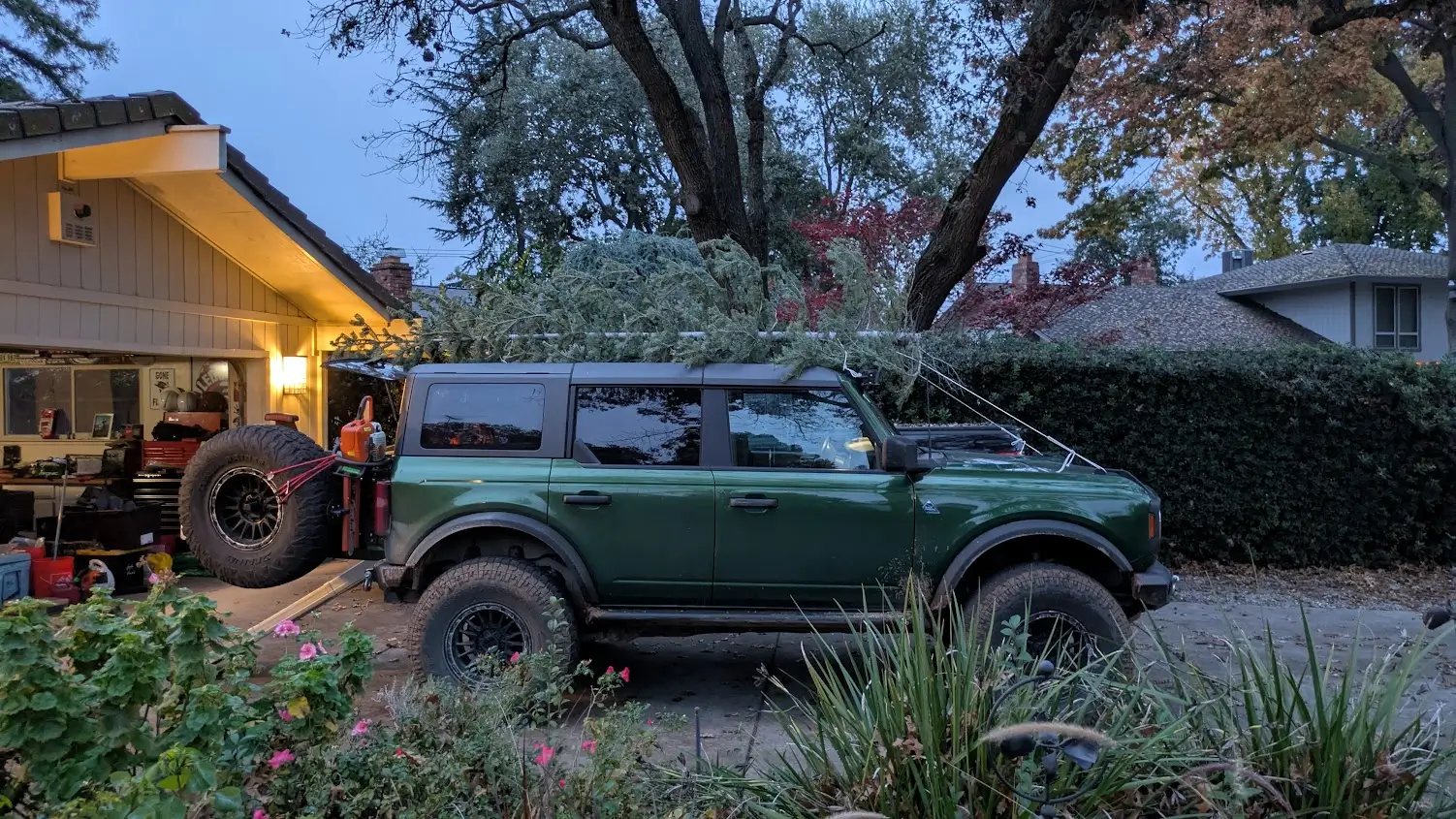

Where do you get your trees from? Mine are kindling by January 1st...
Prosser Hill OHV with a Tahoe Forrest permit for $10.

Looks like your limb risers tore the whole tree outta the ground.

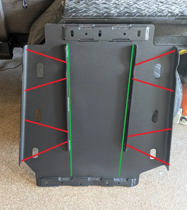

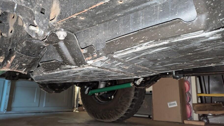

When your last oil change was a tad more difficult than you want to admit and out comes the credit card.
Thinking the red will be 1/4"x 1 1/2" flat bar and the green will just be some 3/8" thick what ever I find in the scrap bin.

Did you make this or buy it? where from?

I've done lots of re-enforcement like this on TJ and JKU Skids (My Wife is particularly good at bending stuff in her JKU).
Found the best thing to be 1/4" inch thick 2 inch Angle iron laid with the point up, then welded along both edges in about 4 inch stretches with a 2 inch gap between stretches...
I don't have an example in the shop right now or I'd take a picture for you...
