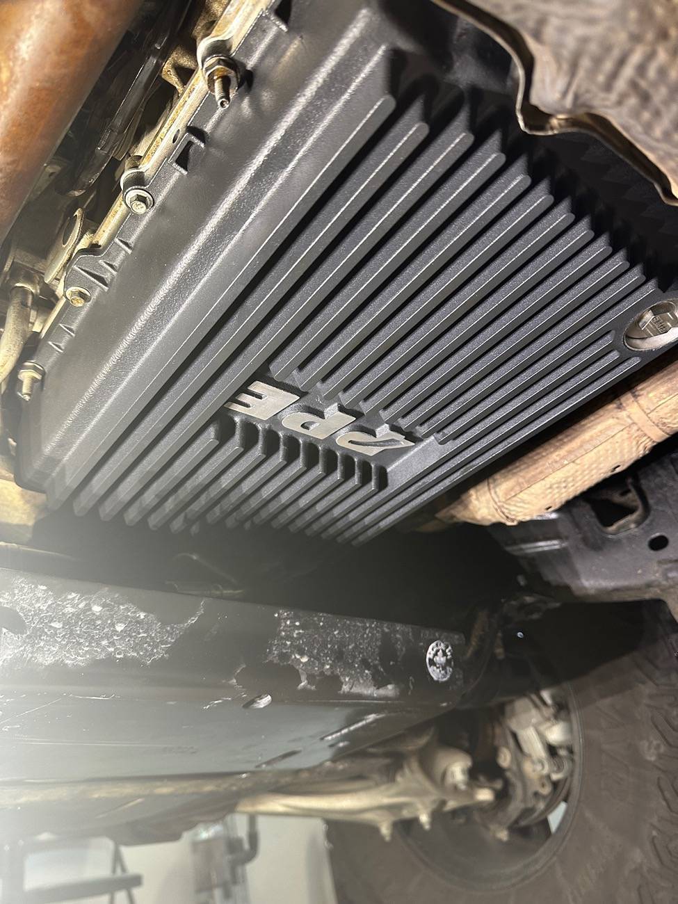

I am doing the deep/high capacity trans pan too. You’re saying you can’t use the stud bolts with the deep pan? If so, do you happen to have a part number for the pan bolts? I’m assuming it’ll look better too since all the bolts will be the same.
The rear studs hit the pan before the flange on my deep pan. Others have noted it not being an issue. On the Bronco, the studs serve no purpose and having the switch sockets and torque values during the torque sequence is a PITA (thanks Ford).
My pan leaked because the studs were not against the flange--I found it easier to simply replace the studs with bolts making everything uniform including the torque values.

Well...I would not want to put the weight of the transmission on the studs that are on a plastic pan. I get that is likely not the only attachment point, but still.
Which Bronco model has a heat shield attached to the studs? I seen it on the F-150, but my heat shield attaches via plastic Christmas tree fasteners to the side of the pan flange.
We support 10R140's the same way which are far heavier, it's perfectly fine. I'm pretty sure they wouldn't make the transmission adapter for it if it was an issue. It's literally just held up by the studs

F150, Navigator, Expedition, Aviator, Explorer, Mustang all have heatshields attached to the studs depending on year/engine. Some have it on one side, some have it on both sides, some have it on neither side. None of the Broncos do, but they're still there for the same reasons. All the 10 speeds get studs whether the shields are there or not.
In a way it makes sense...you can only "crush" the plastic so much before it cracks and I guess that amount of weight is not there.
