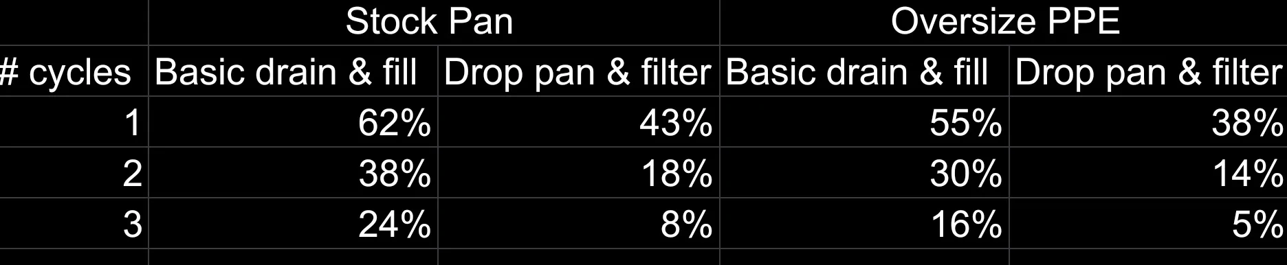

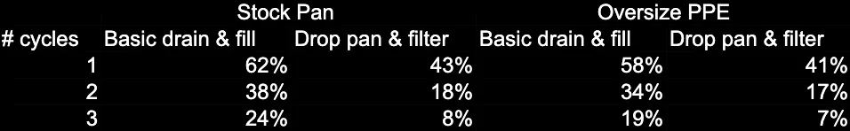

EDIT, THIS NEEDS TO BE CORRECTED. FOR COLUMN 3 I GOT 6 l or 6.25 quarts out for a basic drain and fill.
Thanks. This below should help us all, seems like maybe something @CarbonSteel has already shared here. This is the effective amount of USED fluid left in many scenarios. I assumed a 7.5 quart number for your estimate of 7-8.

Revised. Column 3 now using my actual data. Column 4 is still an estimate.
