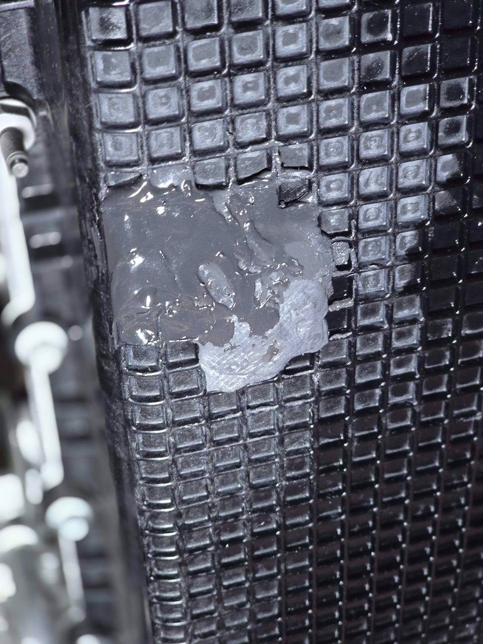

Hi everyone. My Bronco went over a baby toy stroller made of plastic. Well, it was stronger than my transmission oil pan, which is unprotected and made of plastic.
Any suggestion on a replacement and a skid plate to protect the bottom of my Bronco? Any help is appreciated. Another thing I forgot to ask about is whether the oil level is cold or hot. I found the dipstick on the driver-side side of the transmission but don't know how much oil to pump to start the warm-up process. I lost all the oil when the oil pan cracked.

Fluid level is checked hot and should be between the 3-4 on the dipstick when the fluid is up to 206-215 degrees. I would put in at least 6 quarts, start it, then add more as necessary. Cold, or after just starting it, the fluid level will be down near the bottom of the dipstick. As the fluid gets hot the level will rise.

I put the Mabett trans skid on mine first week home with it. I have the 2.3. Not sure if it fits with the 2.7 frame braces.

I have LOD skid (fits 2.7 braces)…if ya have 2.3 there are more choices… have not found a steel pan but the aluminum ones are stronger than plastic I’m guessing…don’t run over strollers…the mall is full of them…😜

Both Mishimoto and PPE make aluminum pans for the 10R60/10R80. I did a comparison here:
https://www.bronco6g.com/forum/threads/ppe-mishimoto-transmission-pan-comparison.86774/
I installed the full RCI aluminum skid plate system on mine to double down on protection since the engine oil pan on the 2.7L is also plastic.
I know this is an older post but been reading what I can. So with the PPE deep transmission pan there will be enough room to still put an aftermarket skid plate on for added protection?
