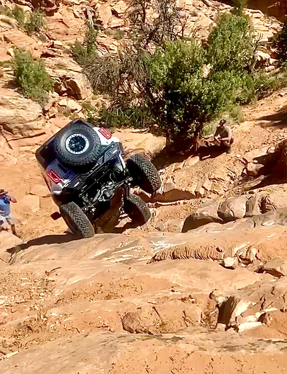

Center Of Gravity Realities-
When it comes to the center of gravity (COG) the portal manufacturers claim it’s a non-issue as you are increasing the width by the same height of lift. This isn’t exactly accurate. The nature of the axle-lift and the clearance provided lifts everything above the hub centerline. An axle lift compared to a conventional lift is a small, but meaningful difference. The next big change is of course, tires. And then, because you’re still limited on travel, aftermarket coilovers are added-all of which further lift the vehicle. The following is information put together by @87-Z28 . He provides a brief explanation, then provides numbers based on OEM data and some math to provide support to the information.
Stability Angle as a reference to COG, simply put - if track width stays the same and CG height increases, then stability angle increases. It gets steeper/easier to tip over. A very simple geometric metric. Dropping CG and keeping track width the same always decreases angle. Dropping CG is good for stability.
As the stability angle increases you get closer to the static tipping point, when angle is exactly 90 degrees.
Of course this is all only static and dynamic forces dominate, for example lateral G’s. But nonetheless, stability angle helps compare two different rigs. The lower the stability angle the greater rotation required to reach tipping point.

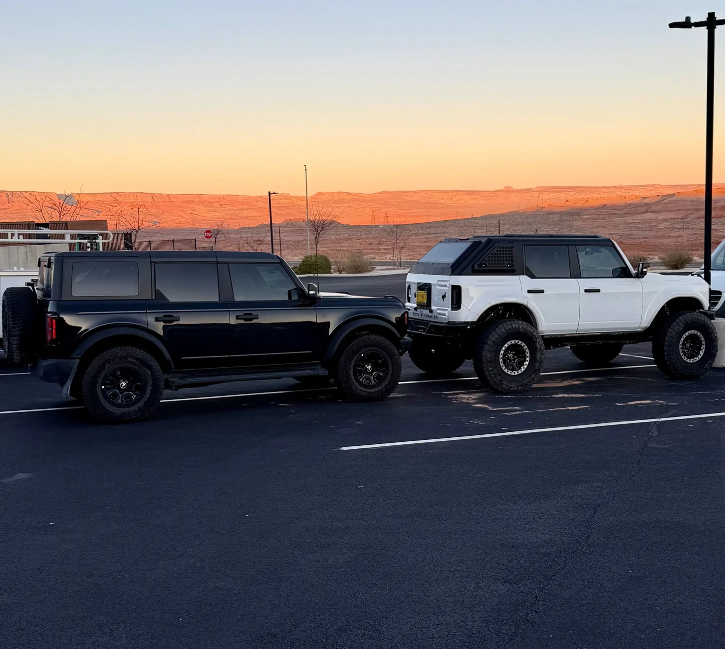

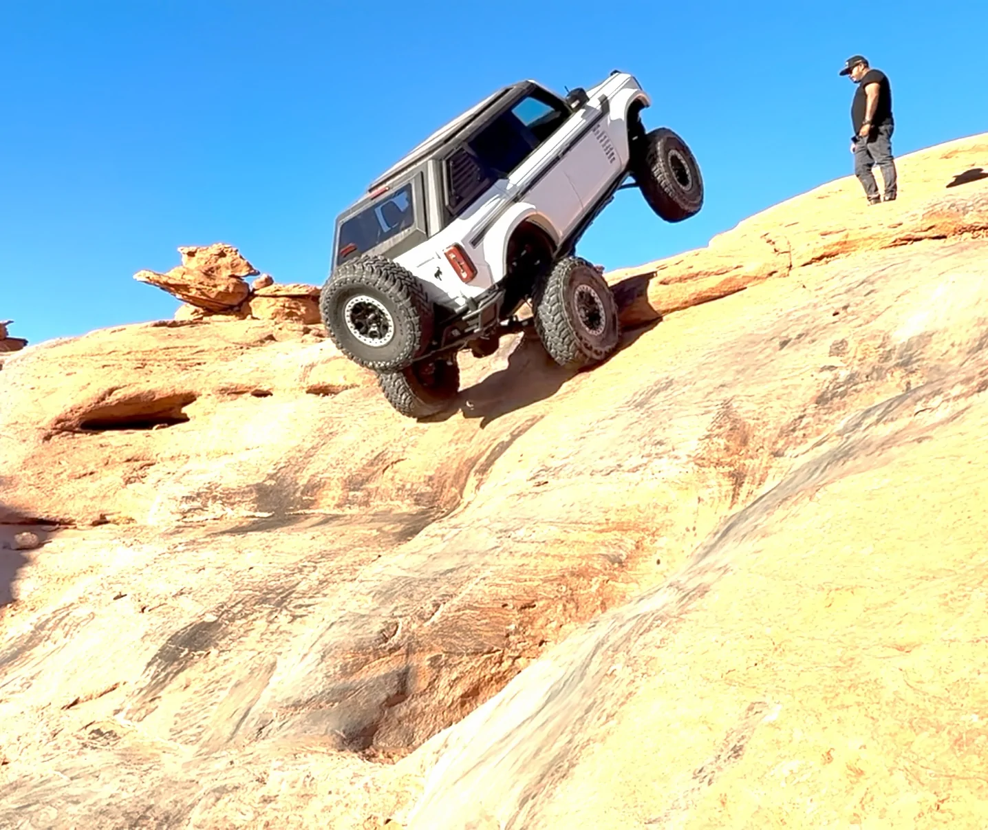

Sasquatch : distance from rear axle center line to CG is 13.5. So on 35s the CG= 13.5+17.5=31 and track width 66” so about 43 degrees.
OEM on 37s with 3” suspension lift, a common build. CG=13.5+18.5+3=35 and track width 33, so 47 degrees. About 4 degrees worse than SAS.
Aluminum portal Bronco on 40s with 2” suspension lift (coilovers). CG= 13.5+20+2+4=39.5 and track width goes to 74. So 47 degrees. 4 degrees worse than SAS. Steeper than SAS and less stable.
At first thought when comparing these numbers, it looks like the portals are the better option, but it’s important to keep in mind that the lifted OEM on 37’s is still using the stock width suspension. If you were to replace the arms and axles to get a width similar to that of portals, not only will the stability angle be improved, but you’ll have significantly more travel. And less clearance, of course.
Keep in mind, these numbers only reflect a basic lift, and do not account for additional changes that would reflect an axle lift.

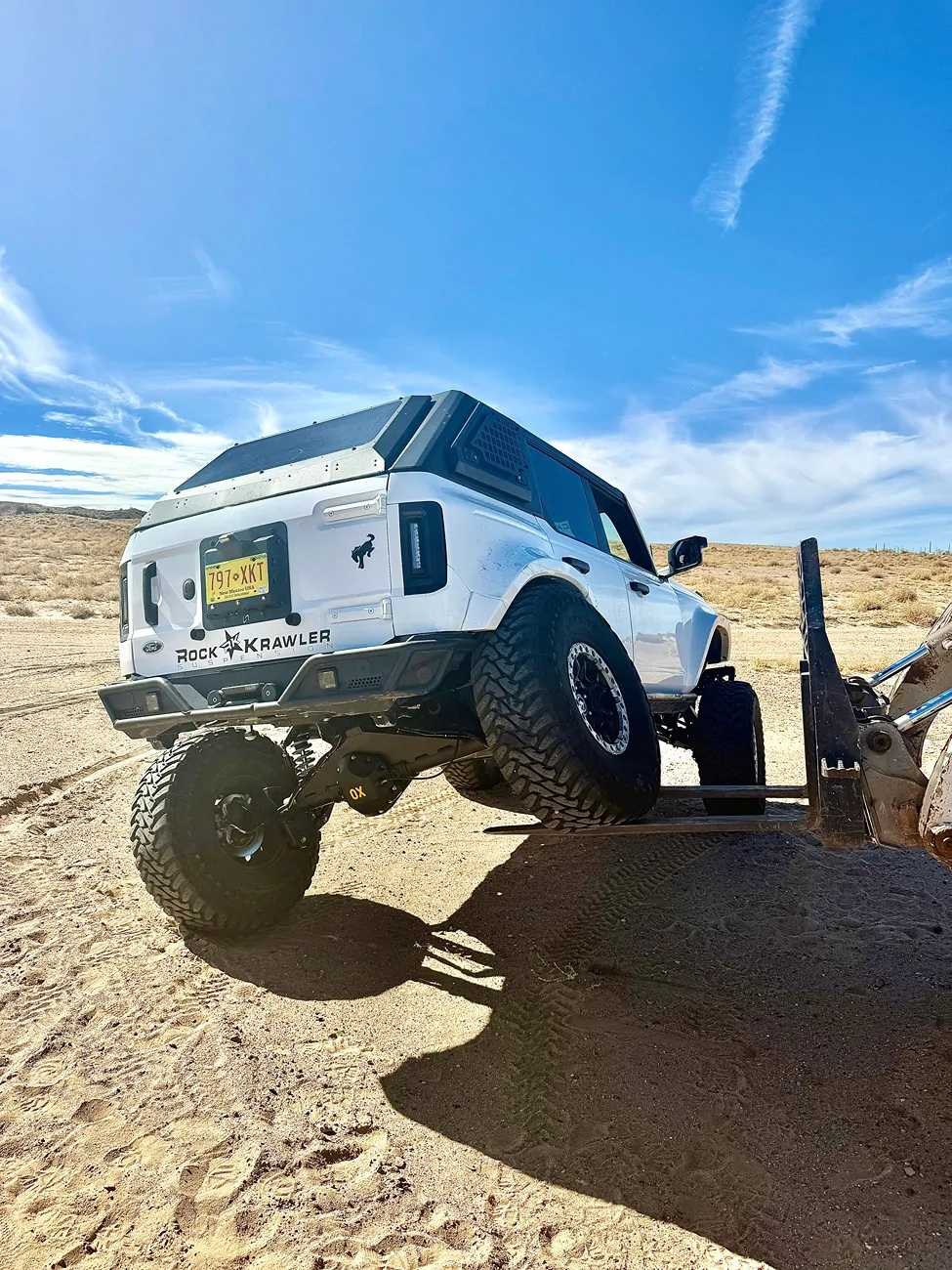

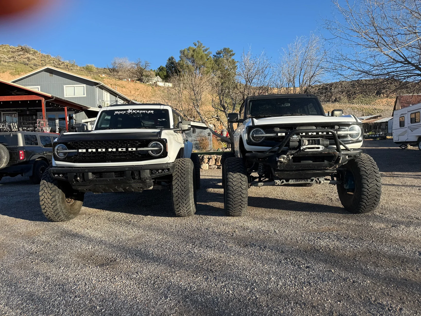

Ours on the left, with 5.5” of portal lift. On the right, 4” of portal lift with a Belltech diff drop. Both rigs running the same 8” Rock Krawler coilovers up front.
On the first version of our portal build, with coilovers set properly (roughly mid-stroke as the normal ride height) right away we noticed the COG increase with the portals while on the shakedown run. We reduced the preload to lower the ride height, but then we were bottoming out the coilovers on the smallest of bumps. This started our plans to lower the ride height via taller shock towers. And if we were doing that, we might as well run longer coilovers as well and maximize the available travel. The OEM towers were cut off and we built our own units that are 3.75” taller, allowing the use of 8” coilovers while also reducing ride height by two inches. Lowering the rig was no small feat, and most people are not terribly interested in cutting apart the structure of their new car. But it made a significant difference in stability and was a very welcome change when running portals. The change up front also required the rear suspension to be modified. That said, more needed addressed on the back than simply lowering the ride height. That brings us to the next topic-axle wrap aka the portal bounce.

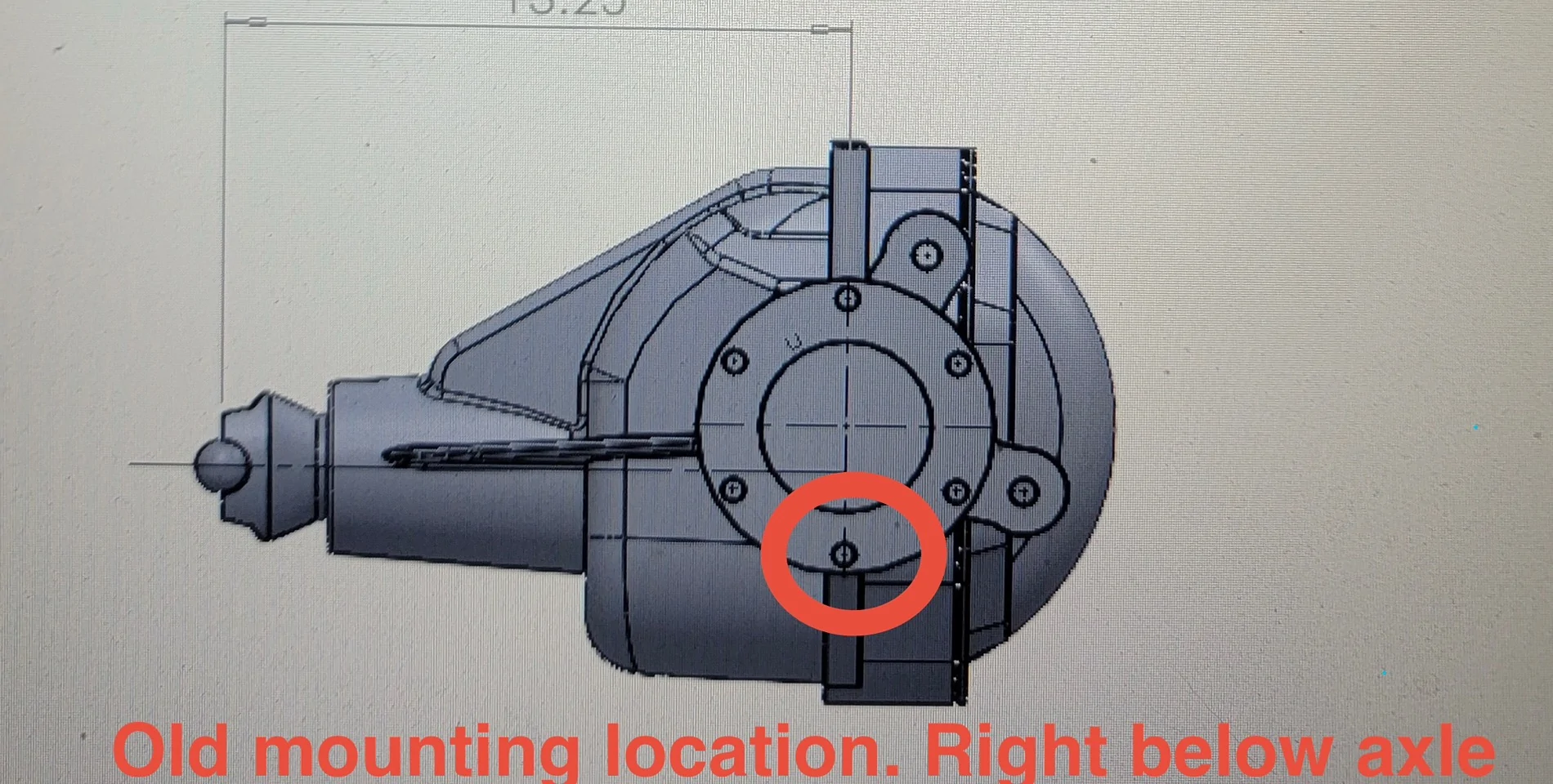

Enter modern suspension with upper/lower links that help control rotation and keep the axle in place. The lower link is typically below the axle and the uppers are above it. Throttle is applied and the axle still has a need to rotate, but that rotation is much more controlled. The bushings within the link ends, like most OEM designs, are set up to find the optimum balance between comfort, longevity, and deflection. As such, they are on the softer side and it’s possible to get 1-2 degrees of rotation in the axle due to the 1/16”-1/8” deflection in the bushings. Then we add portals. We have now moved the output under the lower links, gave it a lever, and multiplied the torque with the gear reduction. (Bigger tires also increase leverage) Basically a very expensive lift block with many more failure points. The OEM suspension isn’t set up for these forces and any small amount of axle rotation is exaggerated by whatever length of lever you have-aka your portal lift. If you have a 4” lever attached to a 3” circle (5.5” lever overall) that 1/8” of rotation at the axle comes out to the portal itself rotating forward almost a half inch. It’s not as extreme as the 2-4” you might realistically see with a leaf spring suspension, but it does indeed make a difference, and as a result-portal rigs utilizing OEM suspension mounting locations bounce more.

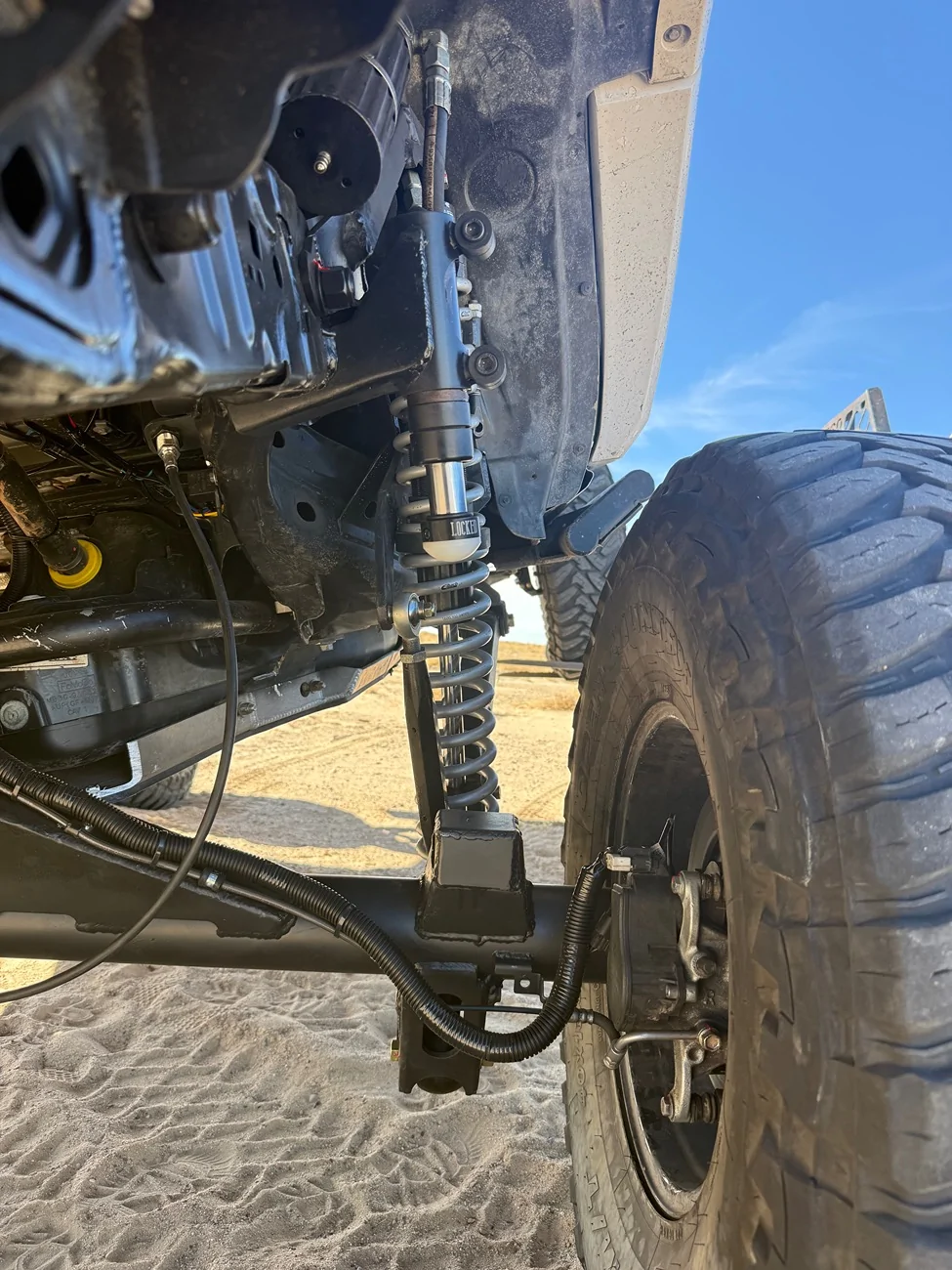

To address the axle wrap in our portal build, we went the “traction bar” route by getting trailing arms that mounted UNDER the output of the portal. We also went higher above the diff for our upper mounts. The goal being an increase in link separation to gain more control over the axle rotation. Deflection was also decreased by sacrificing ride comfort by using heim joints at the axle. Polyurethane anti-wobbles are still used at the frame. In the limited testing we did with another 4-Door bronco on the same portals and smaller 38” tires (less leverage) our changes made a very noticeable difference when it came to the portal-equipped rear axle induced bounce. Of course, in lowering the lower link attachment point, we lost clearance at the trailing arms, but it was an acceptable tradeoff. We also adjusted the arm mounting location and moved it outside the frame, putting the arm next to the tire to help reduce how often it was getting snagged. (There are other benefits to this as well) We did the front shock tower modification and rear suspension changes at the same time, lowering the ride height to improve COG while also bottoming out less, and we were quite pleased with the results. Other portal owners seeing the changes in action were impressed as well.
Effects of the portal on a trailing live axle

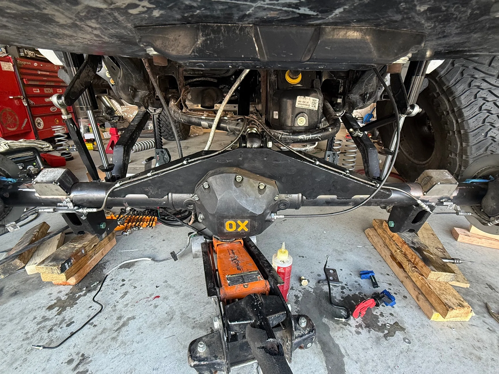

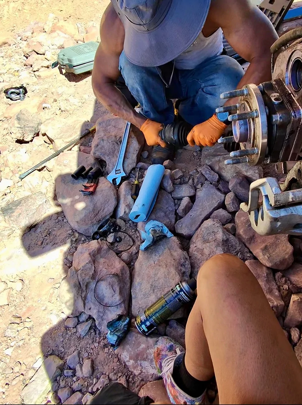

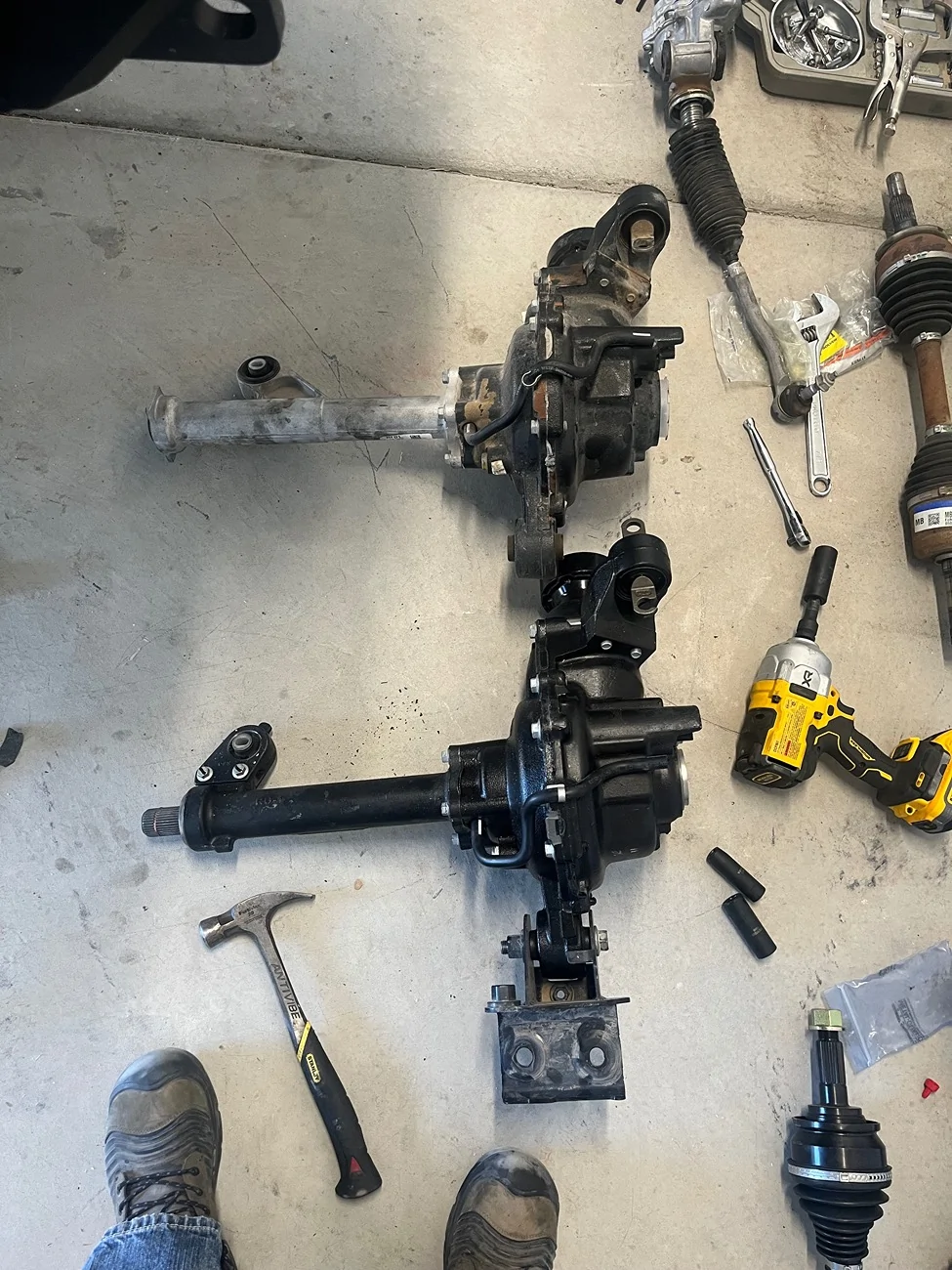

Continuing the build with a rear portal delete-On one of our trips to the Rubicon last year, we snapped a rear axle shaft. Okay, no big deal. Axle shafts break. Pull the sucker out, cut it off after the tone ring, and let’s go, right? There was a Jeep out with us that also had a broken axle, and this was very much the case with them. On portals? Well…maybe not so much.
Perhaps always having lockers we never really noticed it, but with an unpowered rear corner and portals (the portal itself wasn’t damaged. It spun freely) it seemed that whenever you had a ledge to climb while going uphill the dead corner would act like an anchor. Certainly the problem is exacerbated going uphill due to the weight transfer and the other side spinning when using the locker, effectively giving you a trail turn assist dialed up to eleven. But even being pulled or winched, the portals on the solid rear axle and OEM suspension link placement seemed to resist moving forward and would instead start trying to twist the axle, even with the tire aired up to street pressure. Initially I thought our suspension setup might have exaggerated this problem, as it was semi triangulated upper links with parallel lowers and a panhard delete, but it does seem to be an issue with conventional five links as well. The way the portal acts as a moment arm seems to have a deleterious effect on a suspension not designed for those forces. I’ve made offers to other portal owners to borrow the stub that plugs into the portal to seal it, then go wheeling to confirm that this is not an isolated incident. Seems that the idea of pulling the portal, removing the axle, placing the plug, then taking it out to wheel with a certain loss of performance isn’t how most people want to spend their day wheeling, and no one has accepted the offer. There are videos on the internet showing this same issue on other portal-equipped rigs, so there does seem to be some legitimacy to the issue not being an isolated event.

With all things considered, we started looking into running mixed ratios and deleting the rear portals. With portals up front on an IFS rig the issue associated with a broken/unpowered axle isn’t the same, and it seems to be due to being pushed up and over opstacles, as well as the directional of travel being transverse or “perpendicular” to the direction of travel as opposed to longitudinal, or “parallel” travel of the trailing solid axle. @Ducati1098 and @BigMeatsBronco were contacted to see if there were any output sensors on the transfer case to worry about, and it seemed all is well. Only need to be concerned with the wheel speed sensors. From there came finding gearing combinations that would work. We created a spreadsheet to easily spit out rear R&P ratios needed for all the available front differential options and different portal reductions. The 32 spline ultimate D44 FDU is compatible with any D44 combination that uses Advantek gears. As for the rear axle, searches were done on ratios for Dana 60, Ford 9”, and GM 14 bolt. F9 and G14 were of particular interest for the triple sheared pinion, knowing that the gear ratio would likely be very short. Unfortunately, locker options were limited and we weren’t terribly interested in ARB due to the pneumatic system. Ford 9” had many gear ratio selections, but everything seemed to always be race gears and not suitable for daily driving. Ultimately we settled on a Dana60 equipped with an Ox Locker with a gear ratio of 6.17:1. The front was regeared to 4.56 and with Werewolf portals 1.35 reduction, the final ratio up front comes out to 6.156:1.
In researching this project, we learned a lot about the history of mis-matched gears front to rear. It’s very common in tractors with their tire size differences, but it was even a normal practice by automobile OEM’s, some running a combination of 4.09 front and 4.10 rear. It’s important that between the two the front is driving harder, as it’s easier to drag the rear wheels slightly to avoid bind vs the rears pushing the heavily weighted front. That’s when drivetrain bind occurs and parts start breaking. Some manufacturers have gone as far as 1.5% between front and rear, and it sounds like the Ford computer won’t freak out below 2%. So we should be plenty fine with our very small difference.
Live axle mounting practices
With bolt-on rear portals, the boxes are using the factory mounts on the flange meant to bolt the semi-floating axles in to the housing. These small bolts and the tapped internal threads in the portal box the bolts or studs are threaded in to are now being subjected to massive amounts of stress from the leverage of the portals. On the more careless side of the manufacturing options, threads were simply cut in to the aluminum, short cutting generally accepted safe thread engagement practices in what seems to be an effort to reduce overall packaging width. Those portals were quick to show this design flaw when used with bolts accommodating Japanese platforms and started failing. The portal manufacturer increased the bolt size and fixed the old portals. As for the bronco platform specifically, the long term life of these threads would be safe to question, as the decision was made to use 1.5xdiameter for thread engagement, the very minimum of what’s considered acceptable thread engagement with no safety factor in aluminum threads. A safe opinion could be that while 1.5x might suffice for lighter static loads in high-strength aluminum like 7075, blind threads in a portal box could be severe duty use given the combination of high torque from large tires and gear reduction, shock loading from aggressive offroading, vibration-induced fatigue, and potential mixed-mode stresses (tension, shear, and bending) and demands a more conservative approach. Engineering references consistently recommend 2.0–2.5x diameter (1.0–1.25 inches) for aluminum threads in high-vibration environments to ensure reliability and safety, though it could be argued that the use of four bolts reduces the need for even 1.5x thread engagement. Given the importance of these bolts and referring back to the conditions they’re being subjected to, some might say it’s better to be safe than sorry. Not to focus in on one portal makers choices, there are various other ways the mounting is being addressed by the other manufacturers in the space. Steel inserts embedded into the portal housing, steel flanges that increase bolt count in the aluminum, and steel portal boxes with supplemental braces. It does seem prudent to try increasing the strength of this critical mounting surface and will be interesting to see how these designs hold up over time. And while some designs could be interpreted as better than others, that still doesn’t address the next topic associated with bolting portals on to an OEM solid axle.

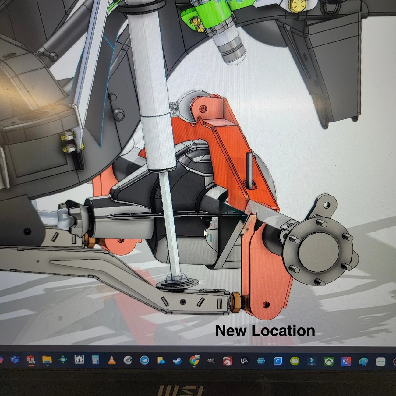

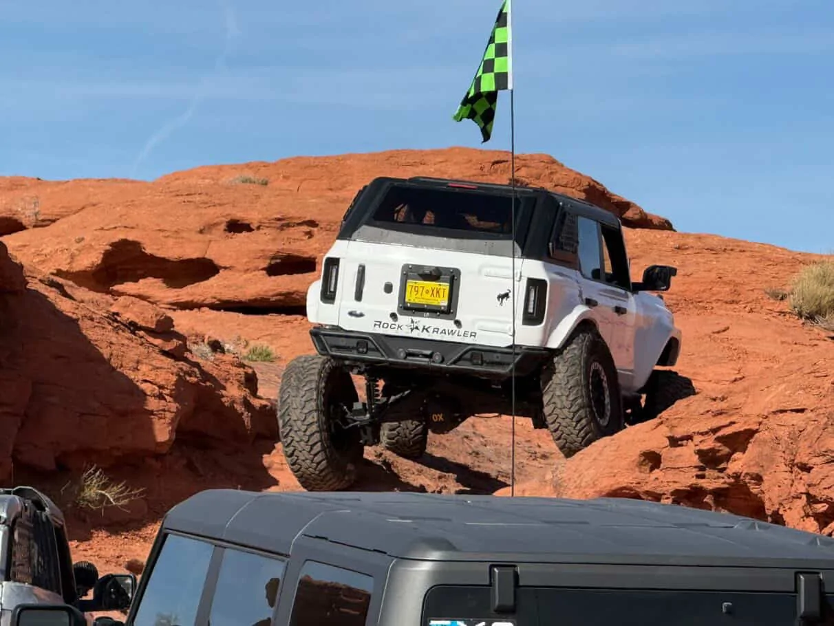

The first obvious negative that we’re looking at is the loss in clearance. We had already reduced the clearance by dropping the lower link location, and now we’ll be dropping it again by another four inches. As well as the differential. Is this something I’m terribly worried about? Not particularly. A counterpoint could be made that with the portals moving the wheel down in relation to the output, you now have to mount the brake calipers on the bottom of the rotor. All that clearance you gained with the portals is now effectively cancelled. One could even argue that it is less clearance. You definitely need to be mindful of your brake calipers and portal users have indeed hit and broken their rear park brake actuators or hoses. This is no longer as much of a concern with the brake calipers being back in their OEM placement on top of the rotor.
On the flip side of the clearance issue, this setup is making up that four inch axle lift difference with longer coilovers. Something that is not focused on enough is that portal lift is not “active“ as far as suspension is concerned. It is an incompressible lift and that 4-5 inches needs to be accounted for somewhere within the system. With the 12” coilovers and relatively low ride height, bottoming out was still a concern. “Pushing” the axle down is similar to what we did up front by pushing the shock towers up. With the 14” coilovers in place, we now have 6” of shock up travel, or 8” of up travel at the wheel, with 9.25” of clearance from the tire to fender. We set the hydraulic bump stops appropriately to ensure we don’t tear the fenders off when articulating but we’re very happy with how that turned out. More articulation can open up your line options if clearance is an issue, though it’s certainly not always a possibility.

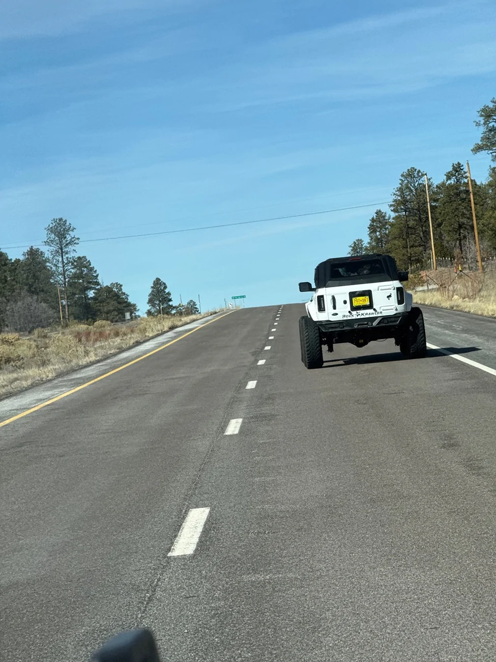

The short rear gearing will be more susceptible to heat, especially on long climbs at highway speeds. That said, so far in 1300 miles of use on the 6.17 gears we haven’t seen temperatures above 151F. We’ll still be changing the oil frequently, so having a drain in the diff cover will be quite useful assuming we don’t need to frequently pull the cover due to broken gears.

Before testing it on the road, we put the rig on jack stands then applied a strip of masking tape to the tires. In 4L we put the transmission in drive and let the tires rotate freely, using the tape to count rotations and compare distance traveled. Just to be safe. At one point while putting everything together I had a moment of panic when thinking that I was trusting these vendors to provide the correct gearing as ordered. I didn’t check any tooth counts myself personally. What if the portals were actually 1.3 instead of 1.35?!? Or the front diff was 4.10 not 4.56?!? This test put my mind at ease and everything looked good.
First item of note-the ABS system. The portals use the input gear for the wheel speed sensors. This prevents the need to accommodate any kind of tone rings in the rear portals, and the factory tone rings on the axle can be used. As it relates to a front-portal-only build, now the computer sees very different speeds, despite the tires turning at the same speed. Hopefully custom tone rings on the rear axle will fix the difference. We used Forscan to monitor the wheel speed sensors and it showed us to be off by an average of 35%. Makes sense given 6.17/4.56=1.35. But we wanted to be certain before getting custom rings made. Besides the ABS not working due to the discrepancy, it drove just fine and could cruise at 89 mph.

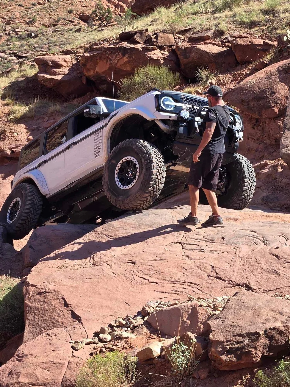

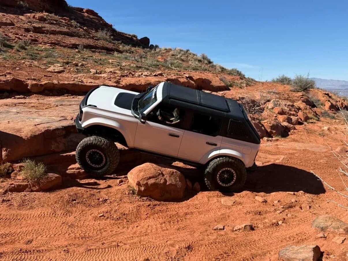

As to the offroad ability, from the perspective of the spotter absolutely this setup worked very well. All the additional flex made obstacles previously attempted possible or easier, and the reduced axle wrap was noticeable. We did get hung up on the diff on one obstacle and opted for a winch rather than velocity to get through it. Wifey said that this is definitely her favorite build of what we’ve done so far. It felt very planted and more predictable, but she’s looking forward to comparing it against a long travel rig. More on that in the near future.
