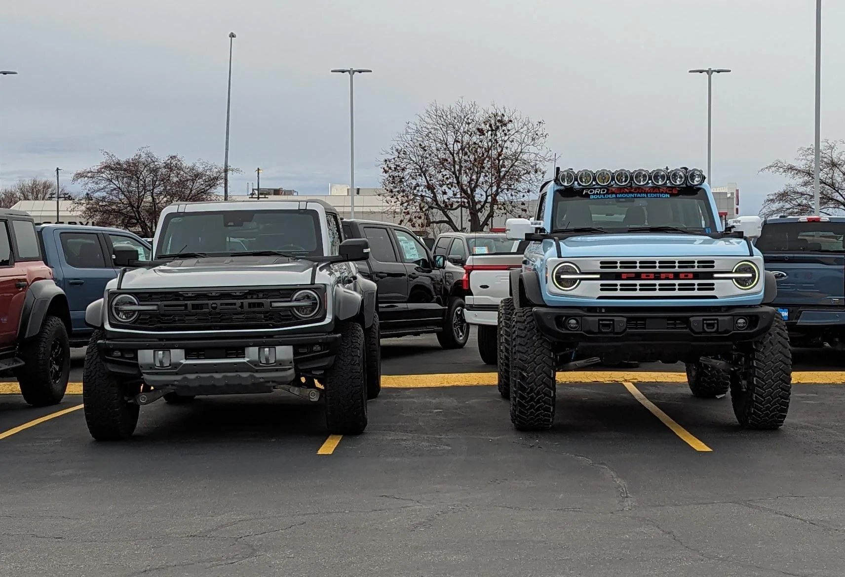

4" from portals and 2" from coil overs and running on 40s...
this is next to a raptor on 37s.
I think it is plenty... and to be honest I would not want to go any higher.... I am okay off camber but keep going up and I would start having issues.
