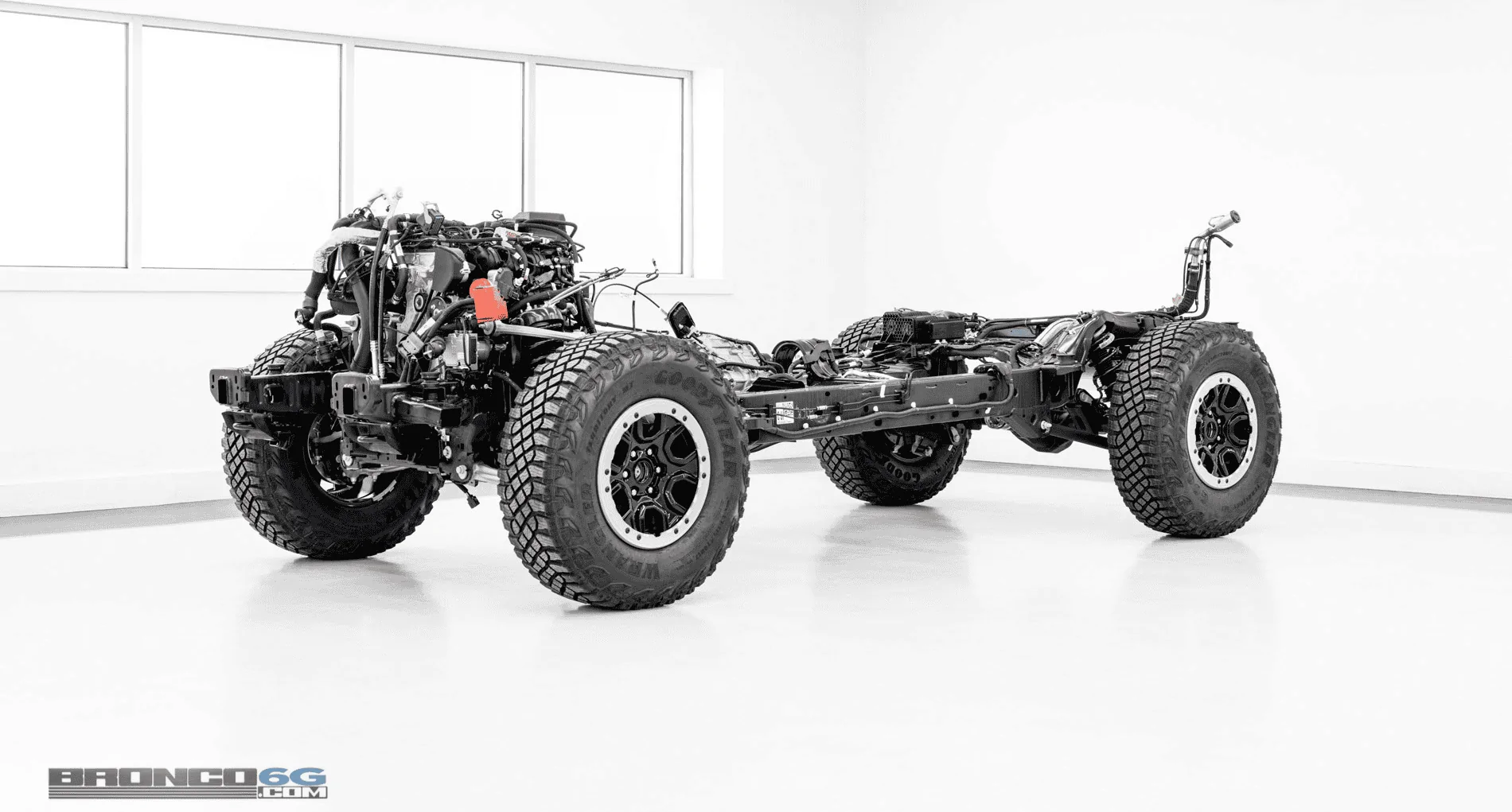

This will only reinforce the roll bar, not stiffen the chassis. The Bronc is body on frame, not a uni-body. The only way to stiffen the chassis is to put something on the chassis. doing things to the body does nothing for the chassis. A uni-body vehicle is a different story. A body mod will stiffen the chassis.
Examples:
Strut tower brace for a Bronco ( I hate the term strut tower but that is what Steeda calls it).
It goes from one side to the other of the top coilover seat on the frame.

In theory you can drive a Bronco with no body. The chassis is the chassis, independant of the body. In my above example you will notice that Steeda has put the brace on the coilover top mount, ON THE CHASSIS, NOT the body. This will help. Now if you were to, or if Ford did, put the roll bar onto the chassis THEN you would benefit because the roll bar is mounted to the chassis. As of right now the roll bar is part of the body not the chassis. Therefore it has rubber body mounts and doing anything to the roll bar without it being on the chassis will gain very minimal results. IMO.

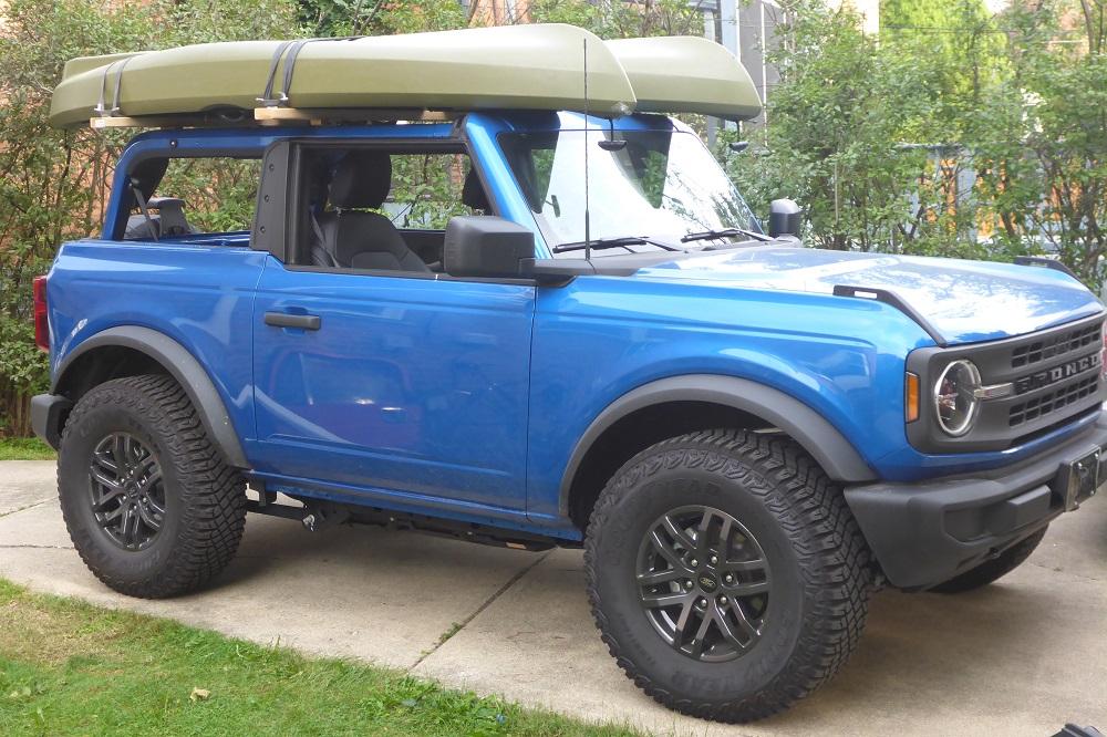

Any issues encountered installing nutserts in the rollbar, other than the difficult drilling? I'd like more connection points on the rollbar, will probably use a cobalt drill bit.
I've already installed this quick and dirty 2x4 kayak carrier on the rollbar, using existing nutserts (photo below). But would rather have attachment points in better locations on the rollbar for fastening various items. In this case, I would have moved the front 2x4 further forward, if there were nutserts closer to the windshield.
I have not installed any riv-nuts or nutserts at this time.... but easily could have. I drilled for wiring purposes. Holes will compromise structural integrity so you want to be careful and well thought through before adding very many.
What you have done looks like a nice quick solution. Well done. And by the way, great looking Bronco!
