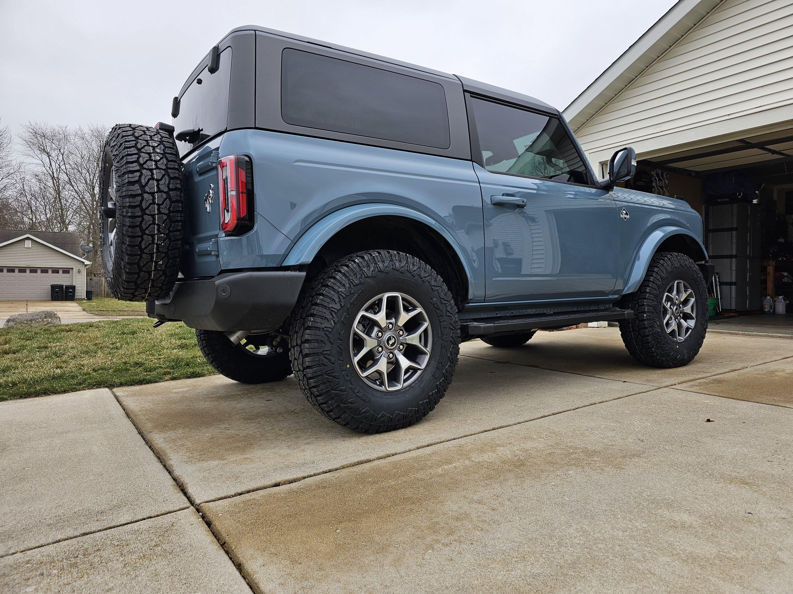

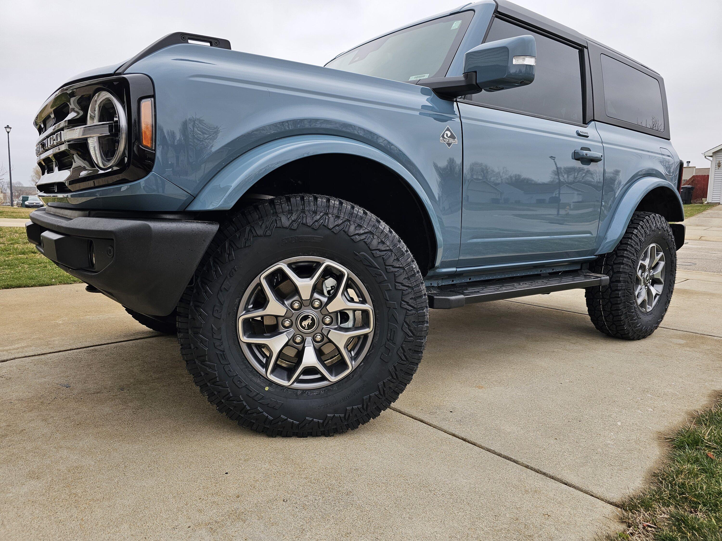

I had the Ford Performance 2" lift put on mine last week and the 35's on this week. Pretty pleased with it! Still waiting for a local shop to build the 2 door version of their sliders for me so I can ditch the factory side steps.

The fitment is on yours is exactly what I want. Those are 35x12.5? And any rubbing?
They are 35x11.5. We did remove rear crash bars to eliminate slight rub when turning sharp.
35x11.5 not spacers and no rub? Very interesting !
I’m looking for tires options to install on BL wheels as I quite like them after FP lift.
