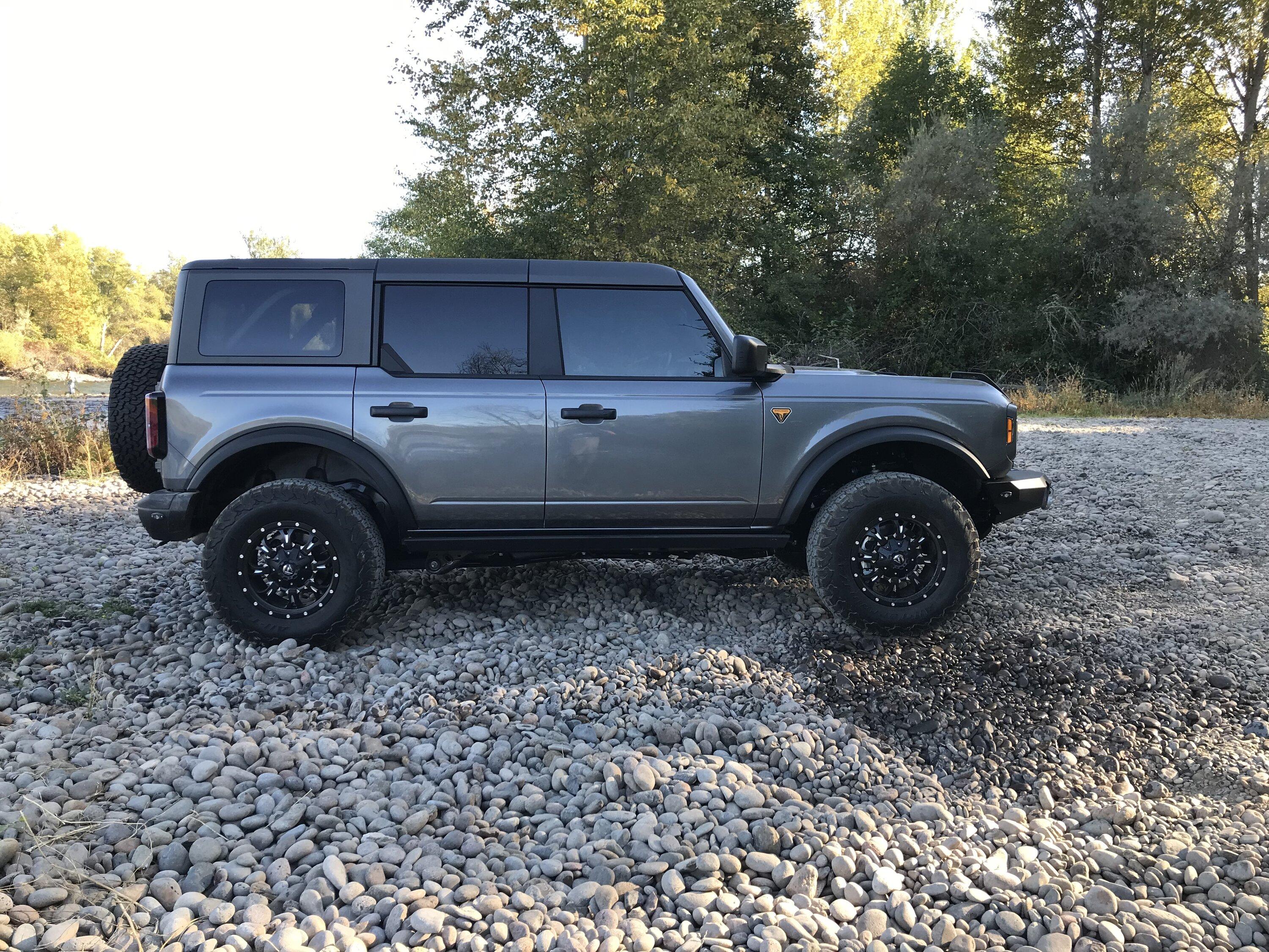

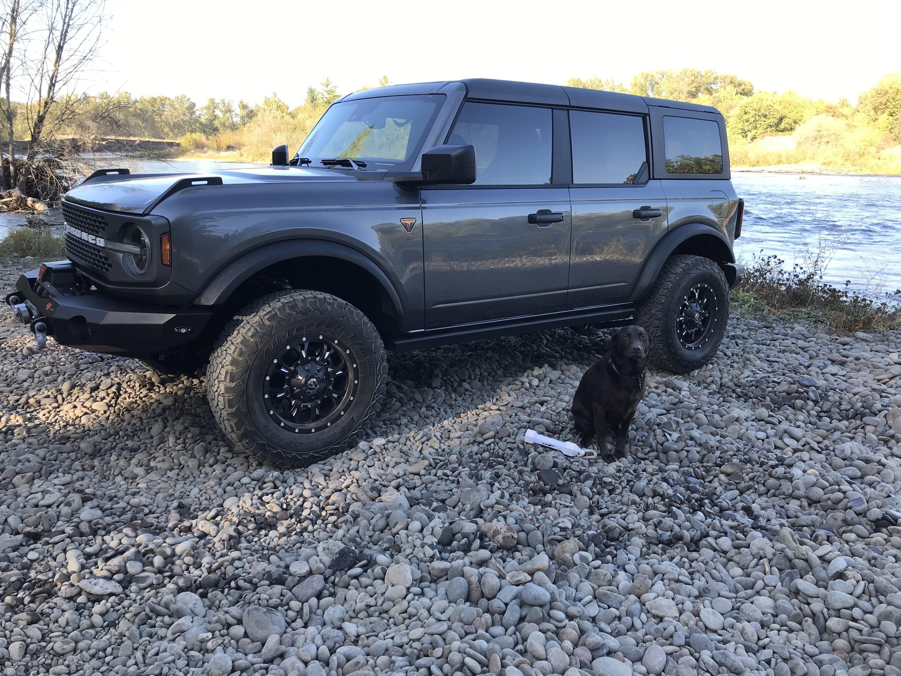

On the front I'm sitting at 2.5" lift over SAS, I had to back the preload all the way off to get it down to there! Yeah, I think 650lbs is too much to let the suspension flex, the stock SAS front rate is 374lbs. 550 should drop the front a little bit and soften up the ride, right now it feels like I could full send a jump or run the Baja, 650 is probably perfect for that type of stuff.
I would have to agree with you for sure. My hasty measurement after install in my garage was almost 2 over badlands stock. Like, you I have NO preload in front as well with that measurement. I definitely am a novice in suspension tuning and will defer to all the much more technical gurus around here about where to measure for flex, travel and all the nitty gritty, but I would think that a 550 spring should help bring down that front height. 650s a bit stiff in front but man they EAT those whoops ha!

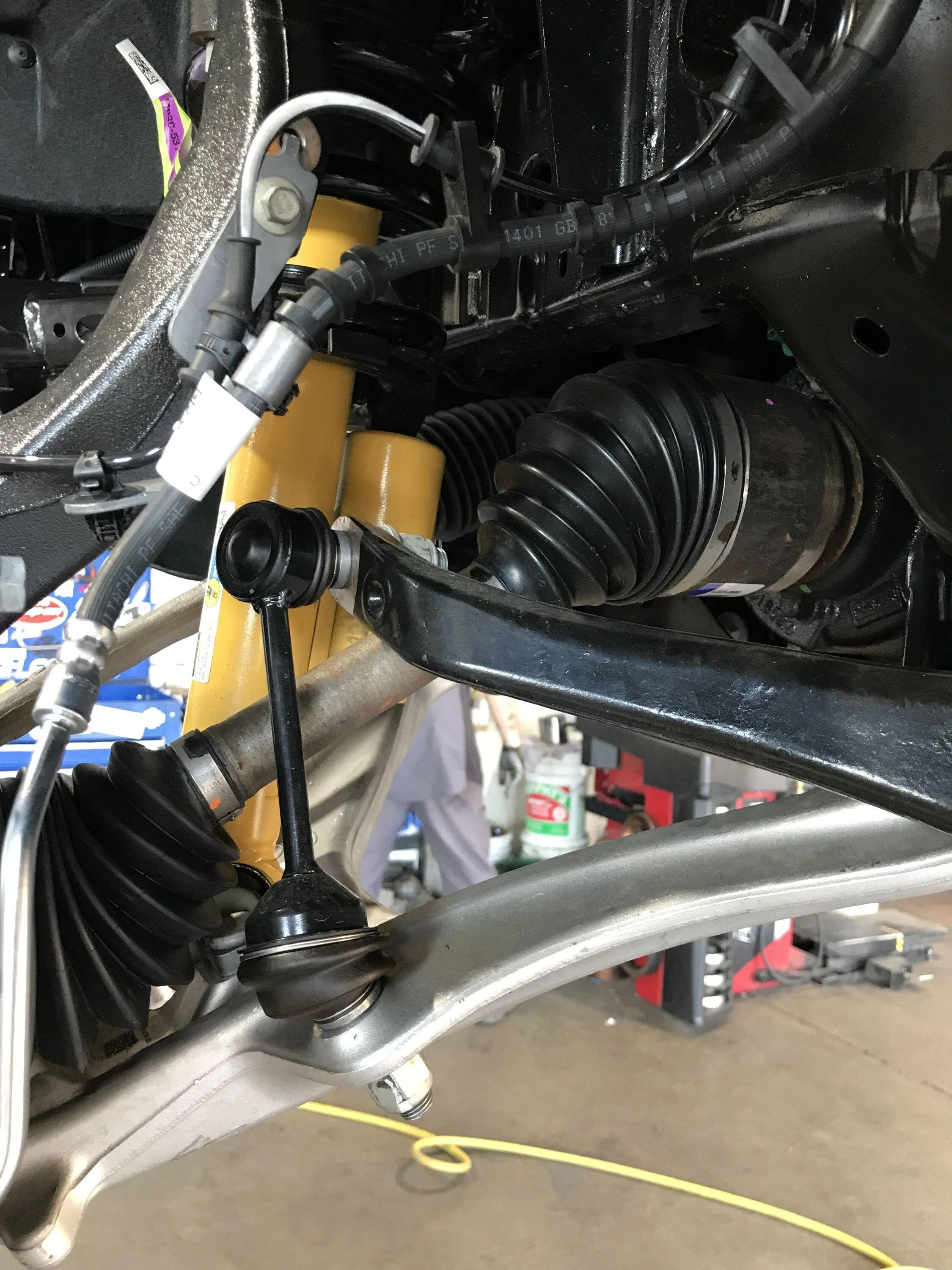

This was my cv angles with a 1.375" spacer before I reduced it to 1.125"

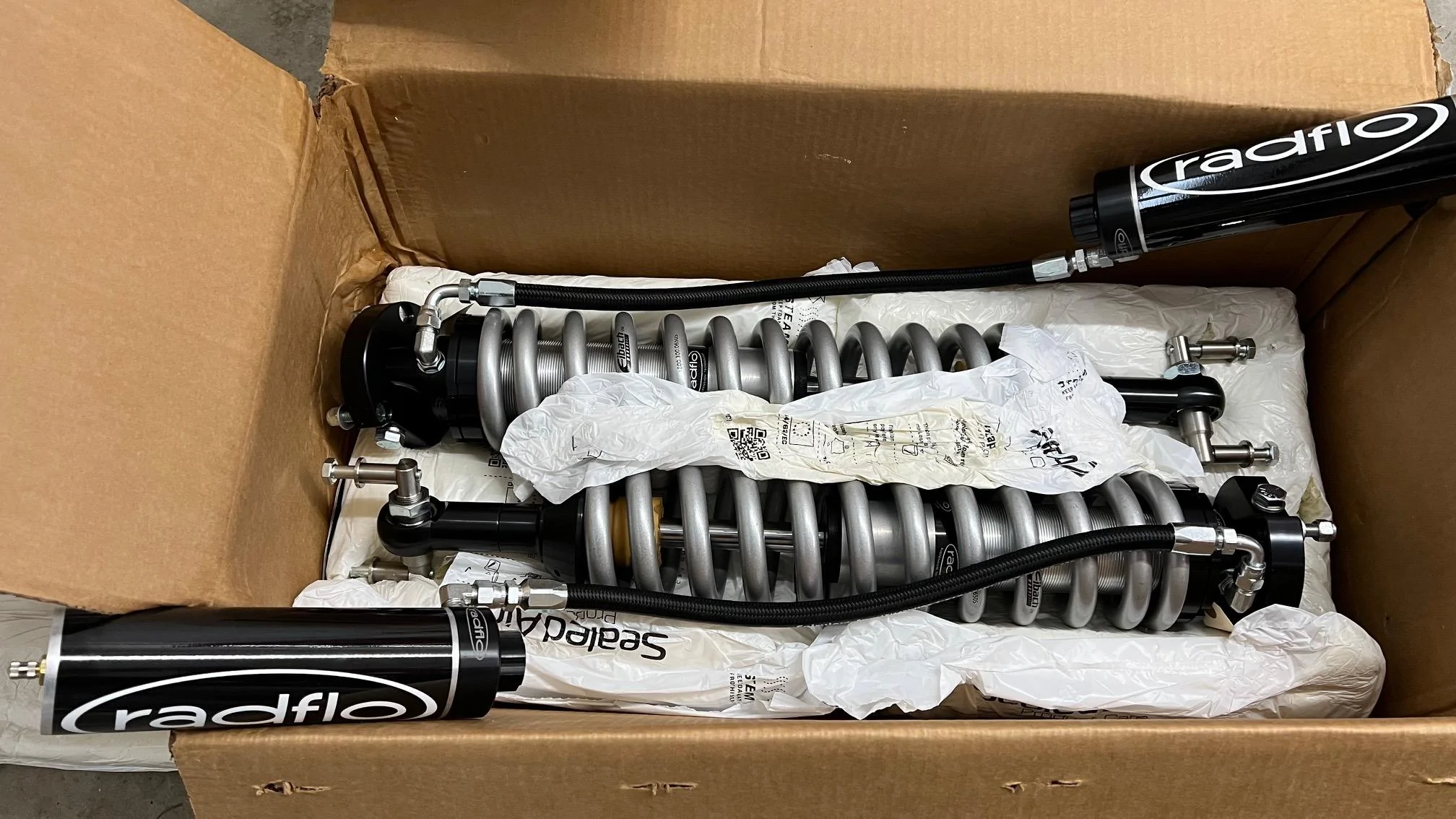

The pic of the shock in the box, you can see the 18" 650 PN, that's what it came with. You guys don't sell Radflo... So yeah, I would have loved a tuned package from you guys but I didn't want Fox or Kings, it was Icon or Radflo for me.
The 18" 650 is apparntly from an older batch which I just bought in March, after talking with Radflo (they've been great!!) I know they now come with 16", Radflo said I could try 18" 600. If stock is 374, Fox is 365 and King is 550, than to me 650/600 is over sprung and it feels like it. I'm a technical trail/rock crawler so I don't want stiff springs that don't allow the suspension to flex, hence my Baja comment. I ran a boat load of numbers, calculated OEM weights, front/rear distribution, every added accessory lbs, people, gear, fuel, water, basically maxed out the GVWR. I also calculated the SAS and Radflo experienced numbers based on compressed spring length, shaft length, angles, pivots, ran the numbers for desired exposed shaft length at rest, desired spring length at rest, backed into the calculated numbers vs actuals, plus some other numbers. Technically my desired target numbers called for a lower spring than 550, so, I split the difference between what I felt like a validated number from King and what my gut told me. I know 18"s fit so there was no reason to go down to 16" 550 and have to crank up the preload to get my height back. I still think I should have gone 450 but I knew that's too far from the valving.

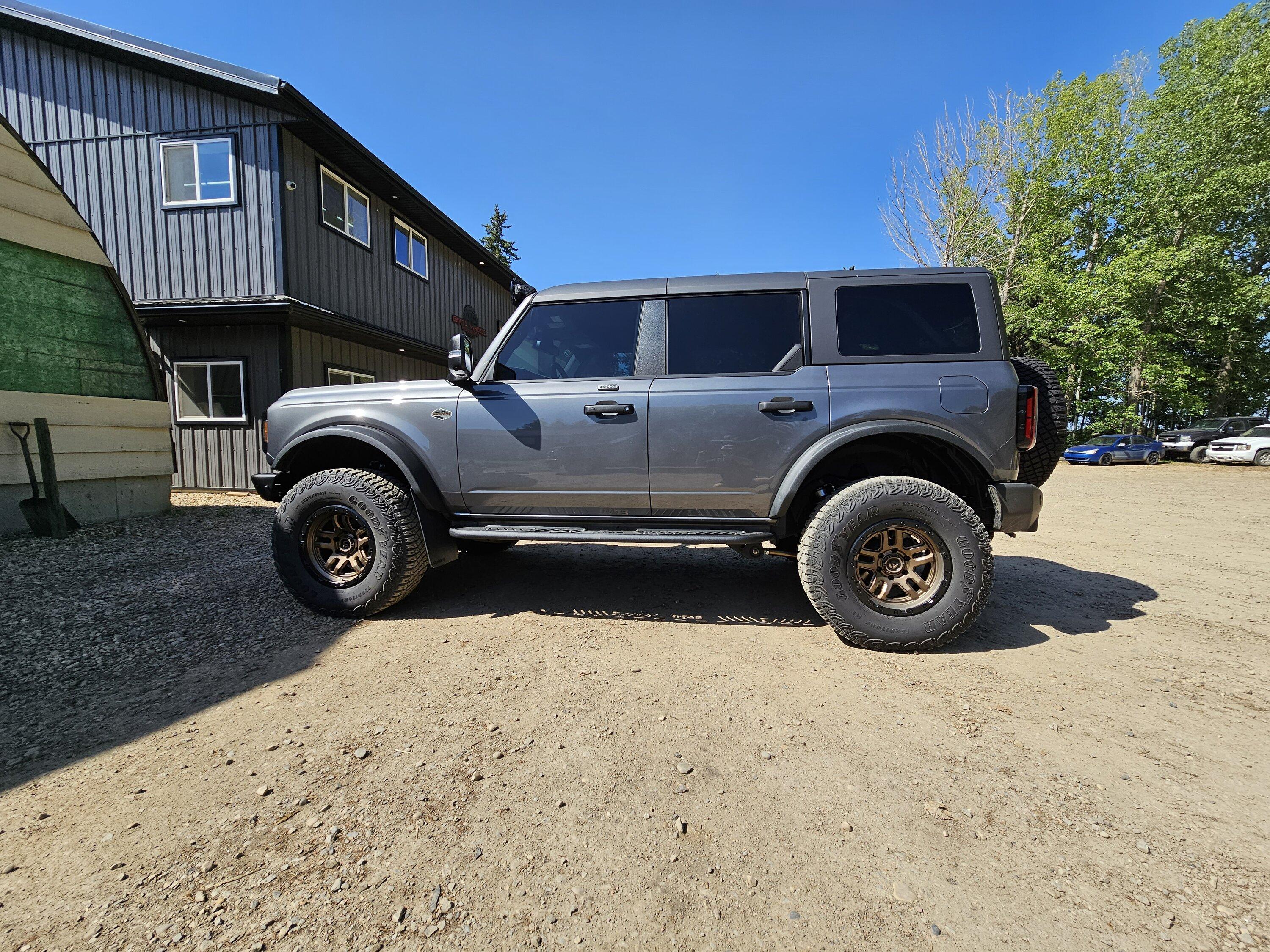

So you have a Badlands as well and I believe you said you got about 3" of lift in the front. I just did not think I would get that much lift from the extended travel being that they were only 0.586" longer. So happy I sent you that message and asked. Thank You
My Badlands was a Sasquatch and it sits 3” over Sasquatch. A non-Sasquatch Badlands doesn’t sit as high as the Sasquatch models (regardless of trim). Just want to make sure I’m not confusing you. The non-Sasquatch badlands only sits like 0.5”-1” over other non-Sasquatch trims.

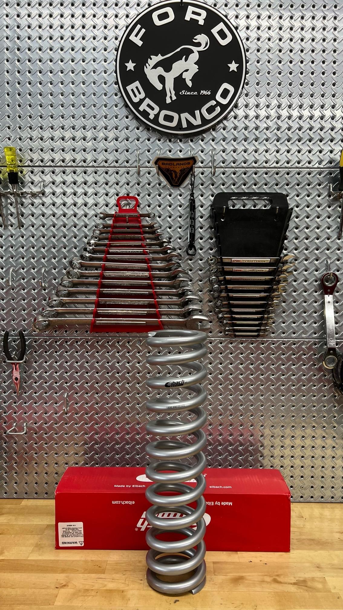

I'm currently stuck until I figure out how to compress this monster spring (I wouldn't have to if I had 16" springs!!), the cheap rental/widowmaker from the auto store didn't even compress an inch before I backed off. Going to try this next, only tool can find in stock around town. https://www.autozone.com/test-scan-...coil-compressor/537058_0_0?searchText=641429T
