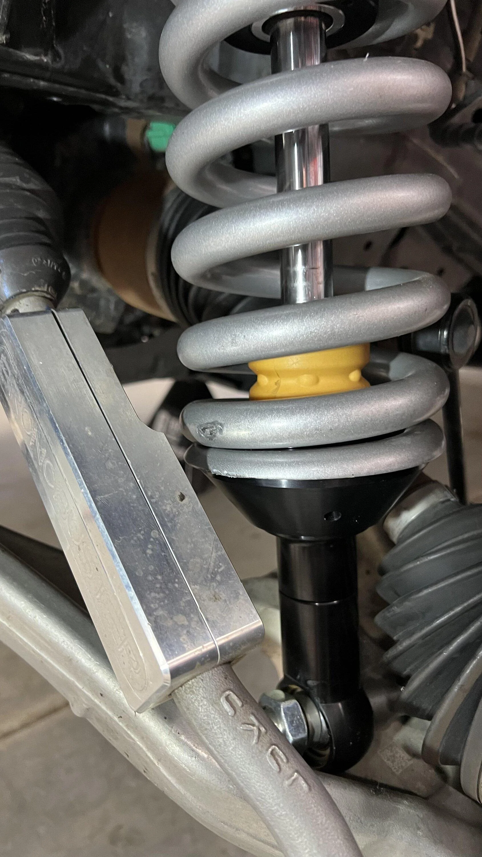

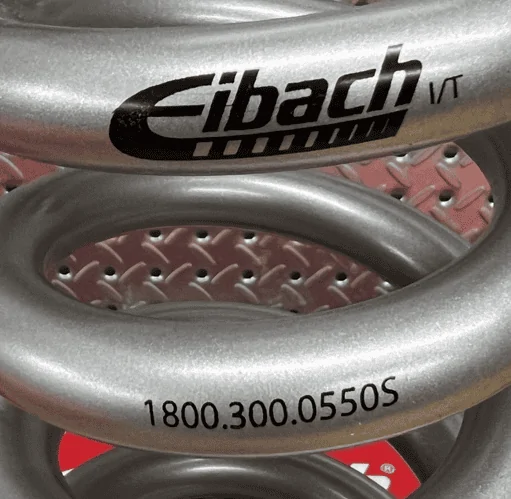

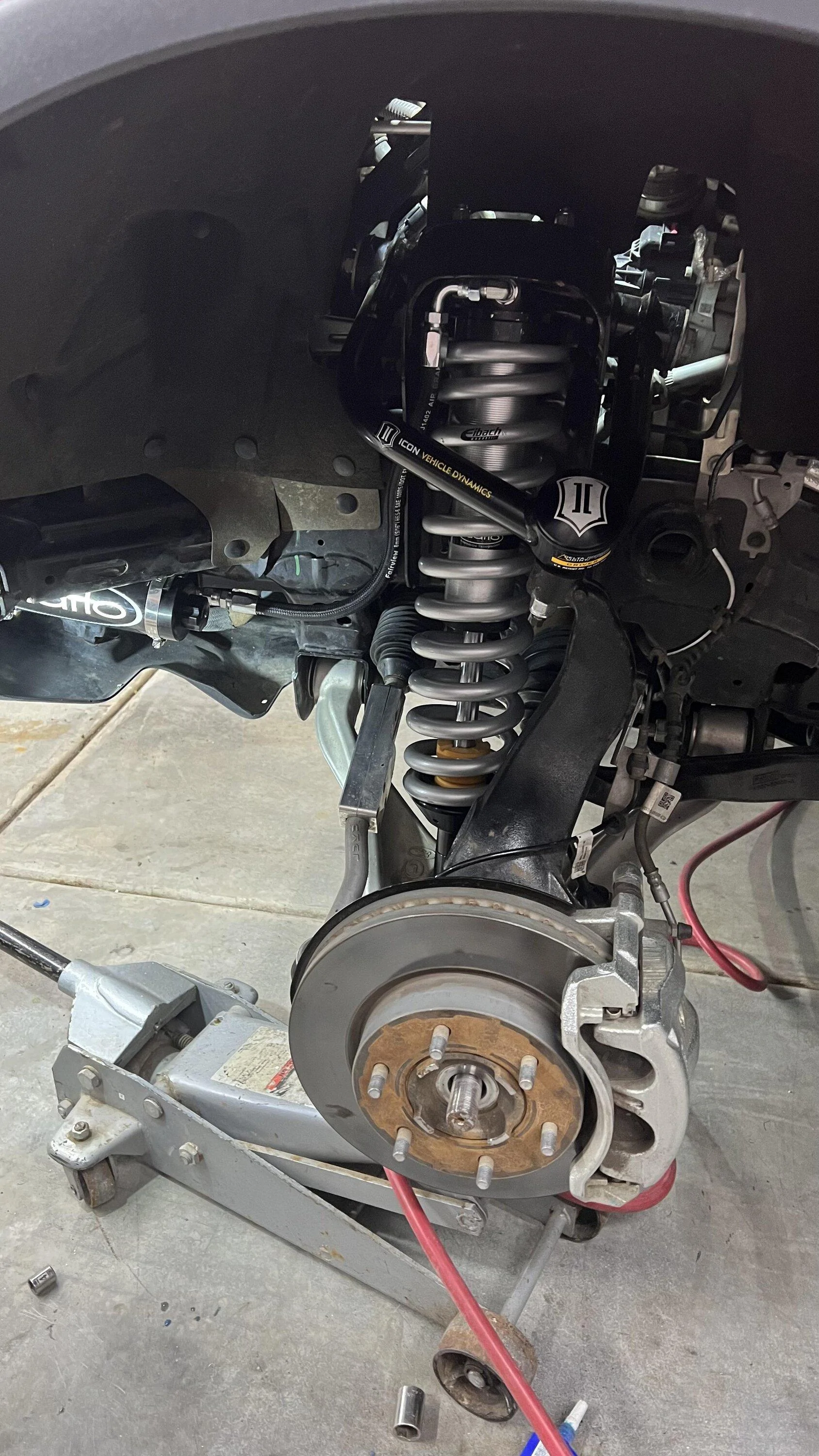

Got some miles on the 550 front springs, awesome! At the same pre-load (0 threads showing at the top) the front came down 0.8" compared to 650s that come with the shocks, then I added 3/8" preload back. Going to add a little more preload today and get an alignment tomorrow. We wheeled this weekend at Walker Valley, the overall setup (Ext Radflos, Icon UCA, Metal Cloak rear links/trackbar) just made everything easier, so smooth and the little bit of lift kept me from scraping compared to the other two Broncos with us. The suspension absolutely ate up every bump, dip, and pothole on the road, I didn't know it was possible to get a better offroad ride than SAS.

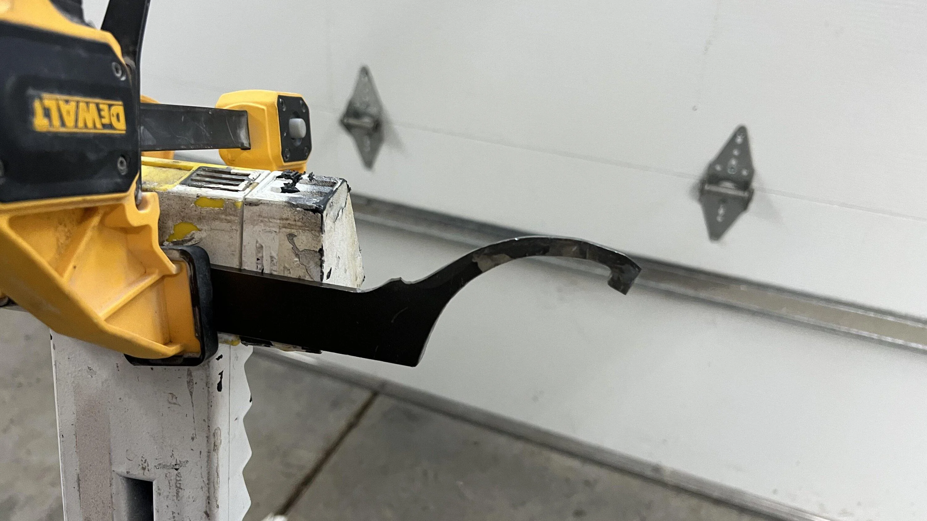

Since mine came with 18" springs, I figured why 16" and stuck with 18". The reason for 16": You don't need a massive spring compressor AND the pre-load adjuster won't be right under the reservoir fittings. Stick with 16" springs!! I had to grind the hell out of my adjuster to fit under the fittings. It's easy for the shock part number: Length, I.D, and Rate.

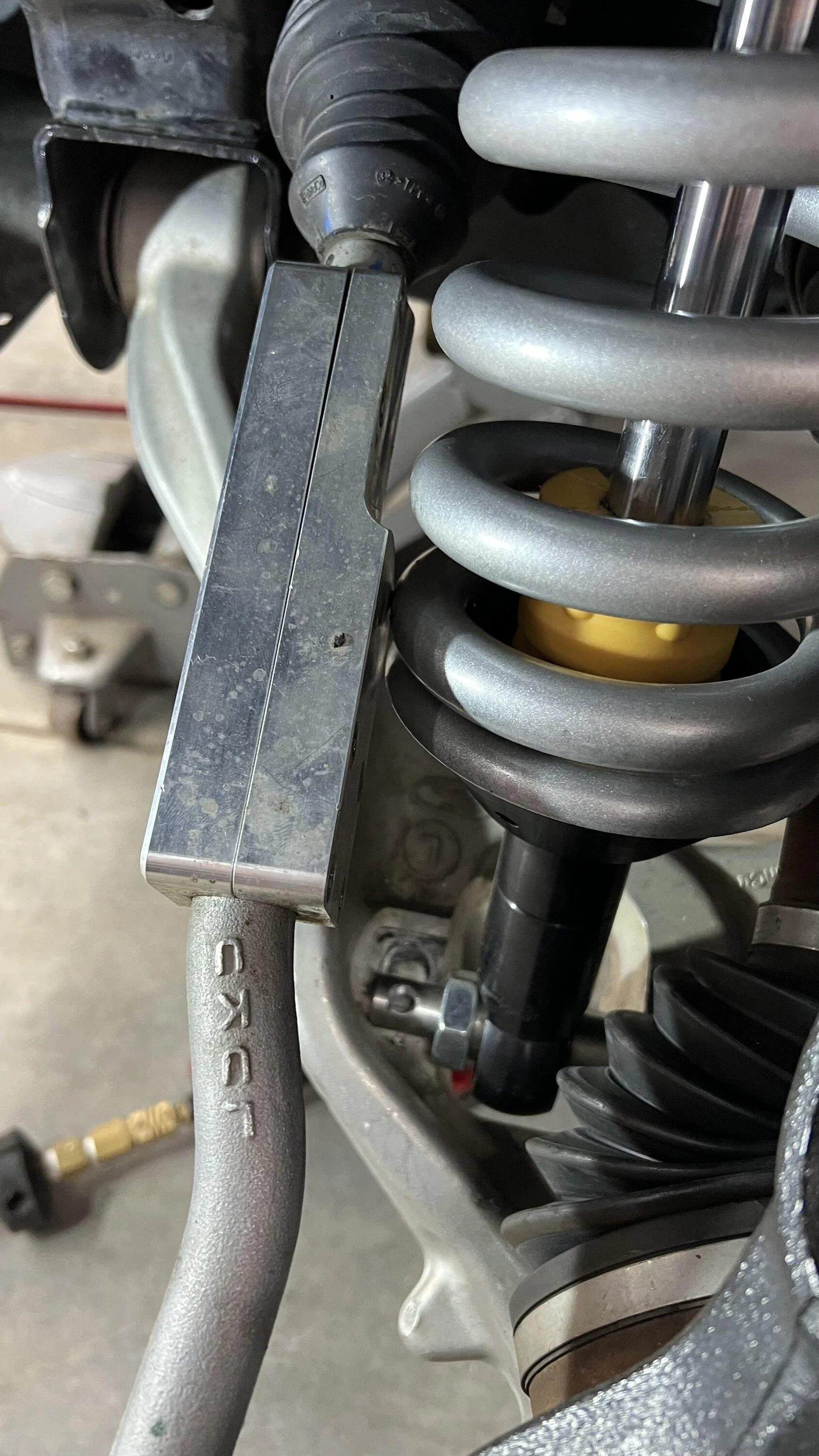

Forgot to mention that I found the Broncbuster Braces were hitting the driver spring but not the passenger spring. Since I added the RC steering rack bushings I didn't want to toss the braces so I decided to grind down the back of the brace a bit and now it clears.

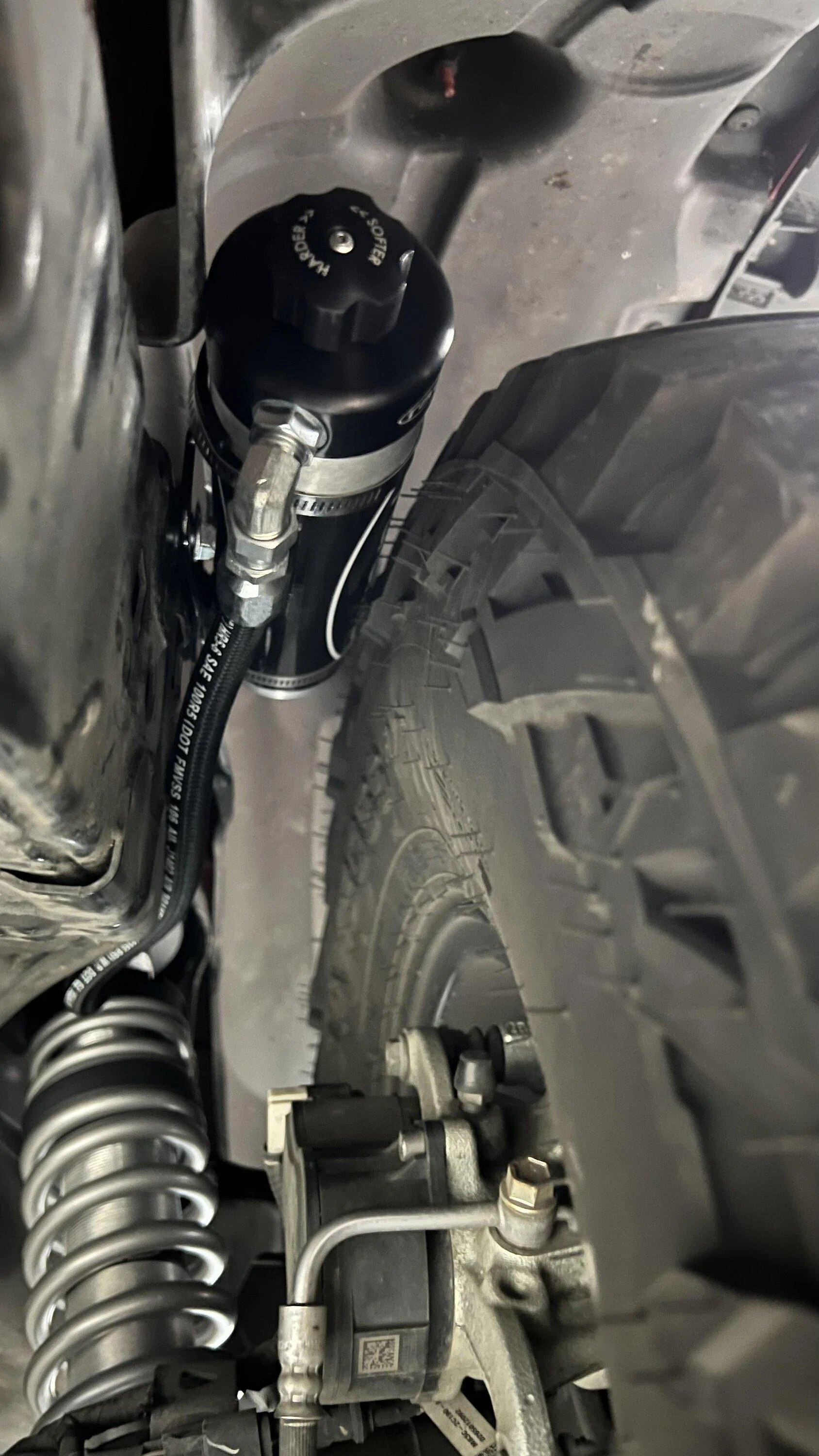

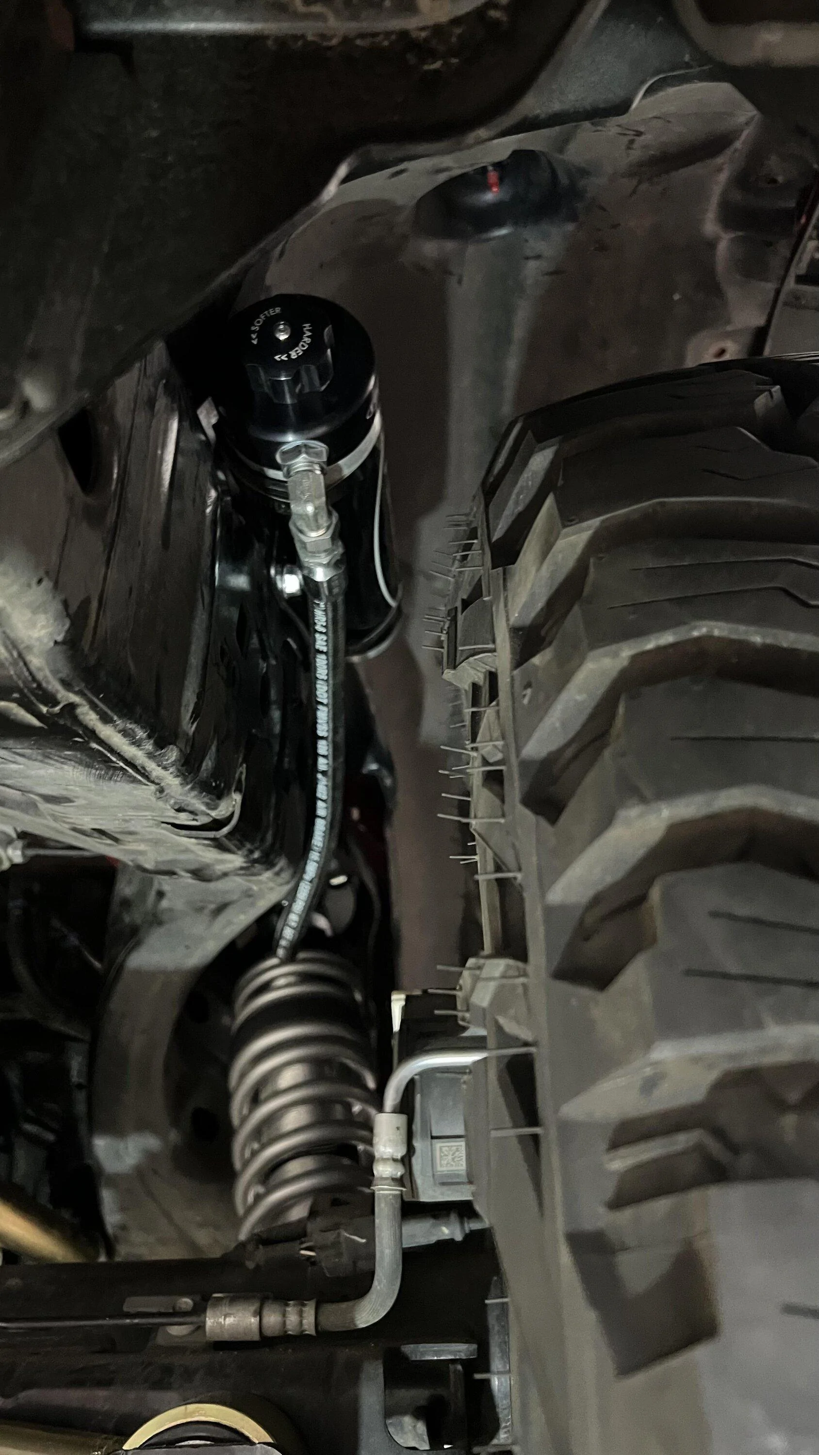

On the rear, the springs were just fine. Installing the rear resi bracket per instructions I had to bend the bracket over the top of the frame to clear the tires. My 35x12.5's were hitting the resi in the garage on the jack. If bending them over the frame didn't work I was going to find a new spot in front of the shock.
I'll send this feedback to Radflo, this was a lot of work but now that it's done I'm happy. So: 1. check with your dealer that the front springs are 16" and not 18". 2. Look into 550s or anything less than 650s for the front. 3. So far I'm the only one to complain about rear resi clearance so keep an eye on it before you hit the trails.
Good luck!
Ford Bronco Radflo Coilover Shocks review / feedback? IMG_8541 edit

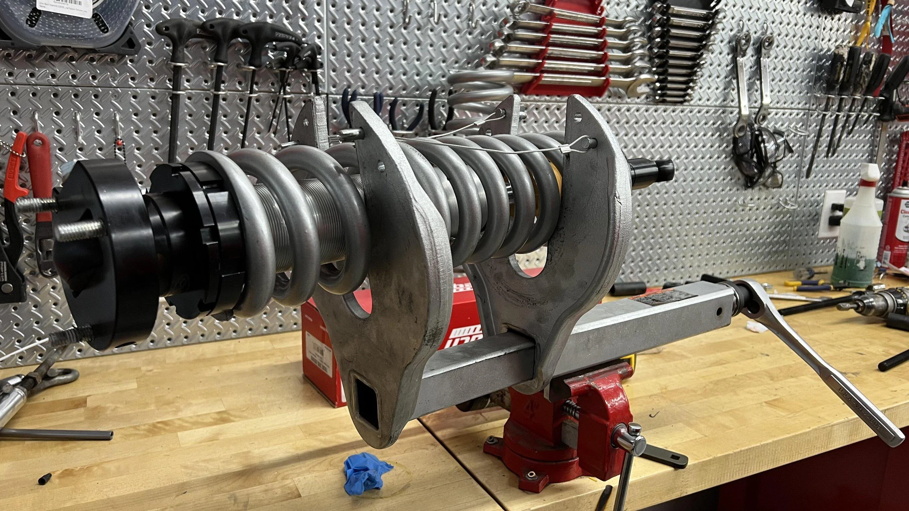

The legit rental tool from Autozone, the cheap compressor will not work!
Ford Bronco Radflo Coilover Shocks review / feedback? IMG_8520
Ford Bronco Radflo Coilover Shocks review / feedback? IMG_8537
Ford Bronco Radflo Coilover Shocks review / feedback? 1686688245502
Ford Bronco Radflo Coilover Shocks review / feedback? IMG_8513
Ford Bronco Radflo Coilover Shocks review / feedback? IMG_8514
Ready to put it back together! Last shock took 1 hour start to finish to swap out the spring.
Ford Bronco Radflo Coilover Shocks review / feedback? IMG_8528

I would have to agree with you for sure. My hasty measurement after install in my garage was almost 2 over badlands stock. Like, you I have NO preload in front as well with that measurement. I definitely am a novice in suspension tuning and will defer to all the much more technical gurus around here about where to measure for flex, travel and all the nitty gritty, but I would think that a 550 spring should help bring down that front height. 650s a bit stiff in front but man they EAT those whoops ha!
