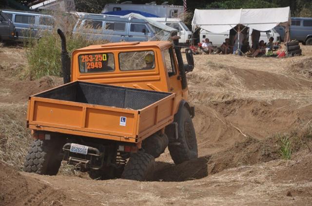

Unimog would disagree
Old tech is also old
and that’s also a farm tractor that can drive on the road not a road going vehicle that can offroad
but you know that

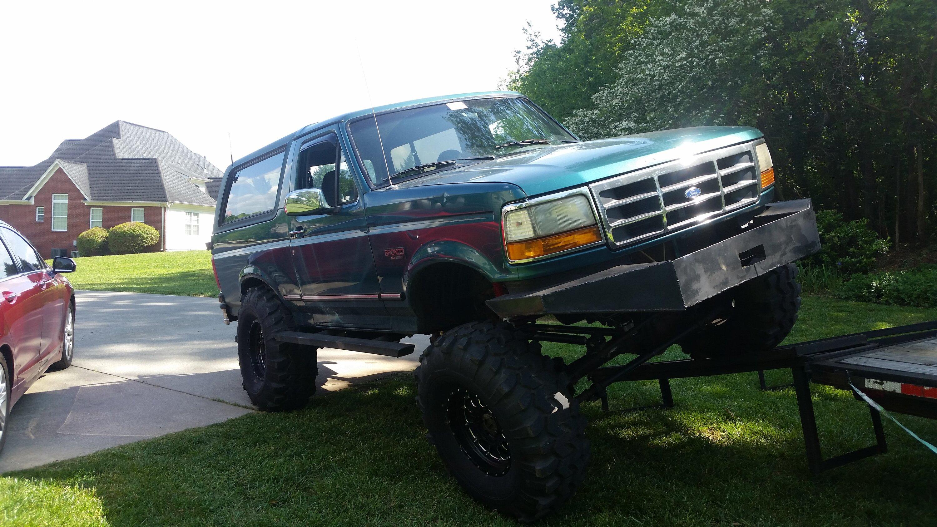

You apparently never wheeled an 80's bronco...lol.. after enough flexing the c channel frames would start flexing / destroying body mounts... left unchecked you could flex beyond 12" of frame twist.... Should it do it... meh .. the way I understand the c channel frame was to make it ride less stiff... ie flex... I could be misinformed however.
Ford Bronco New Ford Performance B-Bow & C-Bow Brace Kit 20200514_162546
My 96 is c channel as well but has not been abused beyond body mount stiffness.

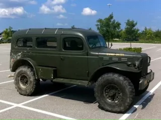

My 42 dodge flexed so much the tailgate would open on big bumps
and no it wasn’t work out bushings
it wasn’t designed to do 75 either
moving the flex makes other issues too

https://www.mercedes-benz-trucks.com/en_NZ/models/unimog-off-road/driving-concept/chassis.html
Unique frame concept.
Flexible and robust in operation.
At the core of the Unimog U 4023 and Unimog U 5023's all-terrain capabilities is the cranked vehicle frame with welded-in tubular cross members. Thanks to its torsional flexibility in combination with torque tube technology and the 3-point mounting of engine, transmission, cab and body, a diagonal torsion of up to 600 mm is possible. As the frame is completely welded, it possesses great torsional resistance. At the same time the cranked frame makes possible both a low centre of gravity and high ground clearance. The typical Unimog portal axles also ensure this. And the asymmetrical arrangement of the axle differentials makes it easier to override obstacles
