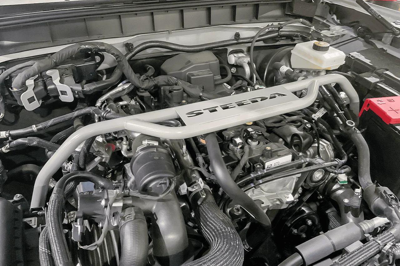

This will only reinforce the roll bar, not stiffen the chassis. The Bronc is body on frame, not a uni-body. The only way to stiffen the chassis is to put something on the chassis. doing things to the body does nothing for the chassis. A uni-body vehicle is a different story. A body mod will stiffen the chassis.
Examples:
Strut tower brace for a Bronco ( I hate the term strut tower but that is what Steeda calls it).
Ford Bronco New Ford Performance B-Bow & C-Bow Brace Kit 1701439472785
It goes from one side to the other of the top coilover seat on the frame.
A Bronco Sport on the other hand is a uni-body and as you can see those strut towers are connected to the body.

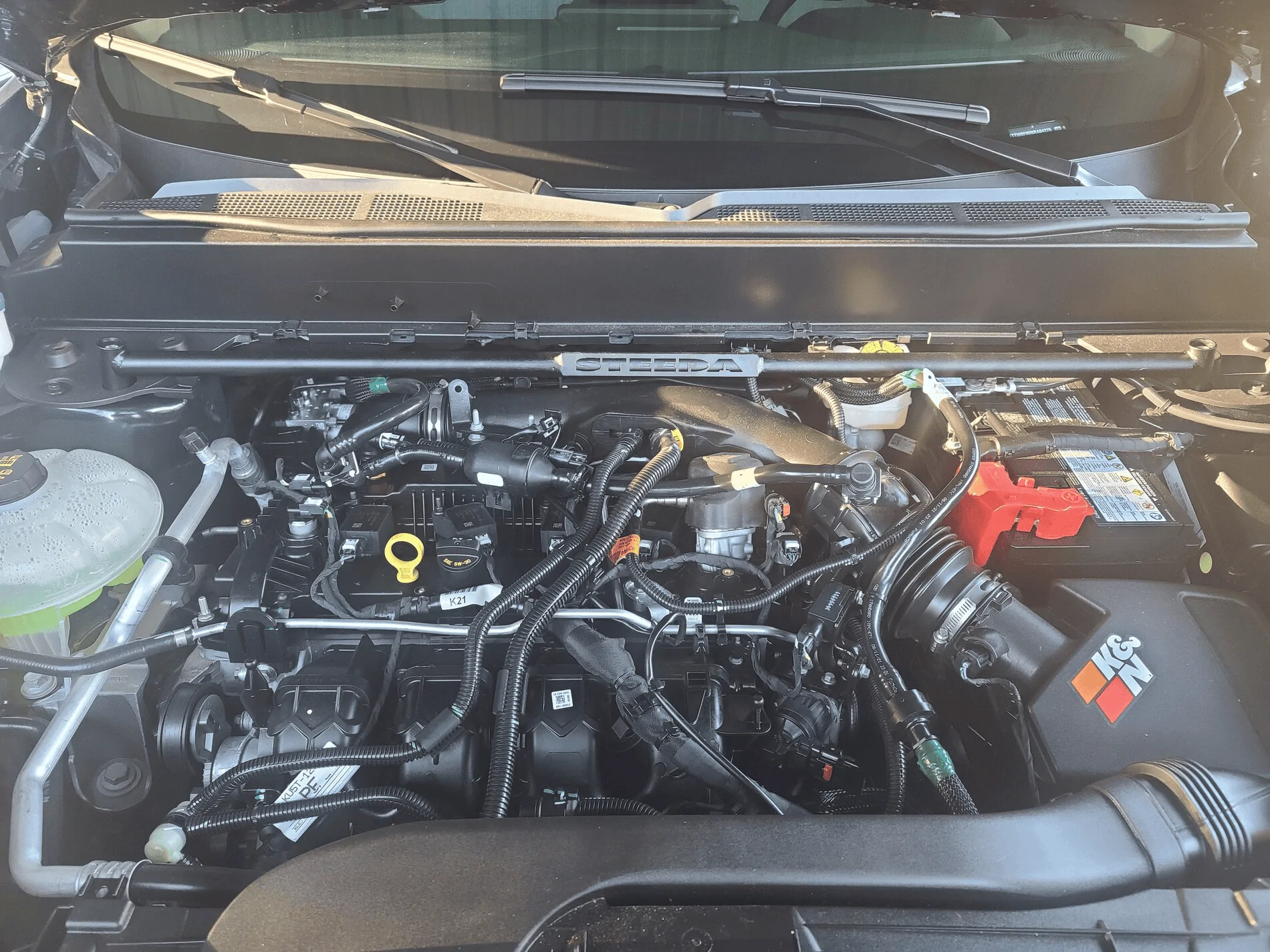

@BAUS67 : Lol I did not know that they had even made a strut brace for the Bronco. Went to Steeda website, and there it was. 267 price. However I wonder, would that affect articulation?
Frames should not articulate. Suspension should articulate.

Understood, I guess what I should have said, would it affect the flex? Lol, I do not know, I know what they are for, I have it on my GT500, and I have a diamond brace on my 68. Both stiffen the chassis for cornering. I guess, I do not understand why a strut brace would be used on a Bronco? It would seem if it was needed, the BRaptor would have one.
