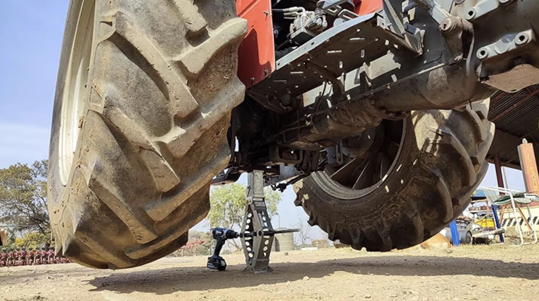

Neither photo is of my Raptor. My understanding is that the OEM jack, using the riser, elevates to 19.5”. The Gortech jack raises it to 24”. It’s vastly more robust, stable and well built.
I really just wanted a taller, much better built, more stable version of what the Raptor comes with and to that end, it delivers 100%.
I’m guessing the OEM jack isn’t able to do this (not that i need it to, but kinda illustrates the point).

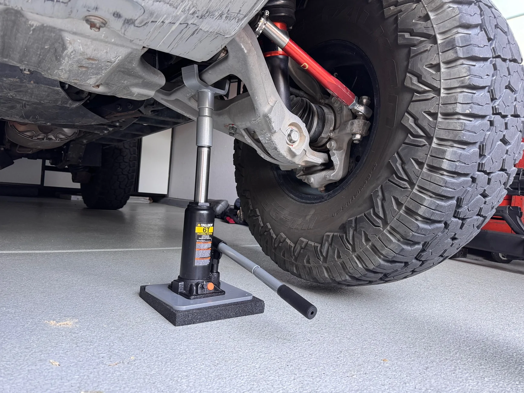

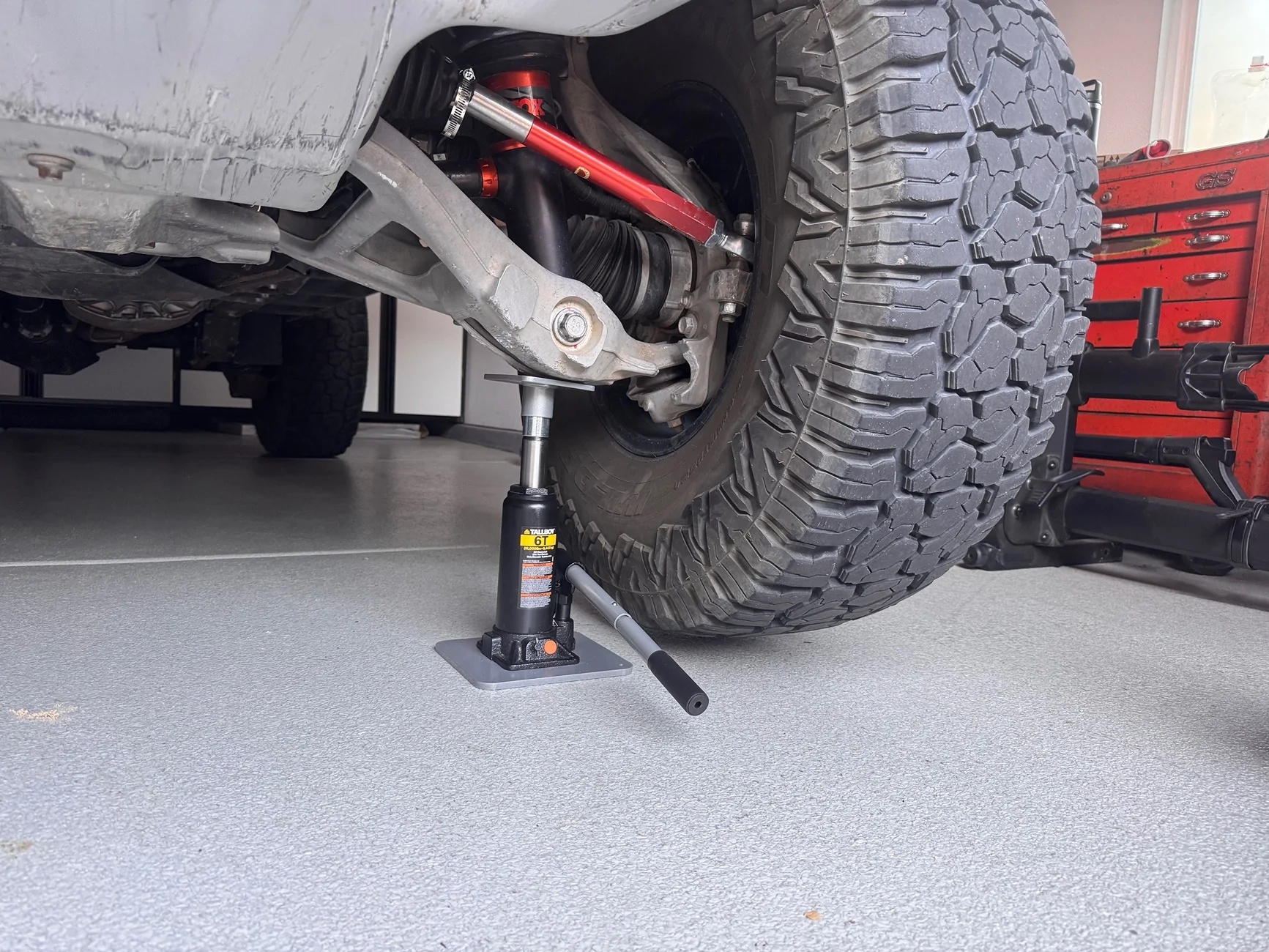

@MDrums first pic… its about 11.75” to the shock mount on the LCA and 14” gets me about an inch off the ground. Note I have 38” tires (3/4” higher than stock) and 2” spring lift ( may give some small advantage while raising). So theoretically that jack will work on this point. The jack does need to be very close to the tire, esp without the flat top
second pic it was about 17” to the LCA here, raised to about 20.5” to get an inch of clearance. Theoretically this will work, but you need a saddle to get safe contact. Also having a jack pad like in the pic should keep you from getting to the end of your stroke.
