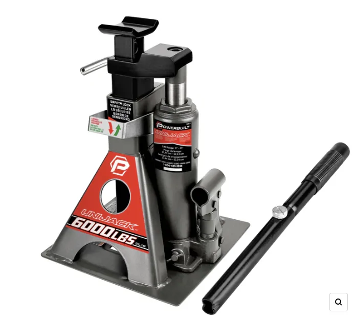

*** Sorry just saw this thread *** :facepalm: but would still love feedback on the if the PowerBuilt would work with the 37's

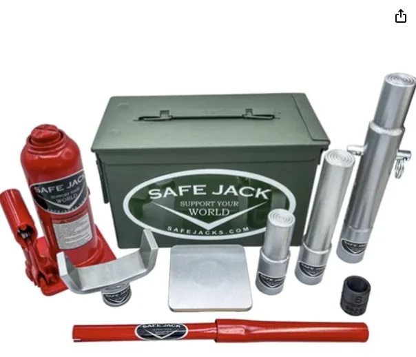

Looking for feedback on what kind of jack folks are taking off-road for their Raptors or Broncos with 37+ tires. I've read through a few different threads and the two leading candidates seem to be Safe Jack and PowerBuilt. I was initially leaning towards the PowerBuilt after seeing quite a few folks carrying one and the price is great but is the lift enough for a Bpraptor's clearance? The rear seems like it could be sufficient but the front seems close... Had also looked at the Pro Eagle but it's way too bulky. Would love any recommendations - Thanks!

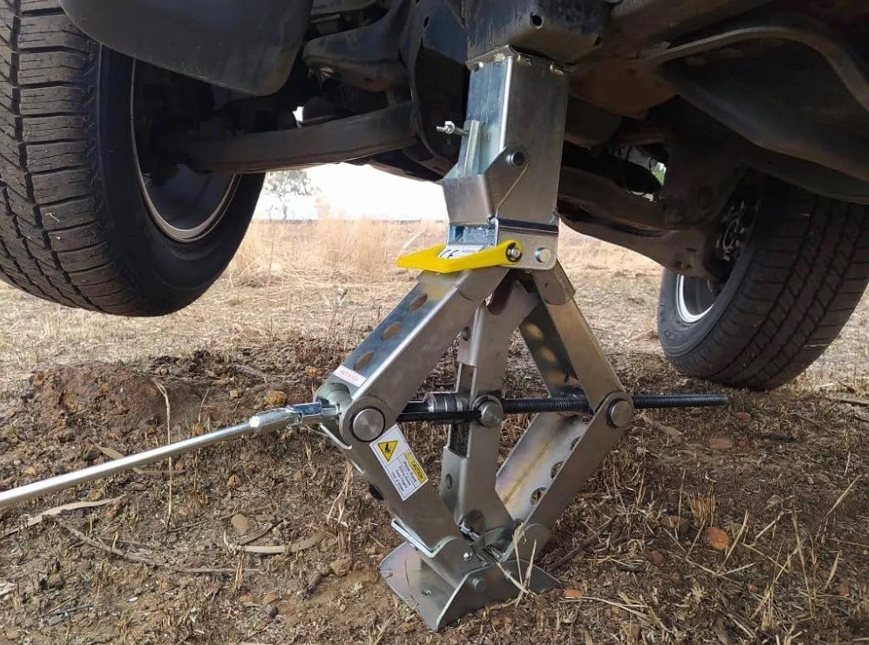

I use the Safejack. It, along with all of the extensions, fits perfectly in the cubby under the cargo cover.
Is that plastic box strong enough for all of that heavy metal when also wheeling hard?

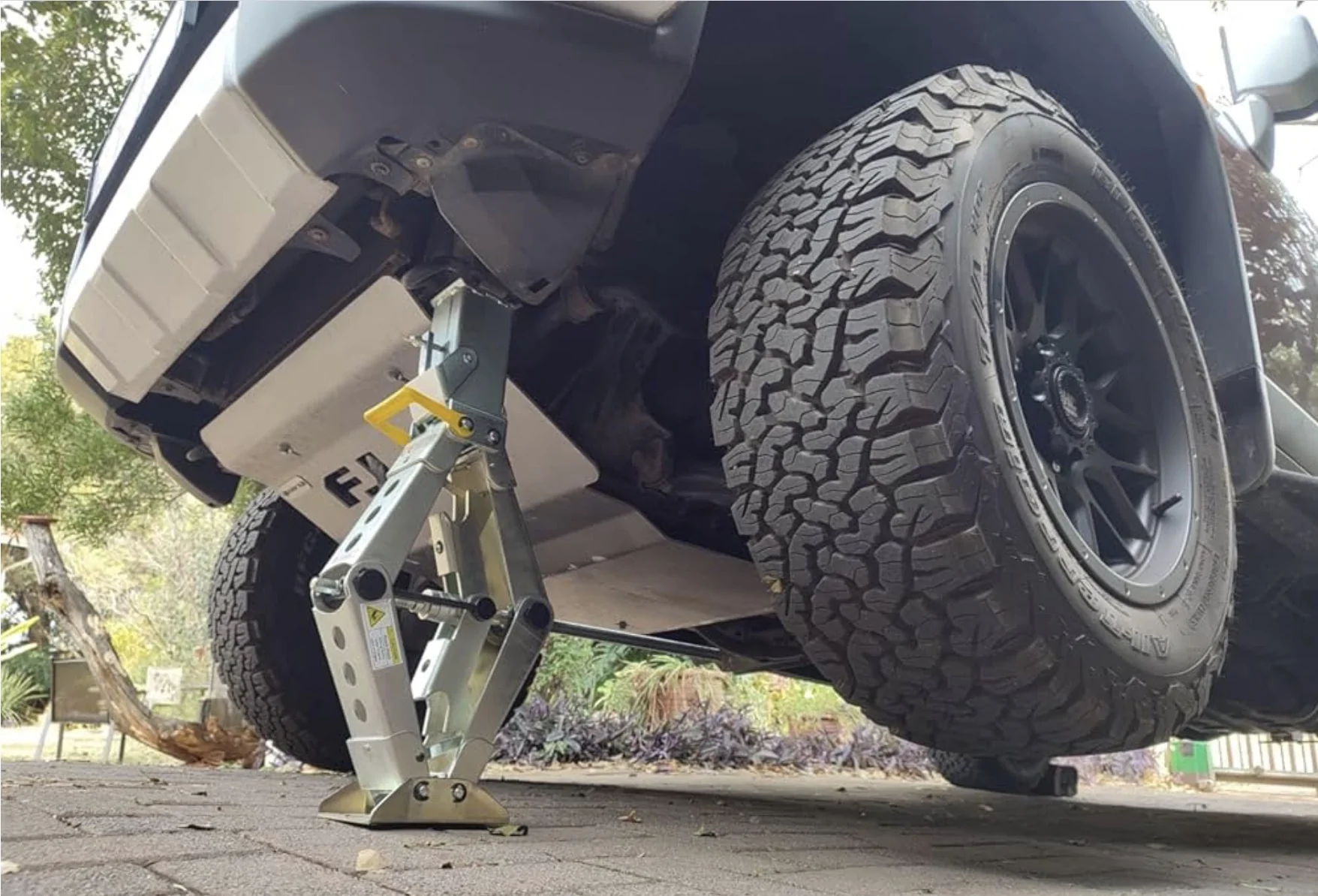

Very nice scissor jack, but man it's HUGE...
It really only seems large next to what came with my ride. As we all know, what Ford ships with Bronco’s is a little on the skinny side right out of the gate.
I kinda prefer the mechanical simplicity of this To other options.
Had it in my first Bronco since near day 1, wheeled hard. Now it’s in the Raptor, wheel that one hard too. The box is fine. I keep a few rags around it all but I don’t think that’s even necessary.
