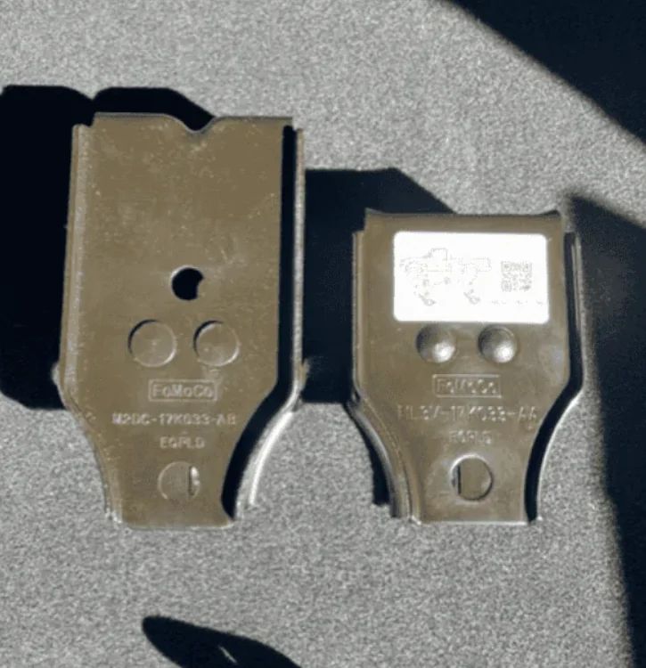

The standard scissor jack has optional adapters for different bronco models. The sasquatch comes with the tall adapter, and it can be bought separate. It's probably the adapter that should come with the regular non-sasquatch models. I got one for my big bend wheels.
For taller than sasquatch tires and to fit inside the jack storge space, I would switch to a toyota bottle jack mechanical not hydraulic and add the tall adapters to get the lifting height.

I posted the part number on the forum here for the sasquatch adapter, but that was at least 2 years ago!
It's all you'll for your size tires need the storage space designed for it. You'll still benefit with having a couple 2x4 blocks!

Found it!
Sasquatch extension part number M2DC-17K033-AB
