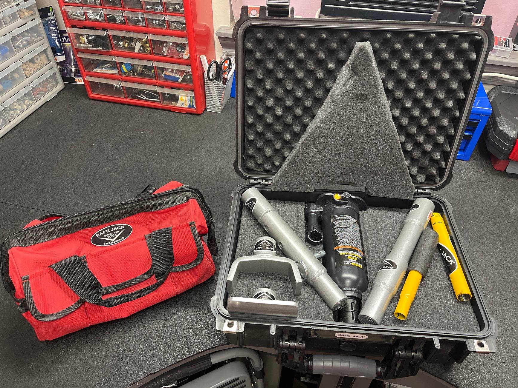

Safejack. Has extensions for lifted vehicles and takes up a very small amount of space. Comes in a carry bag from Safejack, but I put mine in a HF box so I can strap it down in the back of the bronco.

So I have a safe Jack. The issue is my bronco is lifted by 4" or so and I have 37" tires. I can't use the safe jack alone to get the tire off the ground. You want to rest the bronco on something sturdy and steady, when you are changing the shaft length because in its base form it will not raise enough to get the wheel off the ground. I needed a jack stand so I could swap out to a taller shaft. Also you need a platform to put the jack on to spread the weight so it will not dig into the ground. Now having two jack could accomplish the same thing. Anyways just my experience trying to change a tire. The other option would be to jack from the LCA, but you need a better way to secure the jack to the LCA. I got lucky with a piece of wood I was using, and I would not do that again. Thus I got a jack stand that I haul around on trail.
