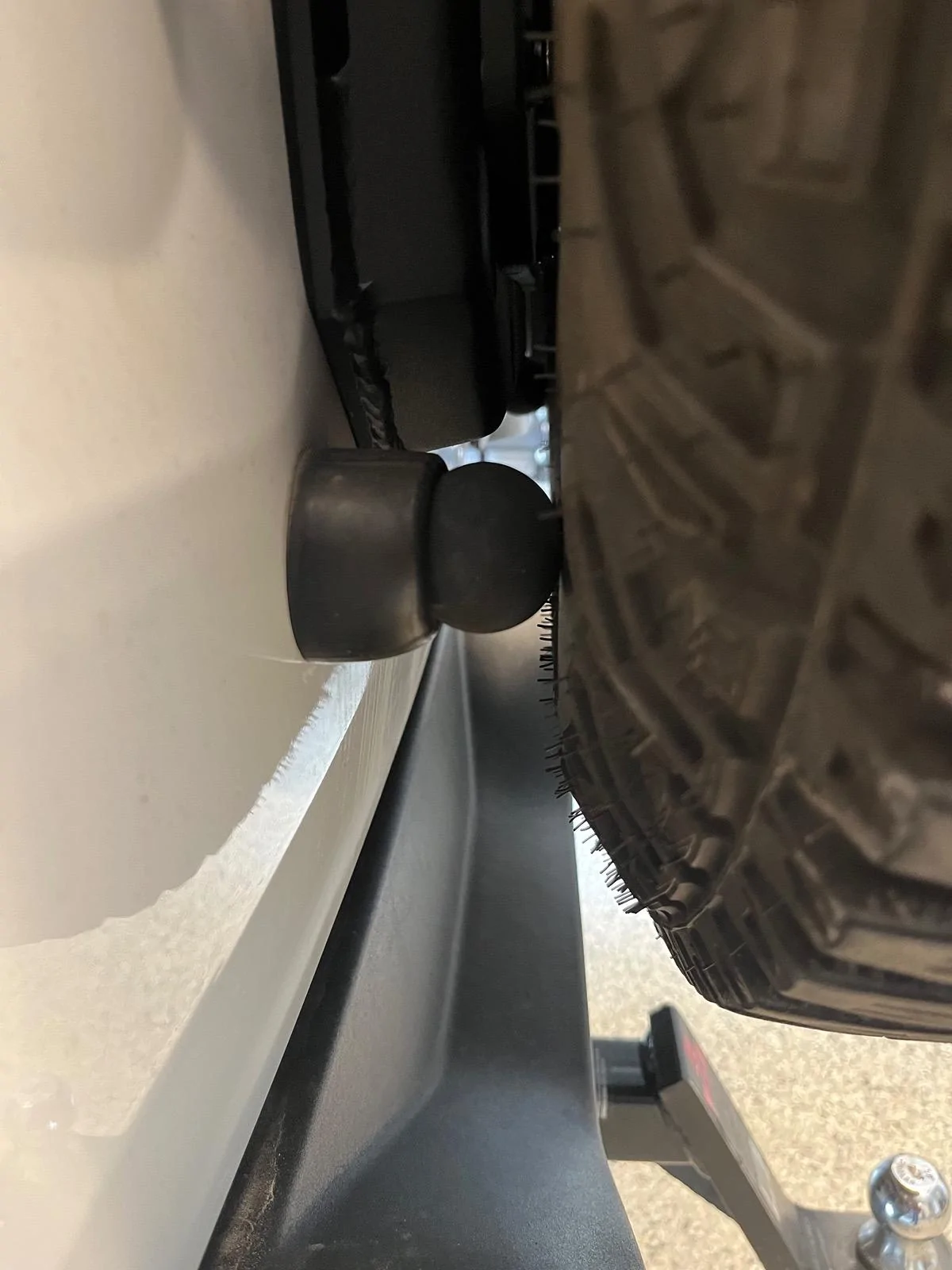

Just added mine - it doesn’t look as stupid as I thought it might. Not bad for $14!

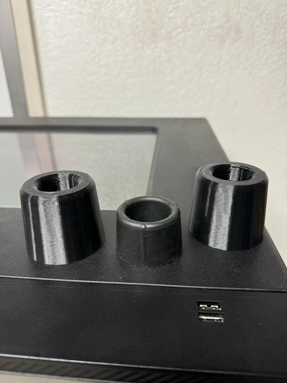

I designed a spare tire bumper extension that is 3D printed from durable and flexible TPU, it fits over the stock bumper perfectly and doesn’t even require you to completely remove the spare to install it.
Slide the wheel back a bit and align the grooves and push it on, tighten up the wheel nuts and your set, takes 5 minutes and looks factory.
The TPU is pliable and you can squish it with your hand. I can make these in custom lengths, this set at 50mm works with a 0 offset wheel.
