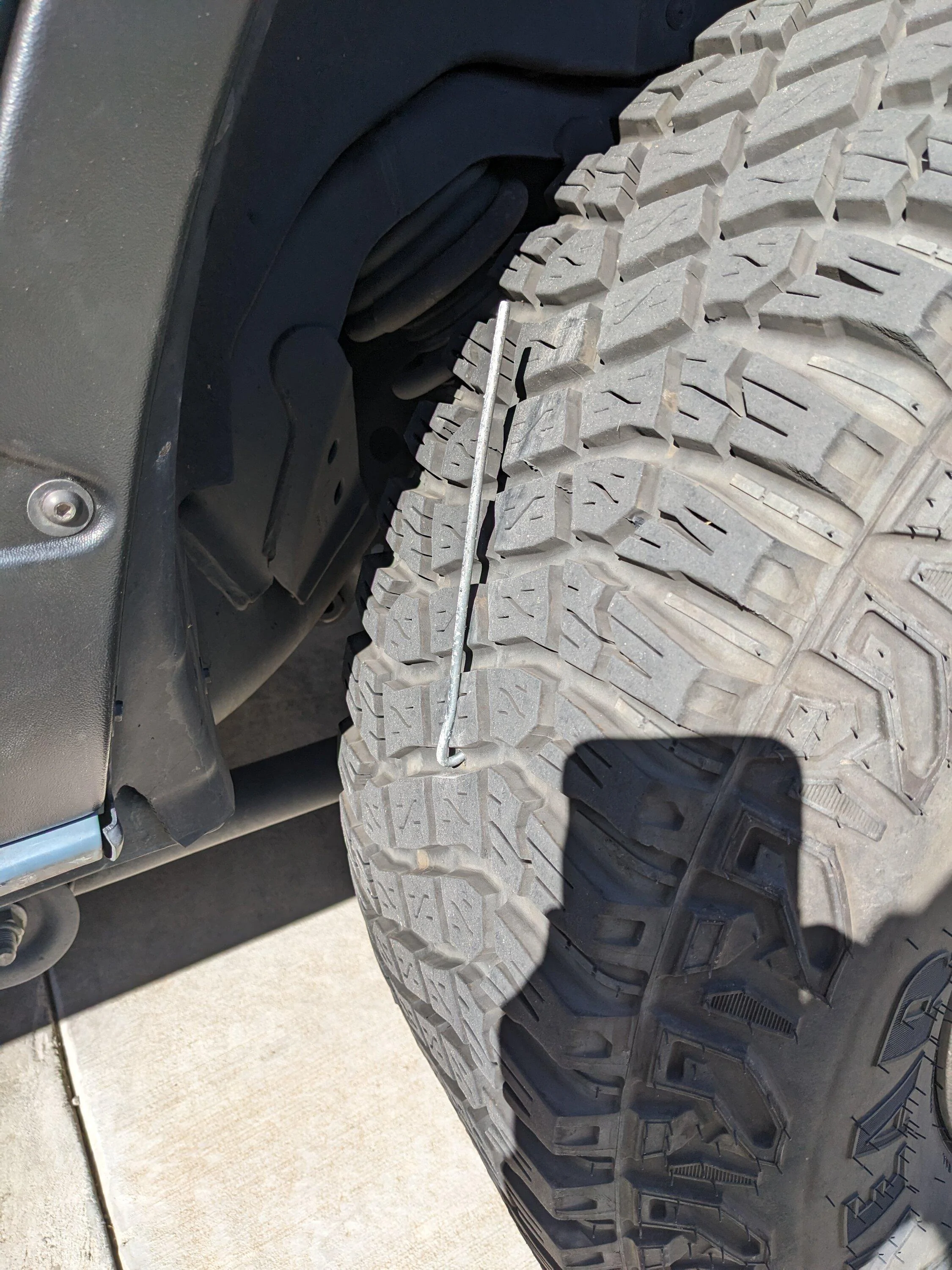

I got a flat this weekend so I haven't had the spare on (neighbor's Halloween decorations got a bit sloppy), and I've experienced the same thing. I think you're looking at the wrong part. I think putting a lighter strut on it will help. Or you just need to get used to slamming it without the momentum from the tire to help it close.
