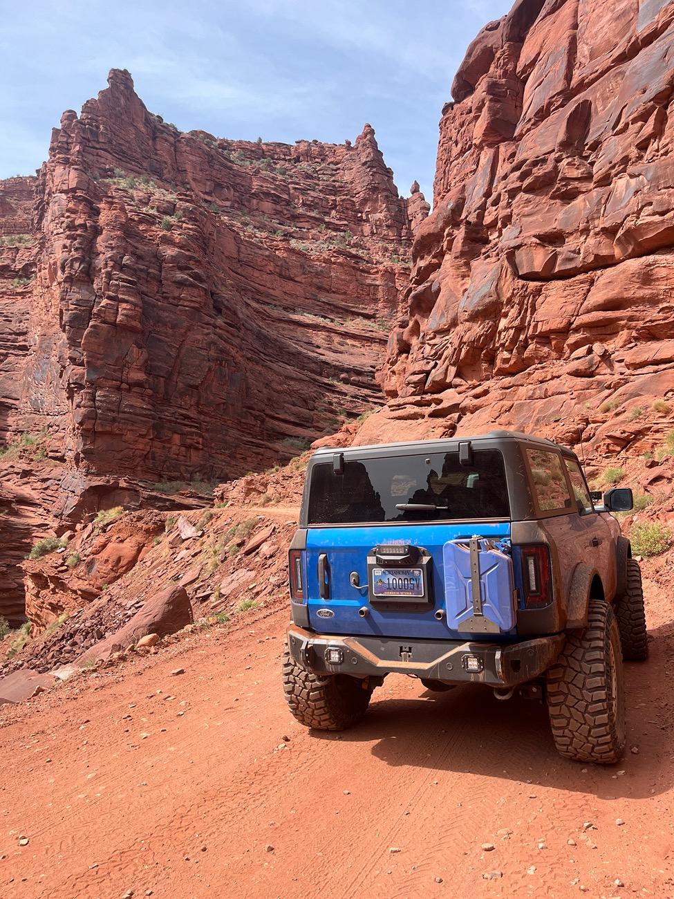

I run 37’s on beadlocks. Ain’t no way I’m going to be able to line up 130lb+ of wheel/tire 4 feet straight up without destroying my $400 back up camera.
I carry tools to remove the beadlock if needed and have an inner tube from Interco sized to fit. I also have tire tools, plug kit, spare air valves and even a sidewall repair kit.
You’re not going to be able to store a spare tire vertical inside the rear because it’s only 34ā€ between the floor and roll bar.
Ford Bronco Spare Tire Delete IMG_8142
Also, if you do rock crawling you need to be cautious with a big spare tire hanging off the back. Keep the spare air pressure low (5psi) to better absorb rock drops.

Where did you get that jerry can carrier? Who makes it?

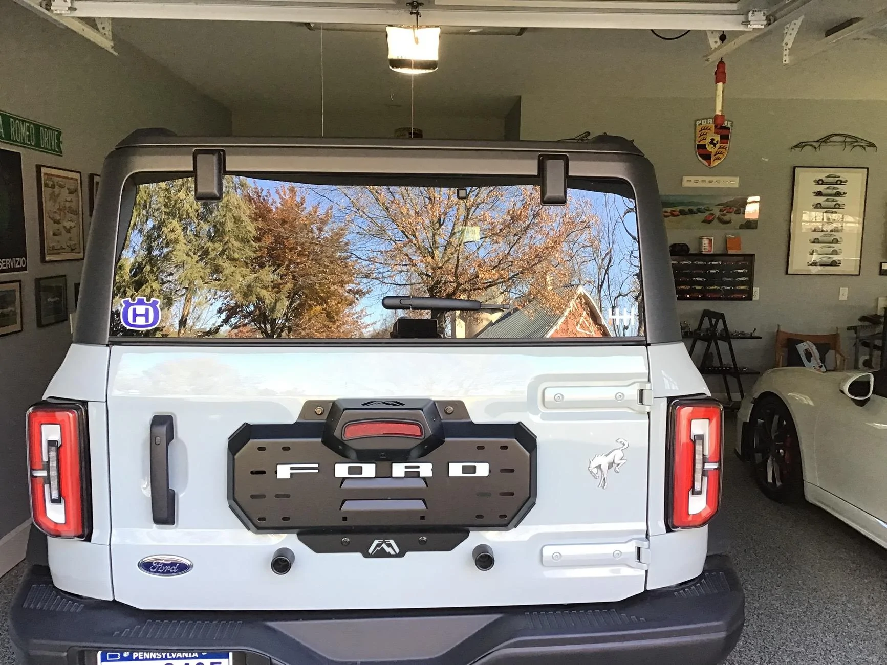

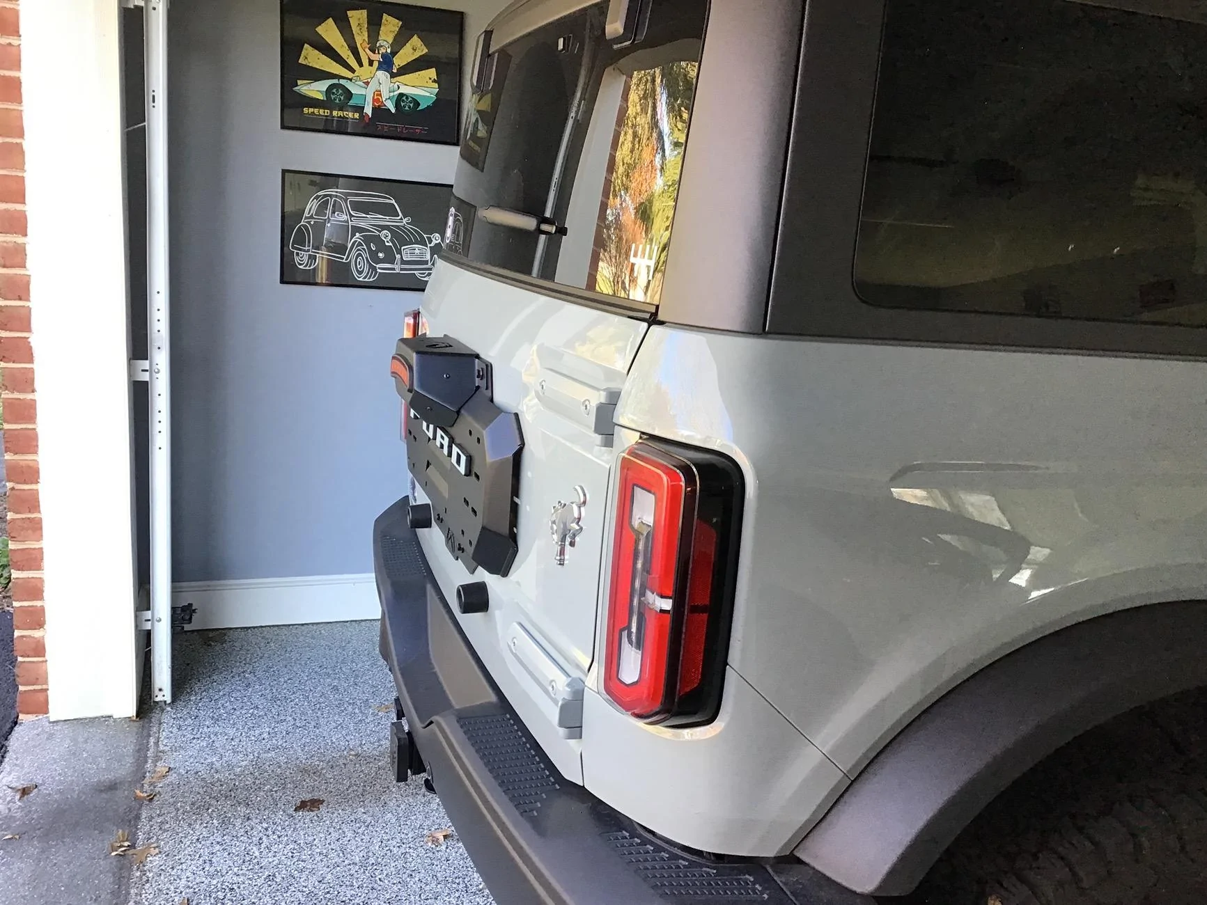

The last time I had an on-road breakdown was due to a failed water pump in a BMW in 2016. Before that, it was a fuel pump failure on an Alfa in 2000. Before that, it was a timing belt on a Toyota in 1996. Can’t remember past that, but I don’t recall EVER having to put a spare tire on due to a flat. I carry a plug kit and compressor and have installed plugs several times. I’ve even plugged sidewall holes, which worked perfectly as a temp fix. But a flat has NEVER stranded me. I’ve been driving since 1977.

@Denny Swift
Nice job and looks good. When you install, does the steel sit directly on the tailgate? Metal on metal? And do all four of the rubber corners sit flush against the tailgate? Thanks bud!

There are rubber pads so there is no metal-to-metal contact. It's well made, and the backup camera view remains the same.

@Denny Swift
I just got one and the four rubber pads at the corners don’t hit the tailgate before the middle does. That’s why I was thinking there was something that maybe goes under the middle part to support? Really like the function of it and the camera is right on. Feel free to share any info or suggestions on the install. Thanks for the time.
