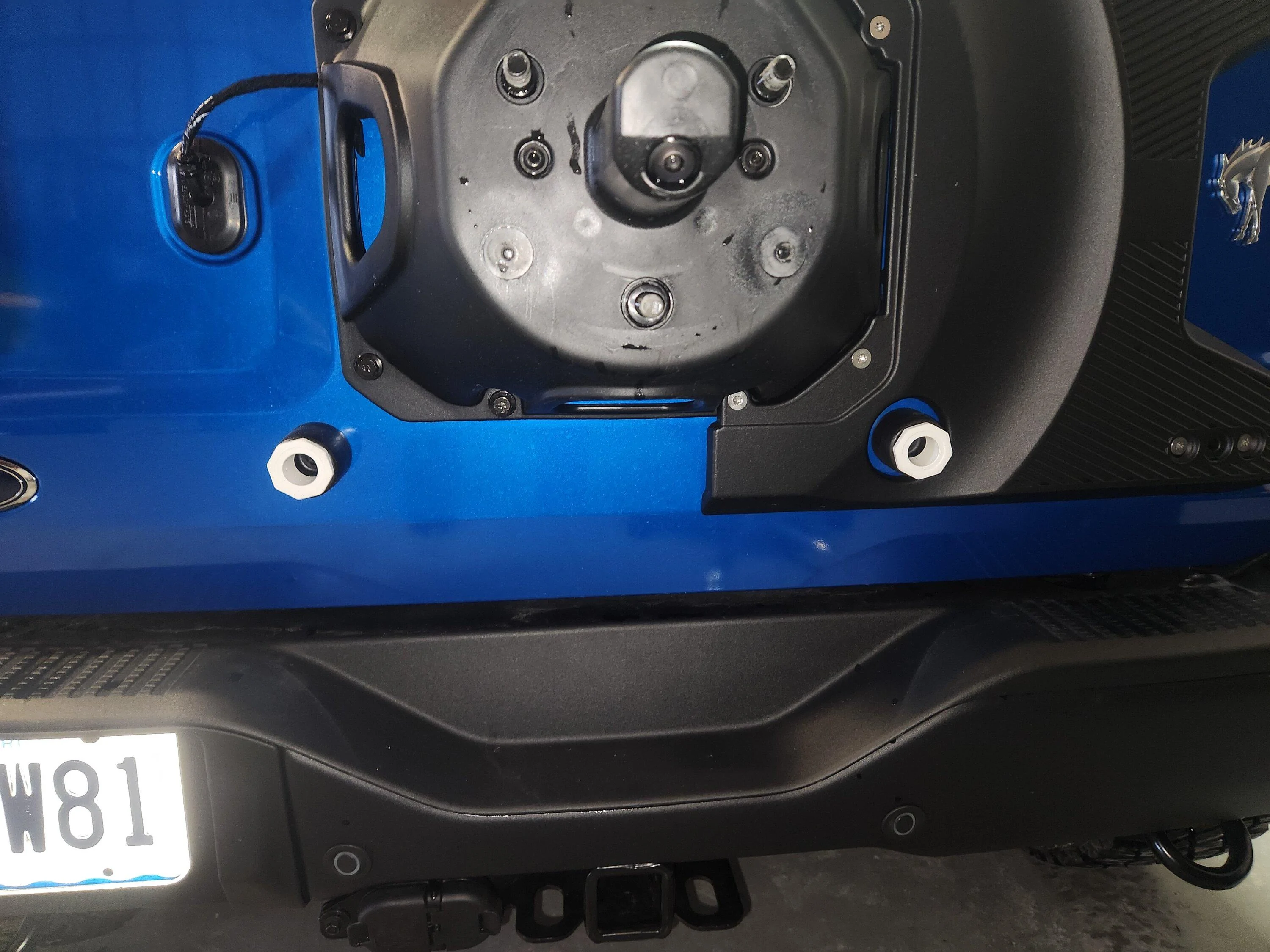

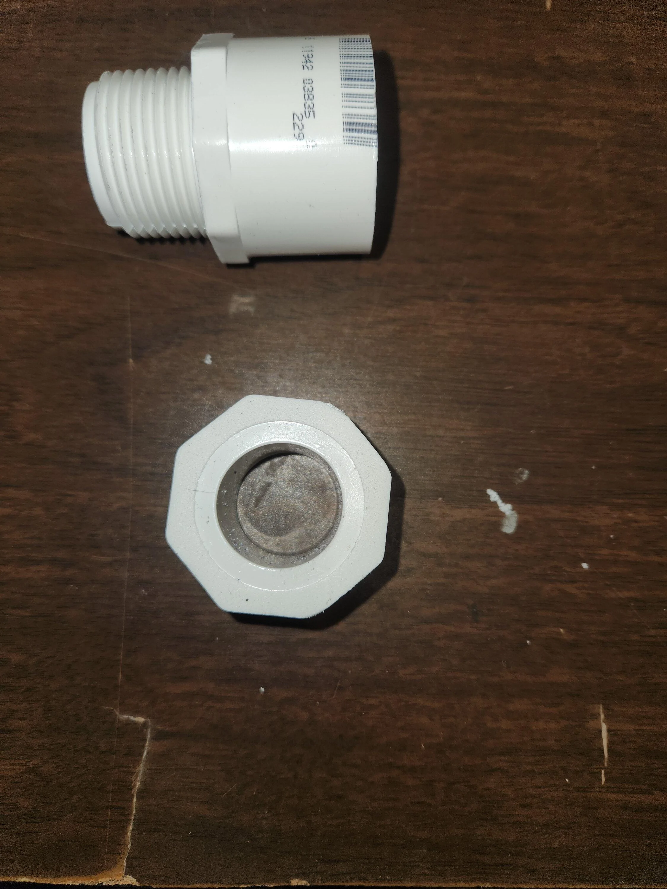

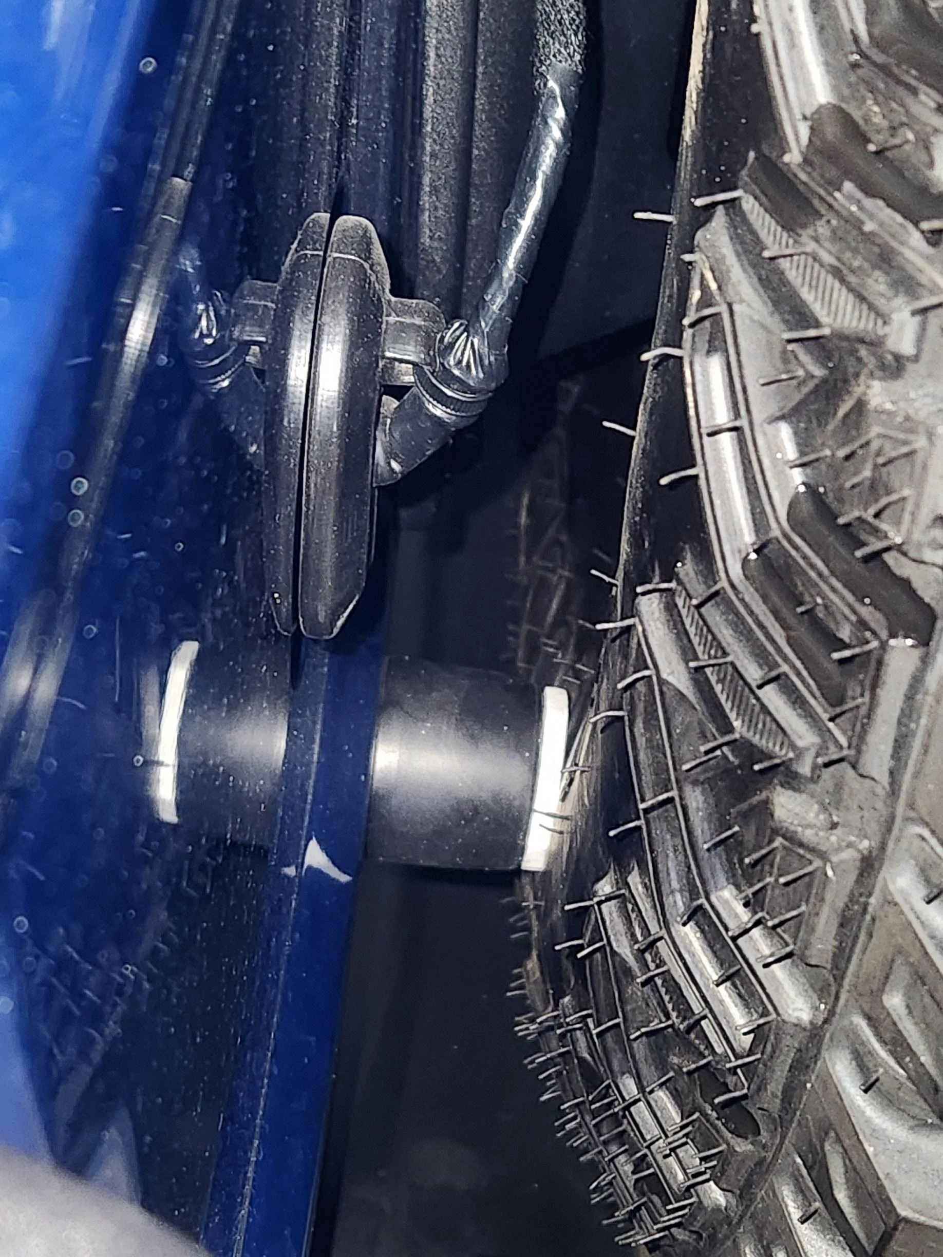

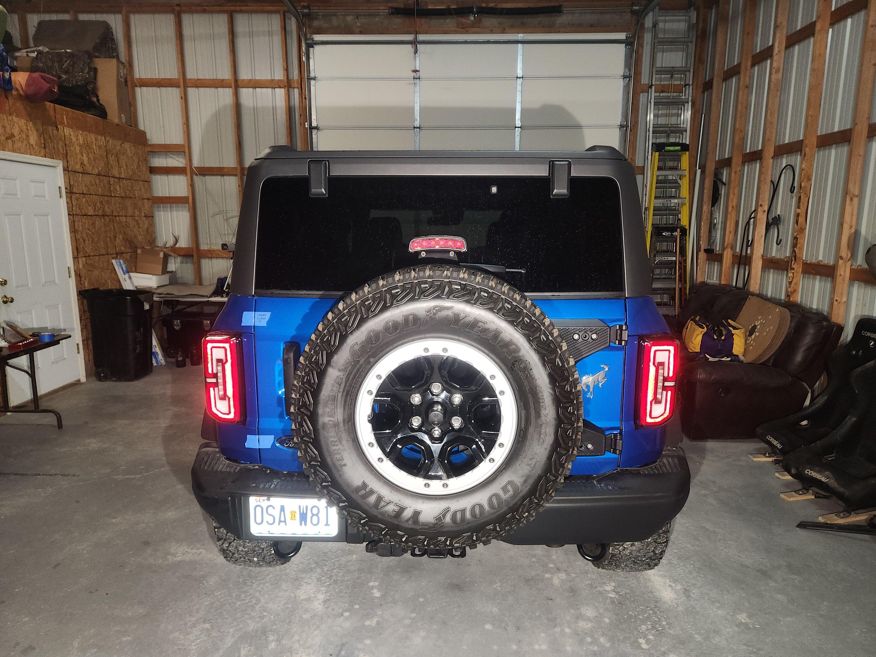

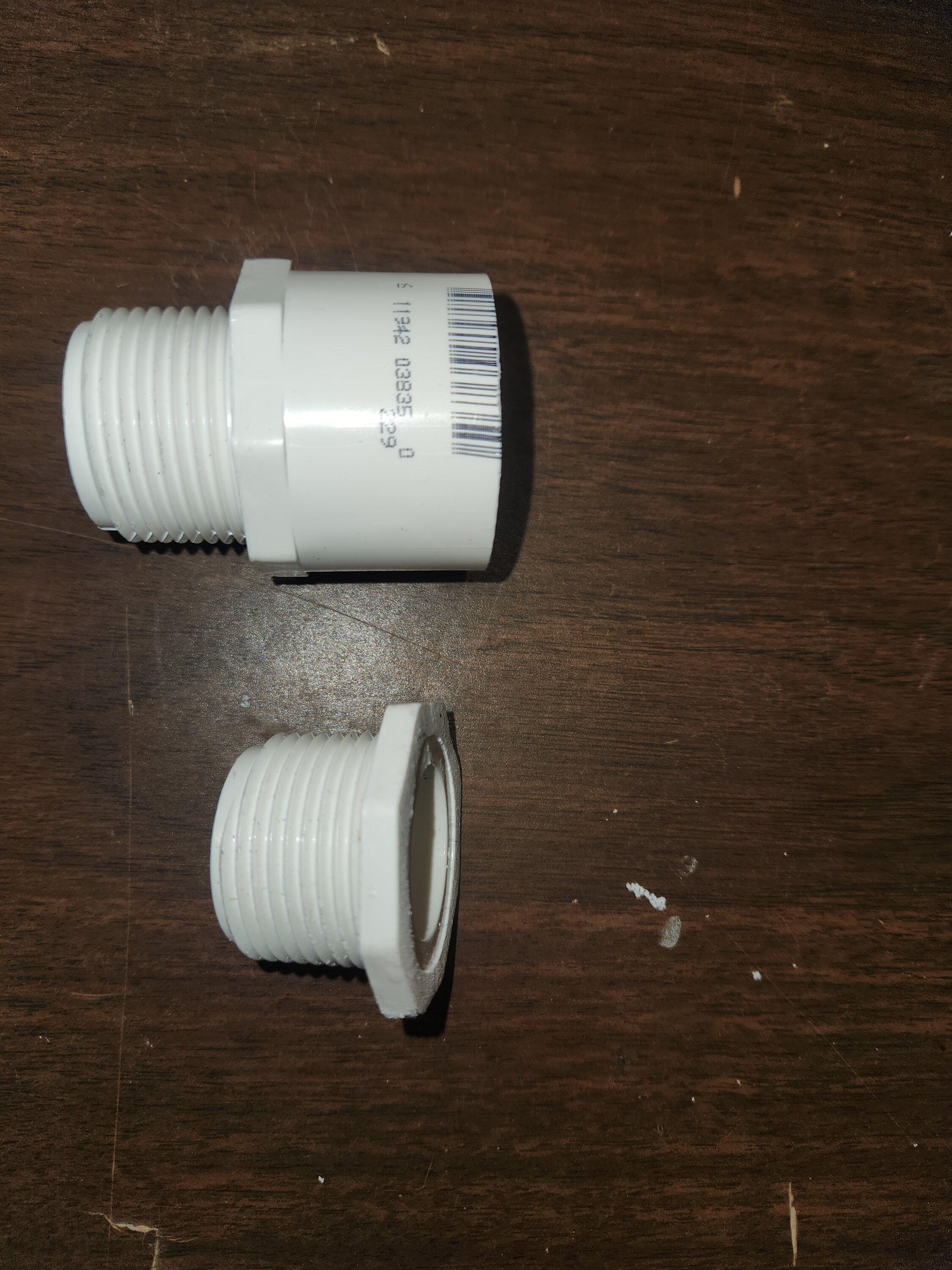

Here is what I did with my "FauxSquatch" Badlands: I also still have the non-SAS carrier. I found some near new Sasquatch takeoffs (+33) and after the swap, the rubber bumper was about 3/16" short. After calling around and finding out Ford wanted $25-$30 for one bumper I decided to try this. This should also work for other combinations since you can basically trim down the PVC adapter to the length you need. I used a saw to take most of it off and then used a palm sander to smooth it out and take it down to the needed length. The threaded portion of the PVC adapter fits perfectly into the factory Badlands bumper (may need a little Vaseline) If you are really anal you can probably find black PVC fittings to use lol. I tried but the local Home Depot didn't have them in black.
Also for me, this is a better option than swapping out the bumpers. Initially I was going to sell the factory Badland wheels and tires (KO2's) but after trying to sell them for a couple of weeks and not wanting to give them away, I decided to just keep them. I plan to run the 33's during the summer and for longer trips and use the 35's for winter and light off-roading. Using the PVC adapter option makes it easy to remove them when I put the 33's back on.
