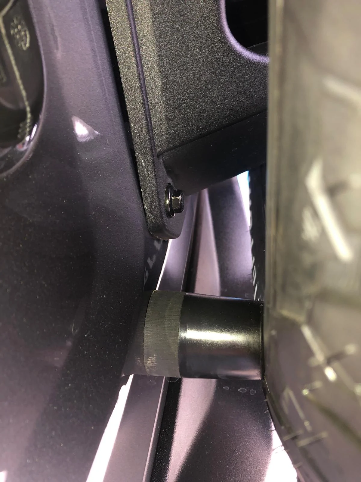

Measured what I needed which was 3/4” and went on e-bay and found a rubber 2” x 3/4” . Added it to the Ford rubber

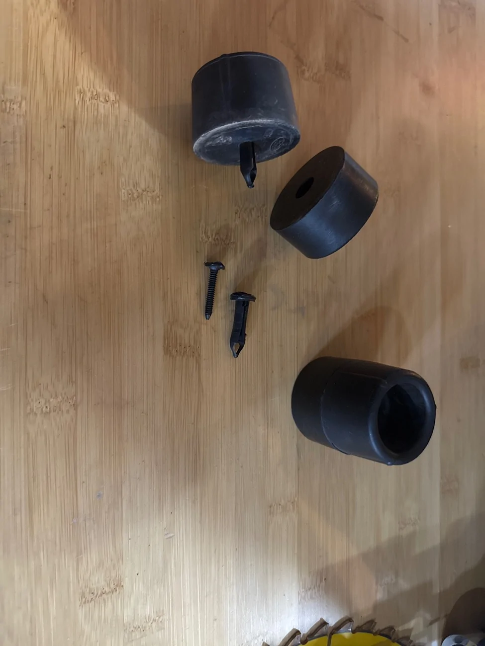

I went on Amazon and was able to find the rubber bushings to extend out, great suggestion. Question was how did you secure the factory bump stop to the rubber bushings to the tailgate? I was thinking it would be a longer screw but these are those plastic push pins and there isn’t a nut on the end to screw it into.

I thought about those but was concerned that when I need to change the tire that bushing could fall off and I’d forget to check on it. The other way it would be secured, but I would need to find a better way to secure it than I have so far. Lol

I was able to solve this by using a blind rivnut (M5 fits well in the factory hole) and then a 60mm bolt when adding a 1” spacer to the factory bump stop. Appreciate the ideas.
