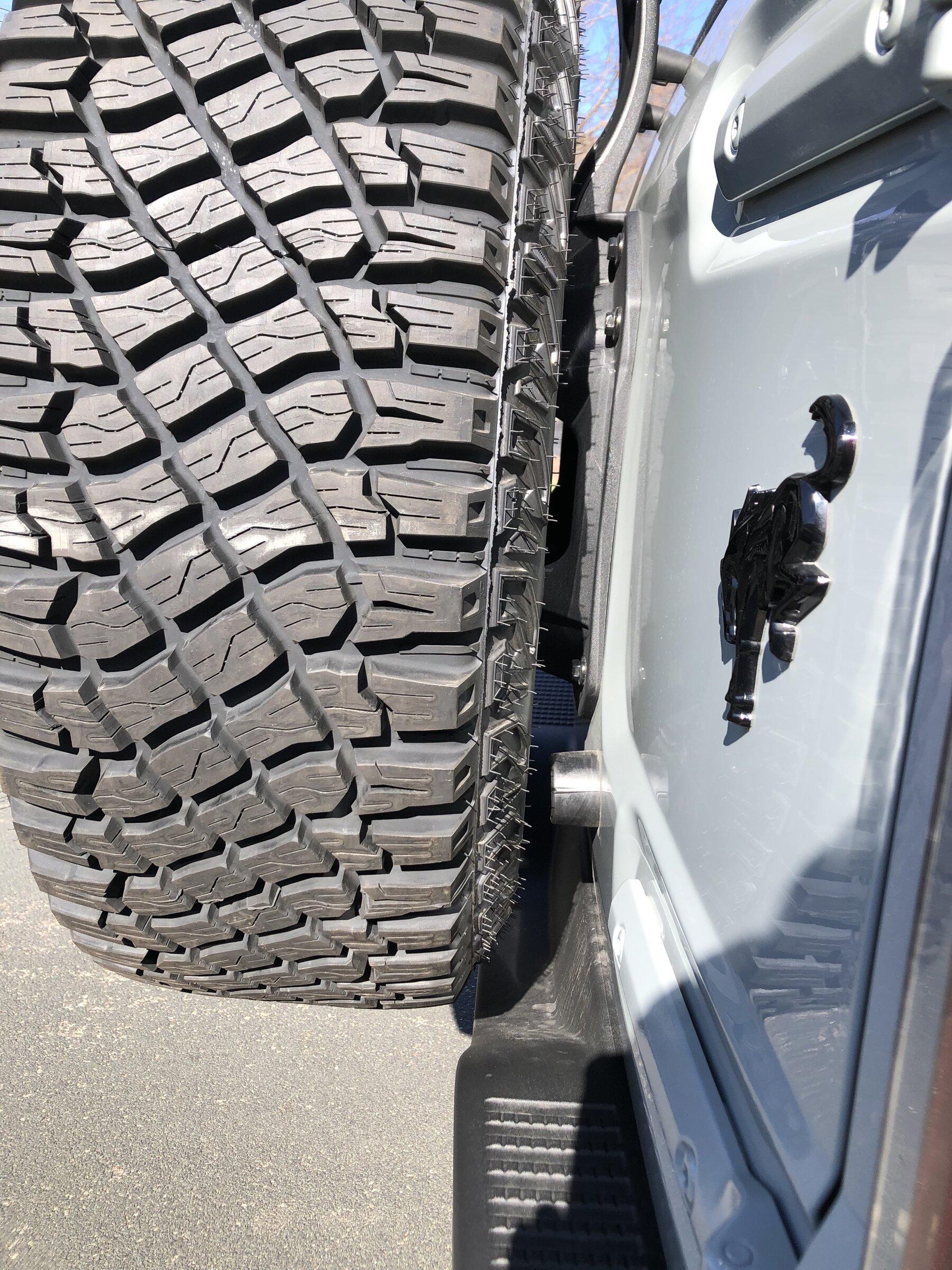

Has anyone come up with an option to space the rubber bumps out on the tailgate when adding a spare tire relocation kit? I went to 37s with the RC bracket and dont like the idea of it not resting on those rubber pads on the lower portion of the tailgate.

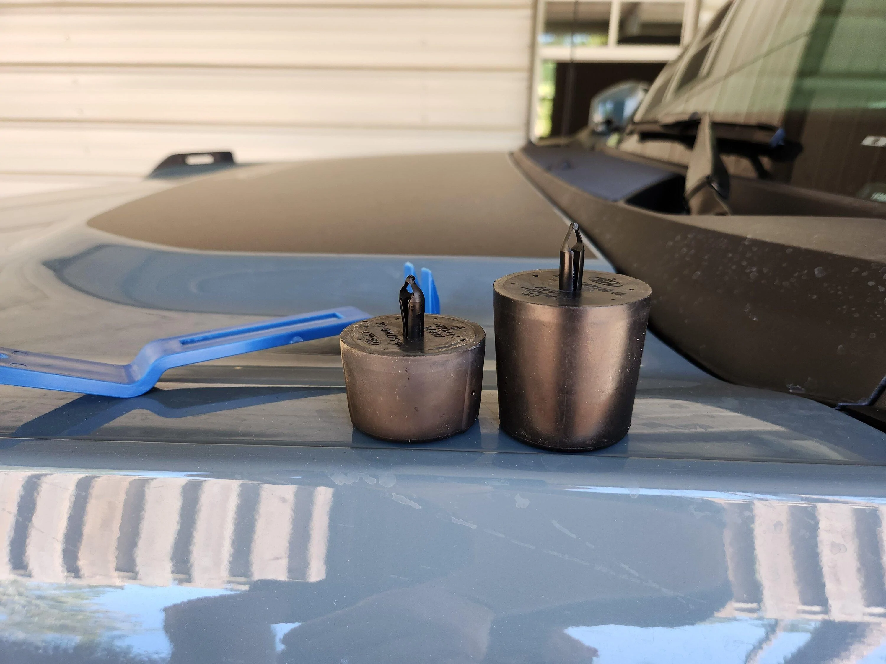

Here is the before :
Ford Bronco Spare tire rubber bumpers stock spare bum

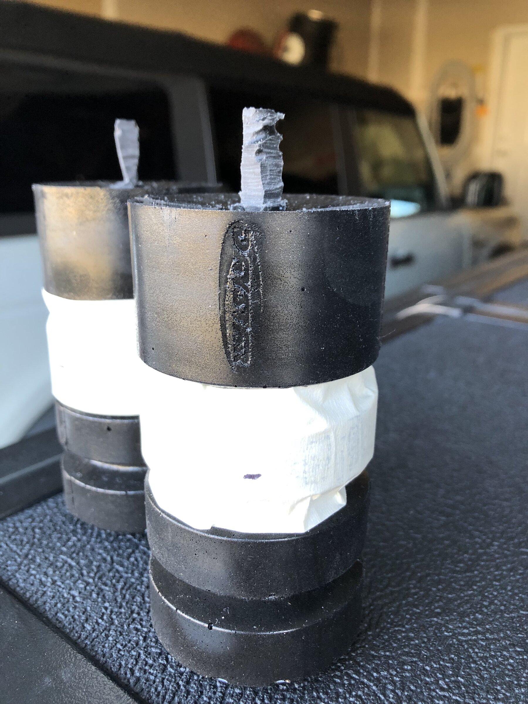

Modified bump stops to fit. Measure once, cut, cut cut. Since they are held on by pressure and some 2-sided tape, my high-quality cutting worked fine.
Ford Bronco Spare tire rubber bumpers bump mods

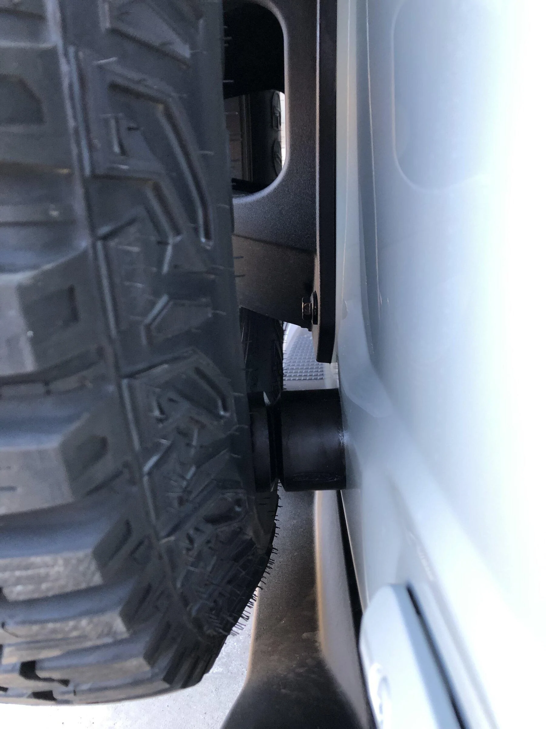

Result:
Ford Bronco Spare tire rubber bumpers bump stop n
