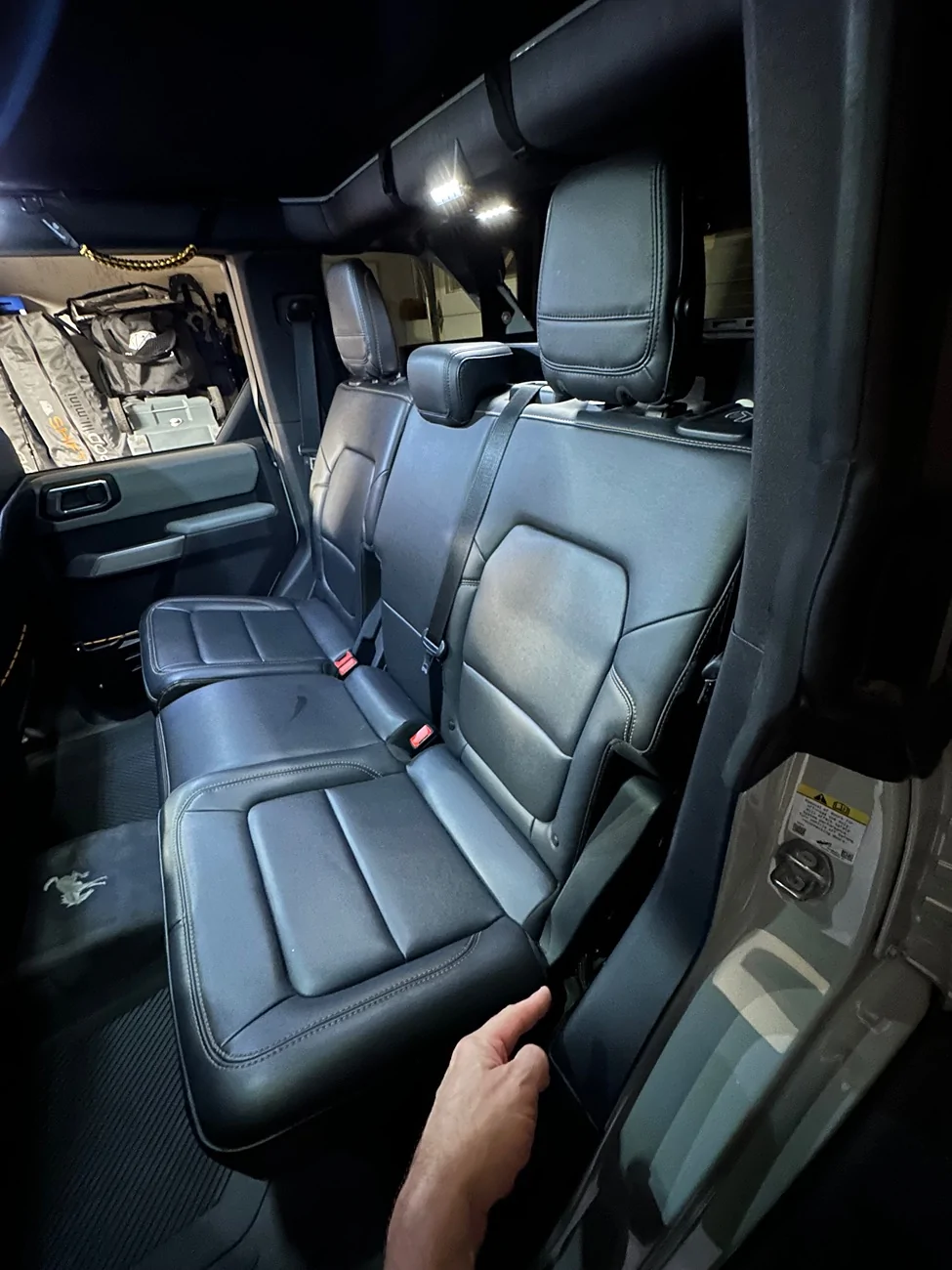

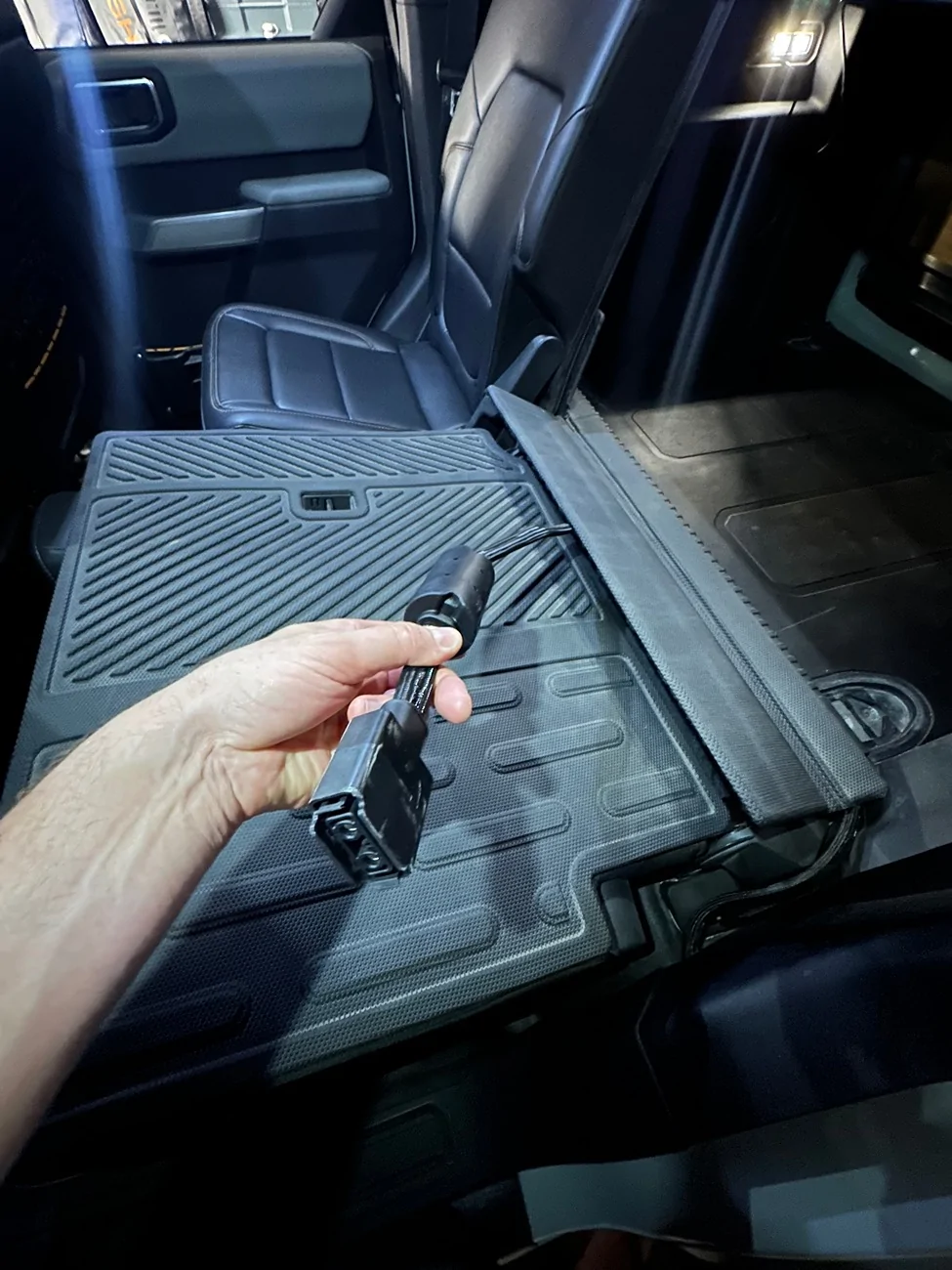

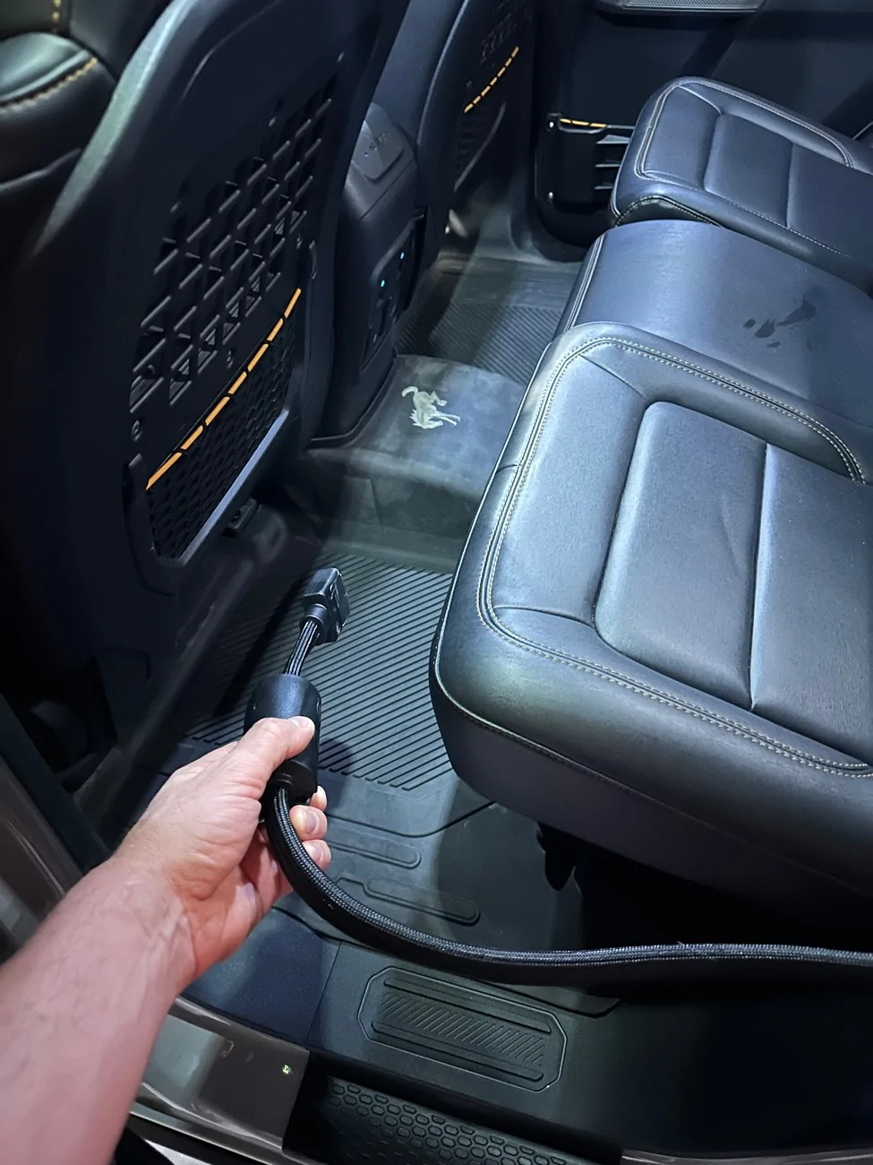

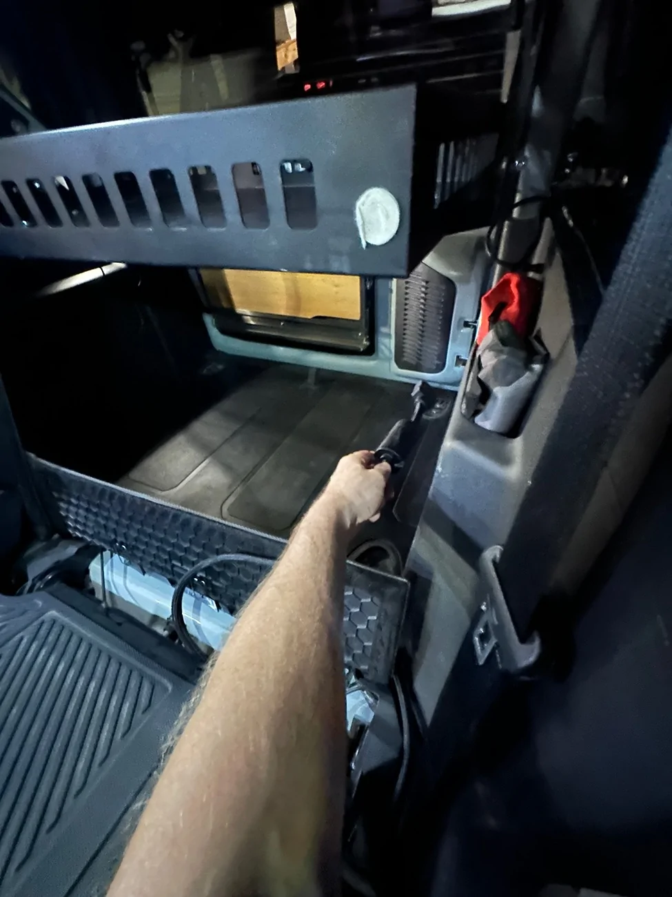

Now you just need to decide how you want to run the cable / or hard mount the charger.
I did a lot of research and read a lot of install threads.
My personal use case is I go camping frequently but also daily the Bronco half the time. My general setup is “modular” modular in nature and I pack things when I need them (fridge, recovery gear, EcoFlow, camp stuff etc.) as I don’t like to roll around daily with all the “overland stuff attached” taking up space and adding unnecessary weight (my personal preference).

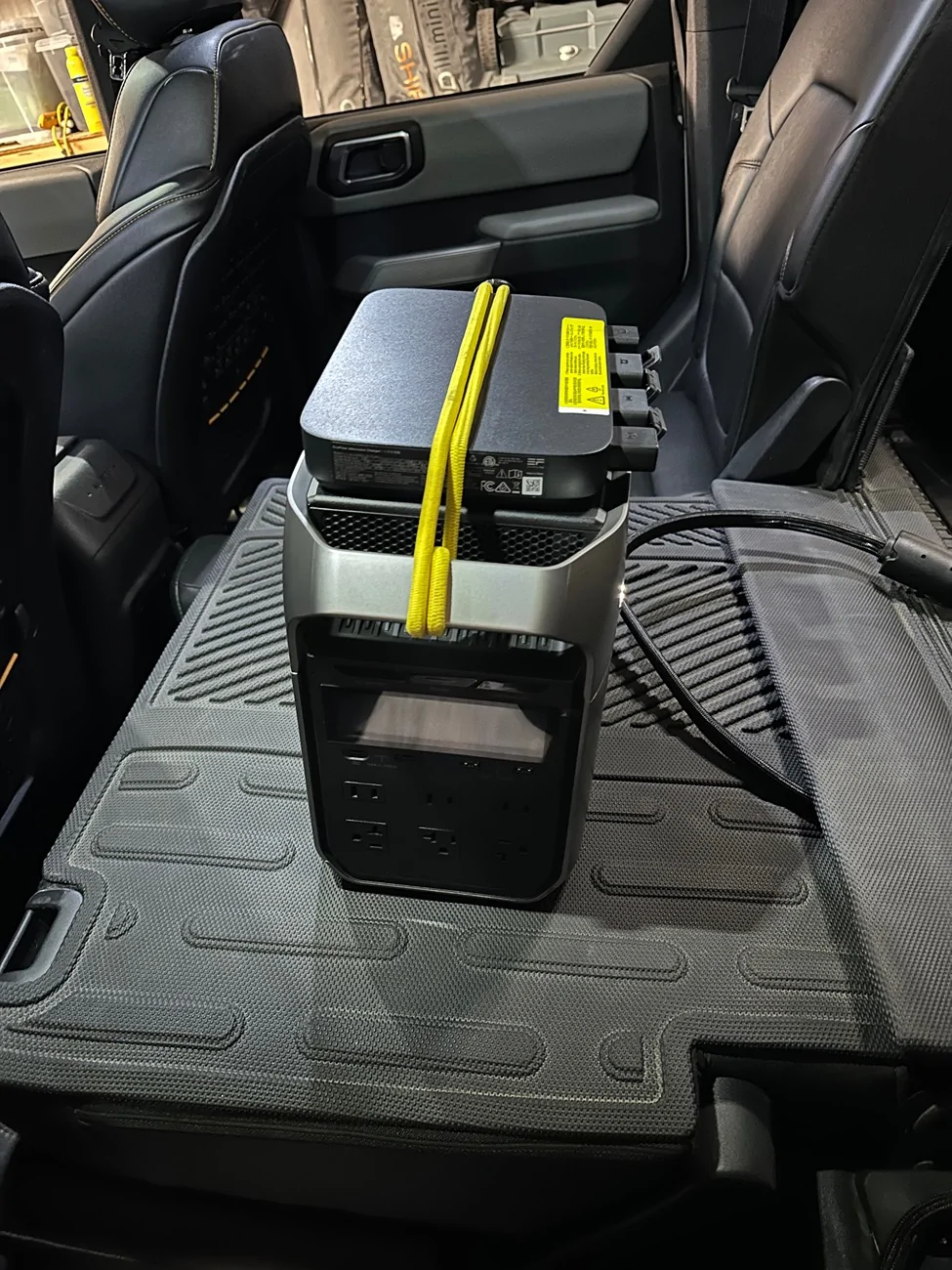

Anyways, for now, I ended up deciding to not perminantly mount the alternator charger in a specific spot since the location of my EcoFlow Delta 3 Plus will vary depending on my packing situation, number of people going, how much stuff I’m bringing, and therefore where I will pack the unit.

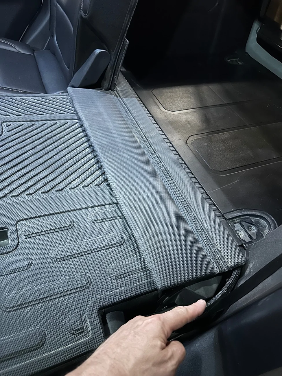

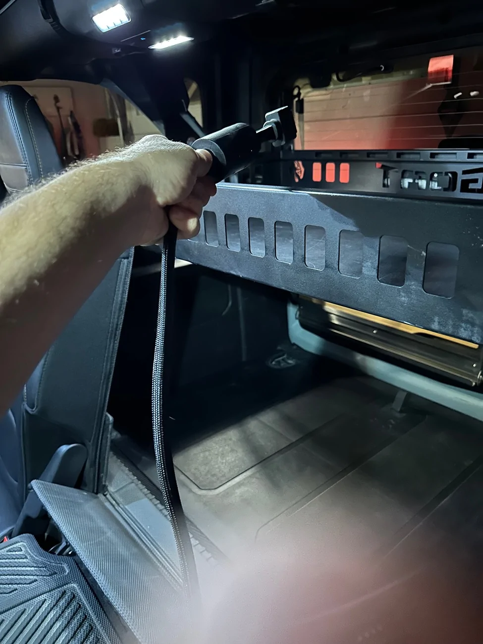

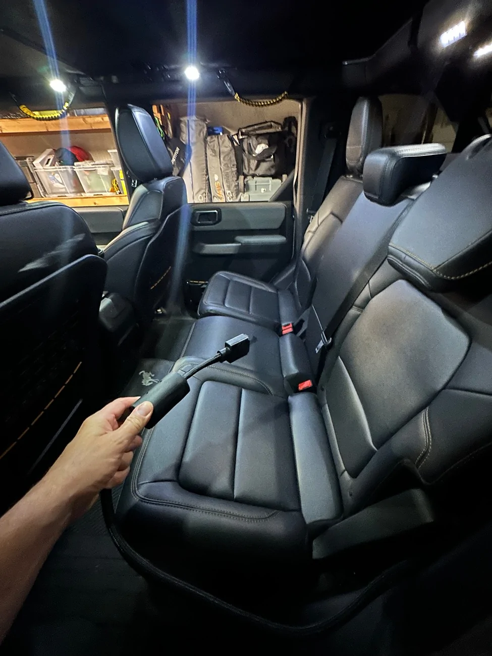

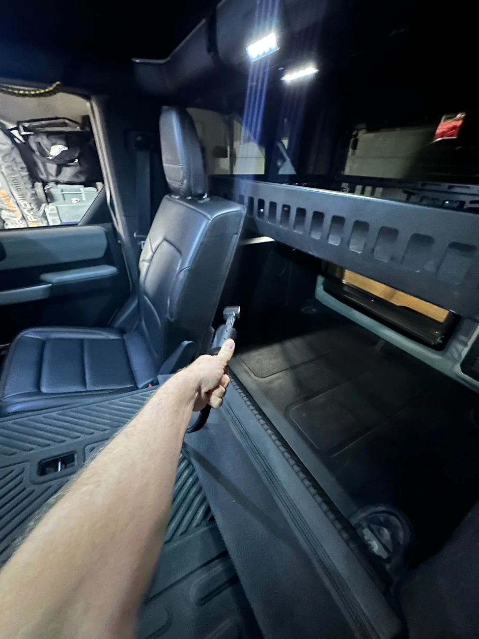

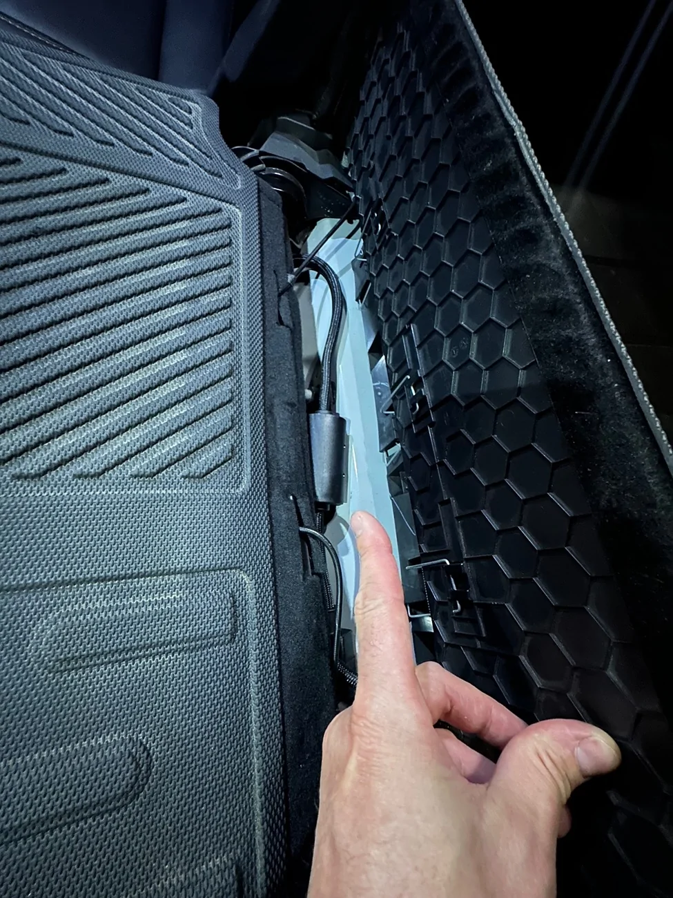

I ran the cable to the back of my 4dr, found a really nice way to store cable end behind rear seat hinge (do be mindful of pinch points).
The way I did it, here is enough slack for me to strap the alternator charger to top of the EcoFlow and reach to different locations in the truck I may need to pack the unit depending on factors mentioned above.
Many ways to do this, figured I would try this for now for my “modular / trip dependent” approach. We will see how it works out.
It tucks away so nicely when not in use, then I can reach the cable to multiple locations.
