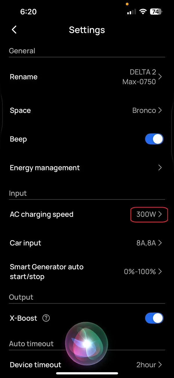

The inverter doesn't work directly with the ecoflow, because the ecoflow requires a pure sinewave, and the built in inverter provides square sinewave signal. The signal is too 'dirty' for the ecoflow to use. That said, if you could do it, you'd want to turn down the ecoflow from it's max AC (which you should do anyways). It's a 400w inverter, so you'd want to set it to something lower than 400w. I usually charge mine at 500w on AC, but you can easily lower the value in the app as shown below.
Ford Bronco EcoFlow Alternator Charger ecoflow_input

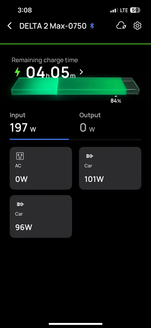

OK got the converter in today, and tested things out. TLDR: It works. The longer version is that it didn't work as well I as I had hoped. I'm able to charge the ecoflow off the inverter @ 101w. I'd hoped for a larger value, but I think the converter is the problem. It's advertised at 180w but that's a lie. Before I went out to the bronco and tested, I plugged it into the wall, and it put out...101w on shore power too.
Since I have two input ports on the back of my Delta 2, I plugged into the center console 12v port as well, and got 96w there so you can see the difference such that it is.
Ford Bronco EcoFlow Alternator Charger IMG_1852
