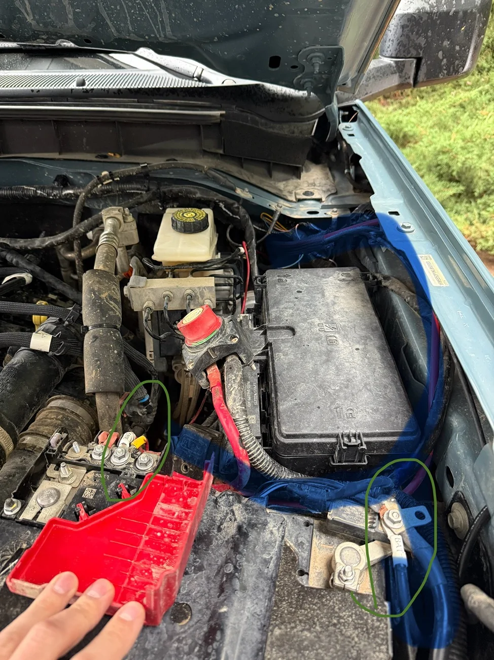

hello team! Can someone post a picture of their alternator charger cable connected to the battery posts for this EcoFlow chargers (500 or 800w)? What post did you use? The larger one that’s usually empty on broncos or did you connect before the BMS? Every time someone has asked this in other forums someone will just reference to a 20min video. Just looking for a photo of what you did!!
Thank you
Thank you
Ford Bronco EcoFlow Alternator Charger IMG_0638
