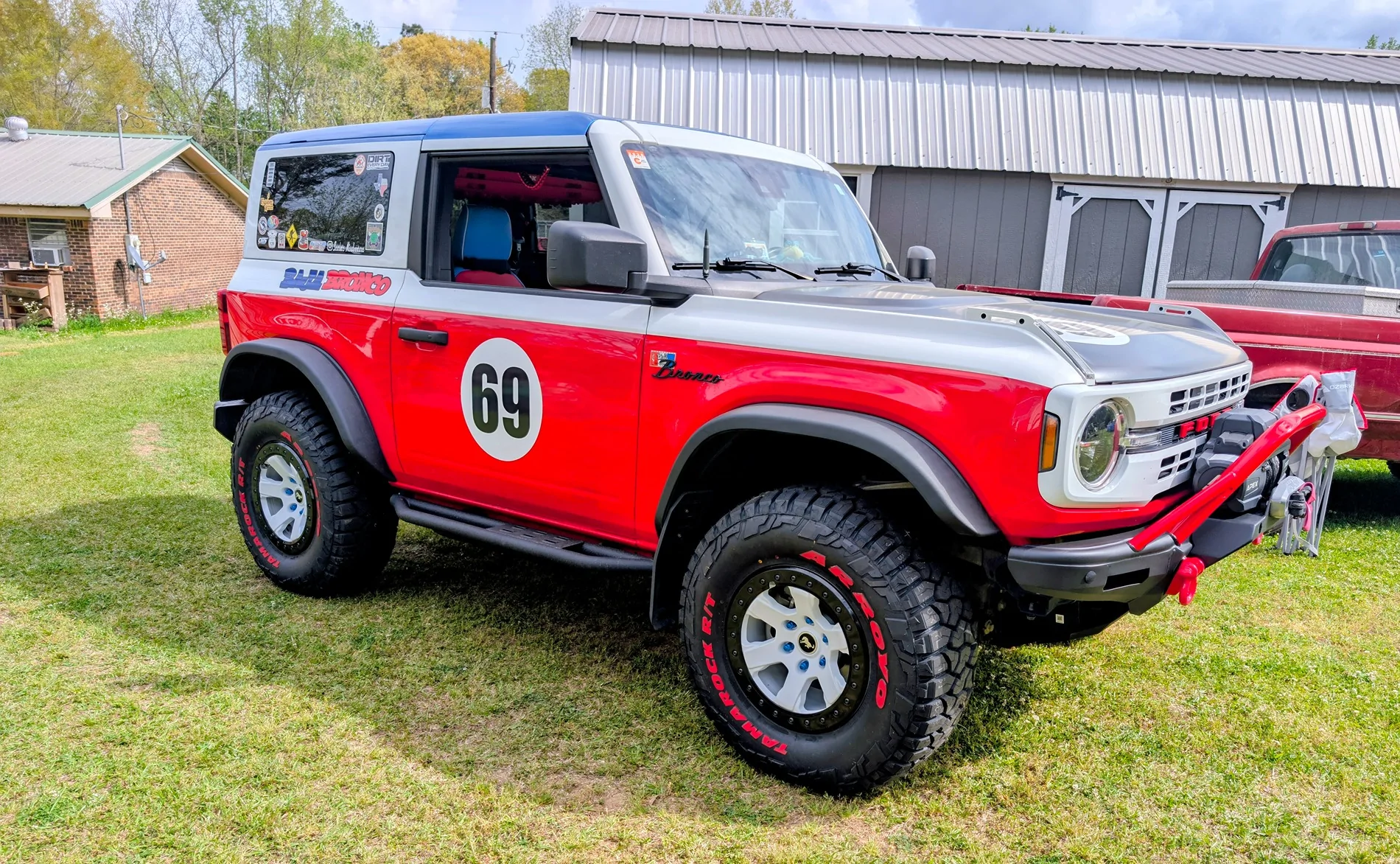

Running 35" F load rated Arroyo Tamarack RTs .
I hate punctures, and do what I can to mitigate the chance.
Not much rougher or louder at speed than the factory MTs.
At low speed you can feel the chunkier lugs.
Ford Bronco E load vs C load tires - what's your pick? PXL_20260403_202228029~2
