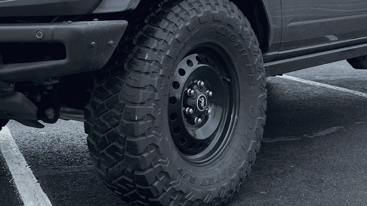

B Miller, those are the tires I got, and I've been waiting to reply to a E rated thread. I got E rated Toyo Open Country R/T Trail and I love them on my Big Bend 4dr.
I got the 255/80 R17 size because I wanted taller, not wider. I don't want to throw rocks outside the fenders. I ride in the desert, it's all rocks, cactus spins, or sand. You need something tough and puncture-proof. I concur with what was written above, "the lower the tire profile, the stiffer the ride." Maybe all these "hot wheels" wide tires are part of the alleged "stiffness problem."
Now that my "why" is over, I can report on the E-rating proverbial "stiffness" on my tires. It's non-existent.
I was anxious about a rougher ride after a year on the stock BB tires. But I had more anxiety of getting a flat 3 hours from pavement. So I got the E-rated tires. I pulled out of the dealership and onto the pavement to drive home. Hitting all the expansion joints, potholes and rough patch jobs common in Arizona, that I had a year of experience feeling in the stock tires. Nothing. Not much of a difference. And that was aired up to 37 lbs by the dealer.
The next day I did the chalk test and aired them down to 34. The already fine street feel got a tad softer. Off road they felt stiff on the cobbles and washboards. Until....When I went on a 4 day 4-wheeling overland trip in a very rough desert wilderness, alone...I aired them down to 19 psi. The ride got soft and good.
I've ridden these Toyos in rain. In snow. In mud. In sand. And the ubiquitous sharp rocky trails. Fine traction every situation. I seriously don't know how anyone can say they are breaking traction on wet pavement on any AT tire, much less the high quality of Toyos. They must do drag-race starts from every light, like I see a lot of poor drivers doing in the rain.
I would buy these again, E rated next time too. Why go to a softer, more puncture prone tire out West, if you go off road a lot?

It's been a month or so and 2 rotations. These tires are great. I can ride on extremely sharp rock trails, they haven't gotten a mark on them. All Arizona conditions and some pretty severe "adult" 4wheeling like 2 four-day trips in KofA. I air them down to 19 PSI for offroad and they give a soft ride.
In town, I'm using about 32 PSI cold. Their ride is nicer than my wifes Mazda 3 which is pretty hard and you feel every joint. The bronco glides right over most things on pavement and you don't feel them. Getting 21.5 MPG where the factory tires got about 23.3. But I have total confidence these tires won't puncture.
