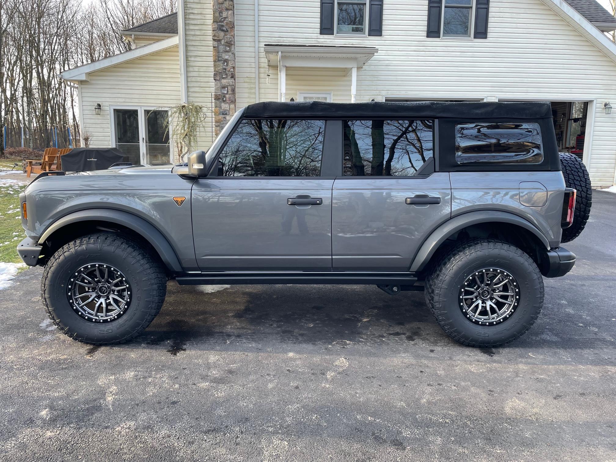

Load range E are usually 8 ply and for pickup trucks meant to haul heavy loads, or be capable of doing so, which you will not be doing in the Bronco. Factory tires are C load rated. You are running too high a pressure at 40 psi, why? They are not 45 or 35 aspect ratio tires and have a lot of volume and a tall sidewall where 34 to 36 psi will be more than enough. As you go down the highway the pressures will increase 2 to 6 psi depending on ambient temps over whatever you start out with. I feel your pain and it must ride like a lumber wagon..... Go back to the 285/70 R17s in a C rated tire. Are your wheels 8.5" in width? The 315s should be on a 9.5" wide wheel; yous look too narrow for the tire section width.
