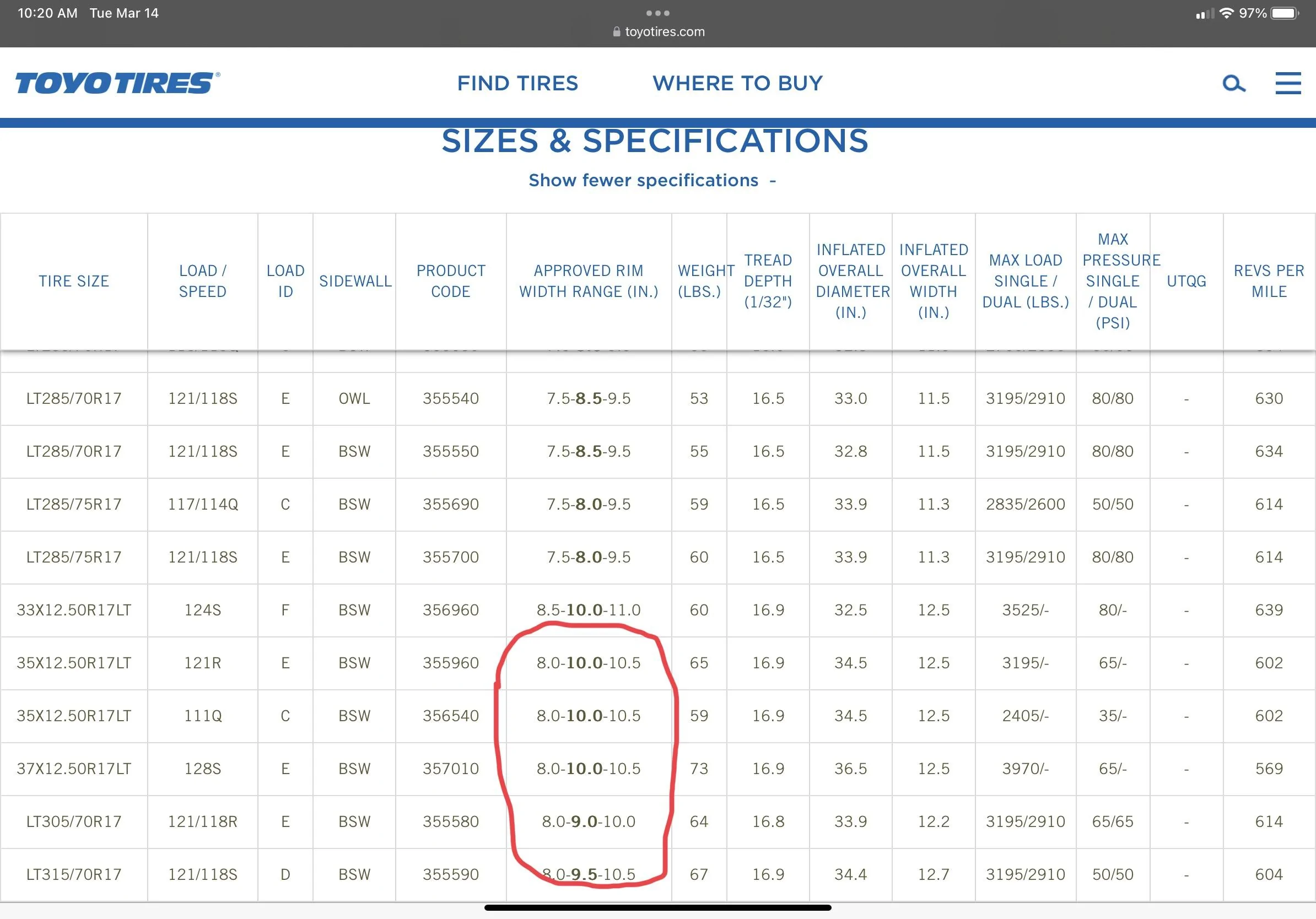

Toyo doesn’t seem to have any issues with 8.5” wide rims on anything except their F rated 33x12.50R17. Their chart specifies 8” in the approved rim width range. Running a wider rim in the rocks results in more rim strikes. I noticed a significant difference in rim damage when crawling going from 8” to 9” wide wheels running a 35x12.5R17 MTR aired down to 15 psi. Ford’s choice of 8.5” is not accidental.
Also a narrower rim is harder to lose a bead. I ran 15x7 on my 33x10.5 ko's and 15x8 on 35x12.5 and would air down to about 12 PSI and never had any issues.
