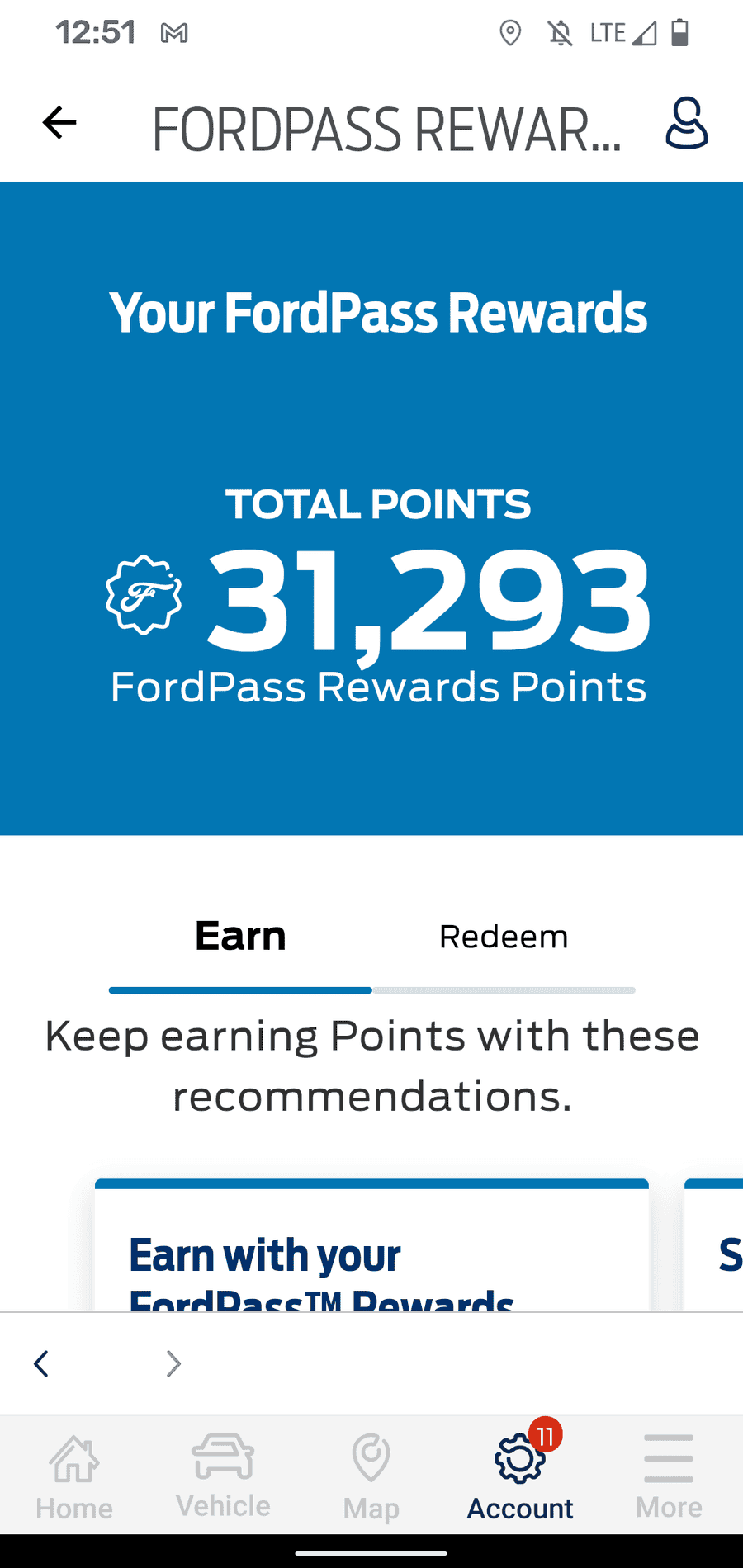

I don't know about you, but I take my vehicle to Ford and pay $39 for "The works" package. They change the oil, replace the filter, rotate the tires, inspect the brakes, check the condition of the battery, and fill all the fluids, no appointment necessary. In addition, when I take it back to the dealer I bought it from, they wash the car too. I have no compunction to climb under my vehicle and screw around changing the oil when I can get all that for $39. It just doesn't make sense.
I bought a 2019 F150 and got 60,000 ford pass rewards points, I now have about 26k mi on it and have had the works done 4 times. Haven't paid a dime!
