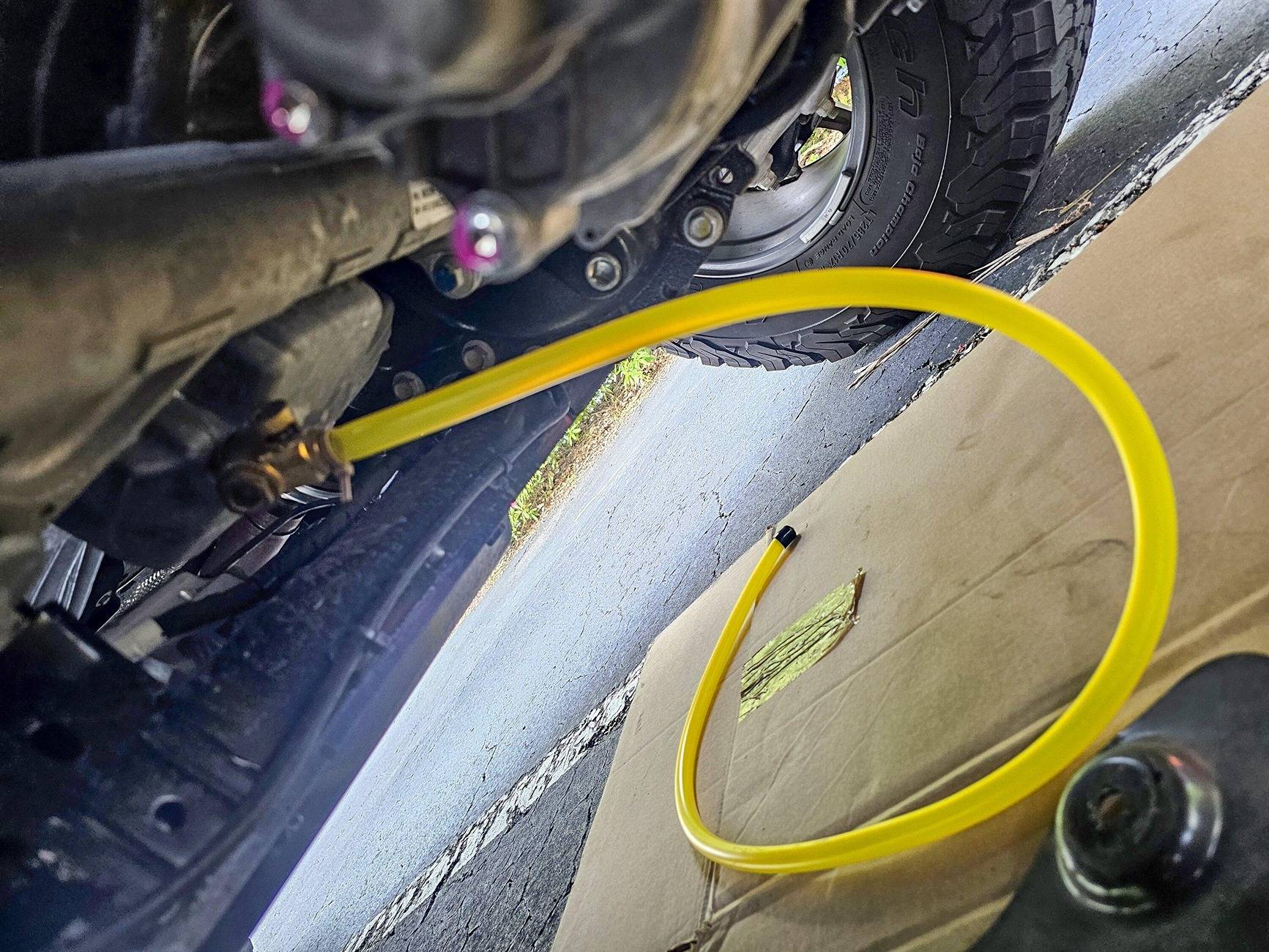

Nothing in life is guaranteed, but I assure you that I do not baby my Bronco, and not a drop. Fumoto valves are made for a wide variety of applications and have been used for a long time. I've used them in multiple vehicles personally. My current setup involves the Fumoto 107sx and a section of Tygon F-4040-A 7/16"ID fuel line zip tied and a vinyl cap on the end--all just resting on top of the factory skid plate for about 13-14k miles or so now. It's great for positioning one oil catch pan to catch the oil from the main plug/valve and the oil filter on the 2.3L. The 2.7 and its plastic pan are an unfamiliar beast.
Ford Bronco Changing Oil Drain Plug on 2.3L recommended? 1000023660
*factory skid plate removed w/2ft of tubing and black cap
I was just looking for a setup like this last weekend - I should have asked around here. Nice setup
