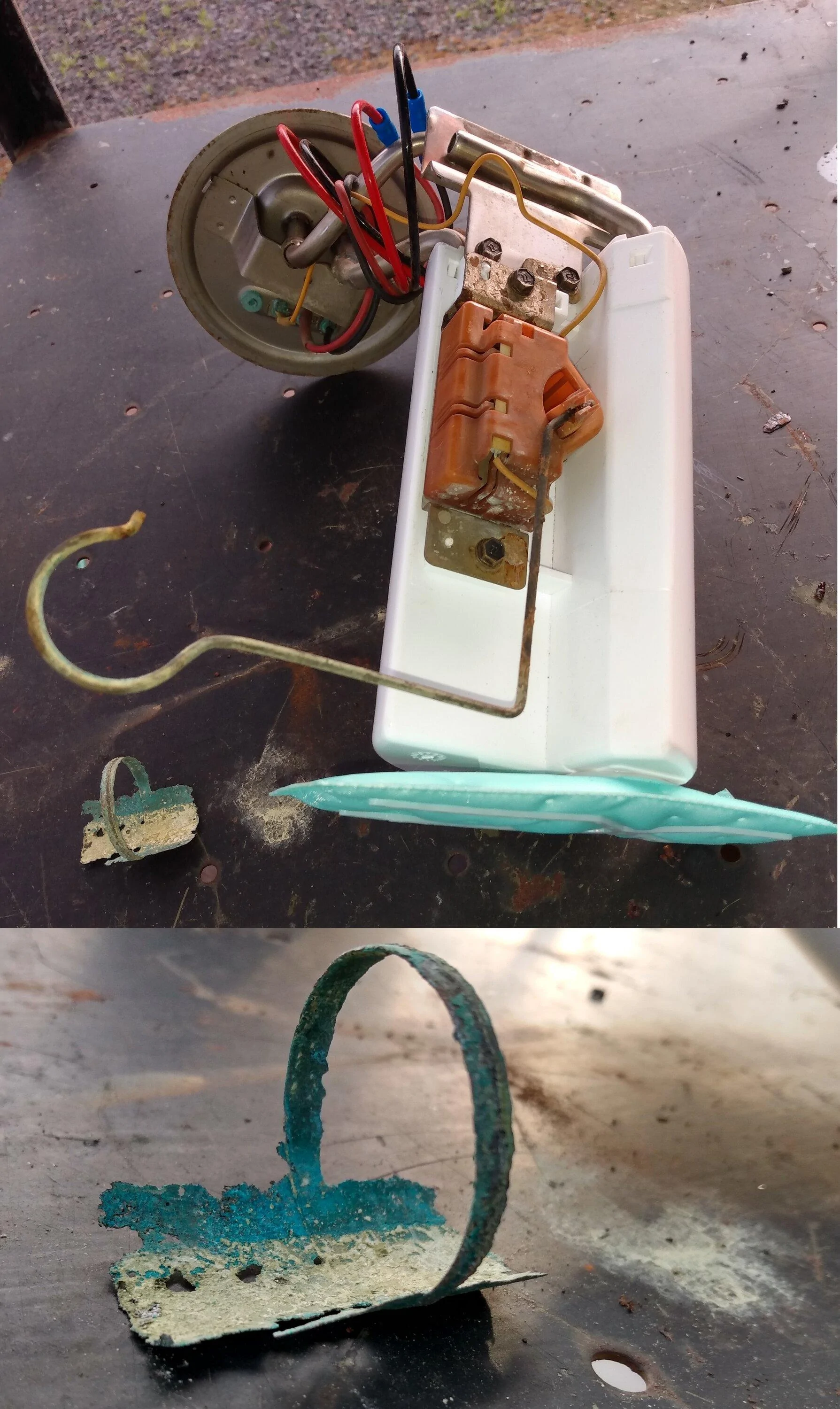

Ethanol gas can get nasty after it absorbs moisture from the air. This is the fuel pump from my '91 F-150..... the BRASS fuel level float dissolved away to nearly nothing.
I still use ethanol gas for driving, but make sure to replace it with ethanol-free when it's not being driven.
