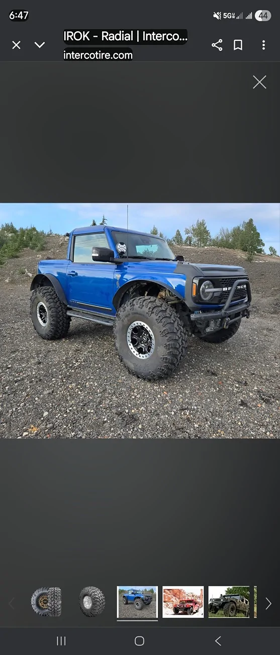

I actually have 1st hand experience with doing this...40s were easy 2" lift in front with top hat spacers, redrilled rear shocks mount 2" higher for 2" lift. mild trimming on rear, Major trimming on front.
Now Im running HUGE 41x14.50r17 IROCs, more extensive work was need to clear fenders in full compression, I took 2" off the entire radius on the fronts and 1" on rear fenders. Crash bars cut off flush with frame and front body mount trimmed back too, also radiator support was hacked back and upper fender brace chopped off. the result is very rewarding.
Appears Interco likes the look too and put my truck on their website 🤔

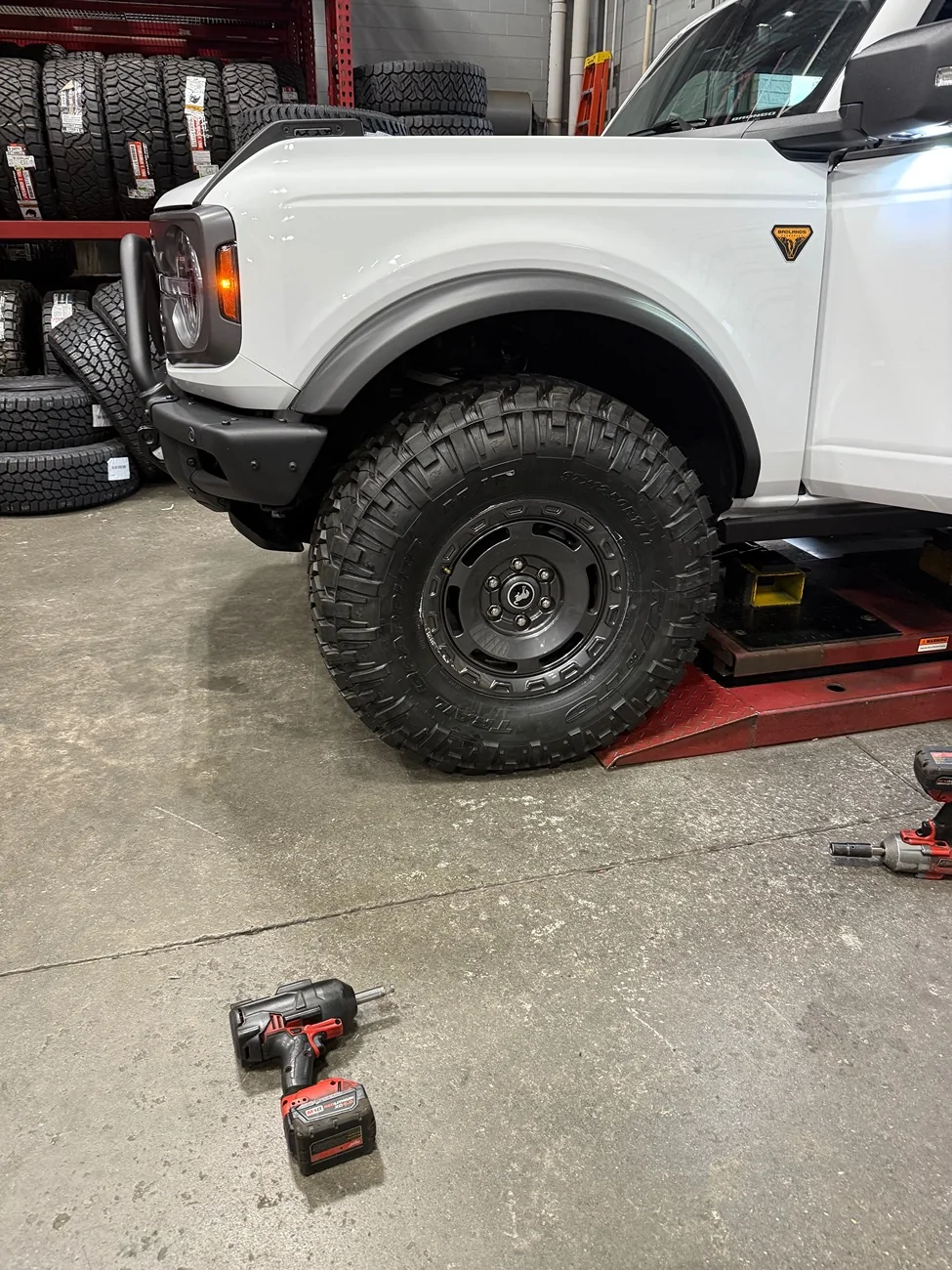

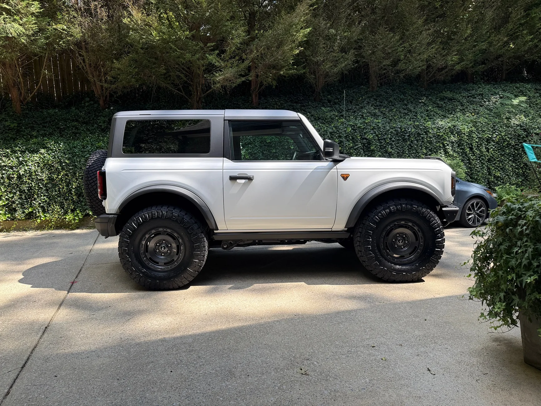

Nope. Three-inch lift won't do it by itself. You'll need some "trimming". (not to mention some other stuff). The highest I would go on stock SAS would be 37s (and that will need some finagling).
No finagling for 37’s they fit great.

So much fake news. 37’s on stock sas are good for everything other than major rock climbing with ridiculous flex. And mall crawling coffee shoes etc…

Agree, with a 2.5 to 3 inch 37s should fit fine. You have picture proof. I have seen it many times. It works well.
Yeah this is stock sas no additional lift
Now that is interesting because I would absolutely think at stock you would rub and full compression... Maybe not as long as you did the high clearance kit....
Nothing other than slapping the tires on. Have had zero issues on road and trails.
All the forums said you couldn’t fit 35x12.5 on a stock gmc at4x too. I’ve been driving with them for a year now trimming or and mods zero issues. I don’t think all rigs are built the same but I stopped believing what I read regarding fitment and just measured and went for it.
