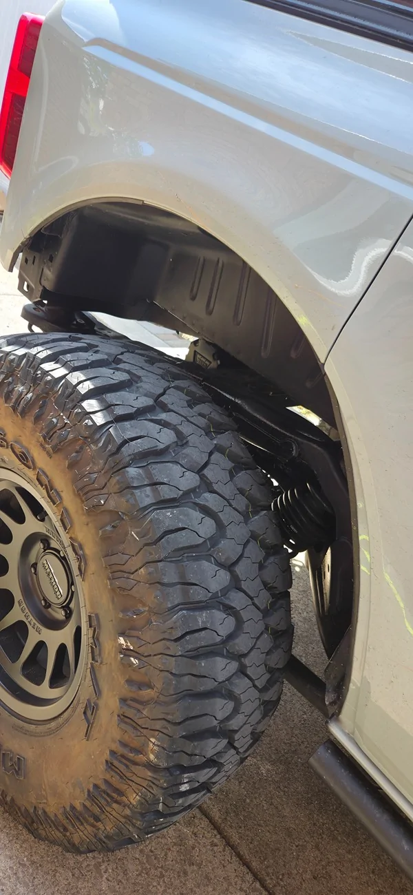

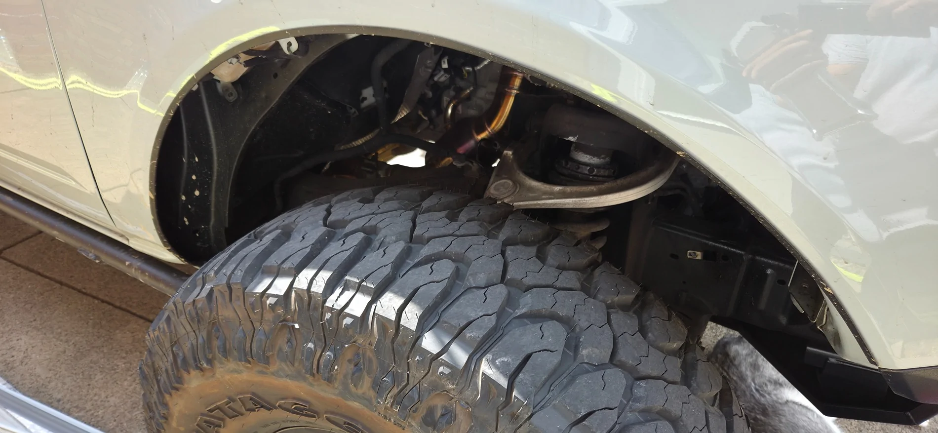

Got any more photos? That looks better than I thought it would!
I followed the curve of the body line. Debated every second i kept cutting lol. Bought some rubber c channel off Amazon and put on cut edge
