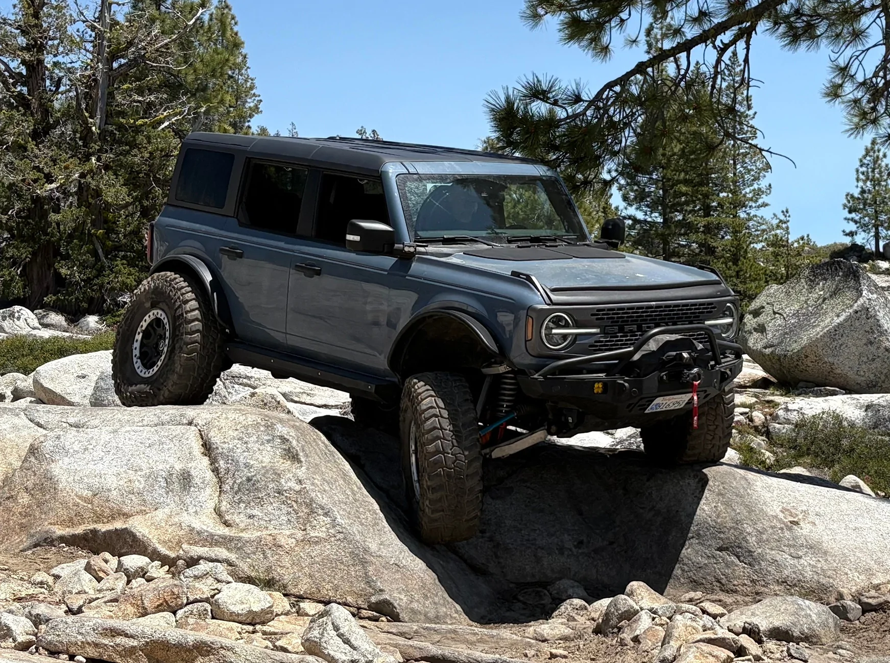

New fenders. Max tire kit. Suspension upgrade. Strongly consider Dana Ultimate front and rear axles and severe duty steering rack.
Several people around here are running 40s, I’d check out @BigMeatsBronco - some of his earlier build info

I have OBX SAS. 3' lift, crash bars removed, Camburg UCAs, Icon shocks, and I drive on 35s. I can go to 37s if I change the wheels (different offset). No trimming required.
Yup - sounds good for 37s - similar to what I’ve done for my 38s - just add a 3/4ā€ body lift.
But you may need more than that for 40s though.
