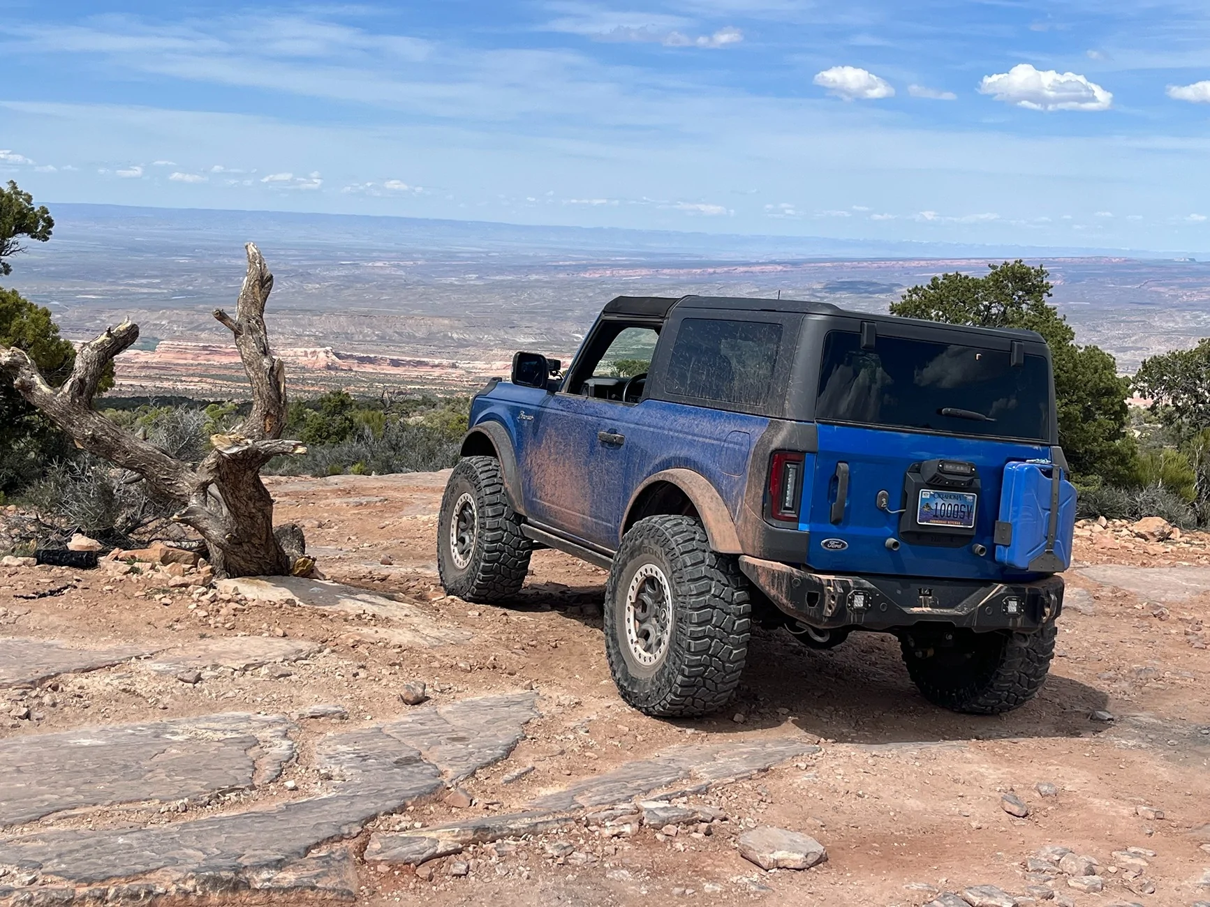

See, these worked just fine in your neck of the woods.... or lack of woods as it may be.
Ford Bronco Can I run 35s on 2 inch spacers? IMG_0823
