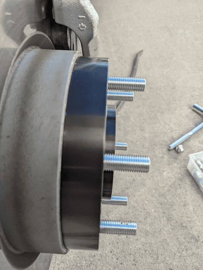

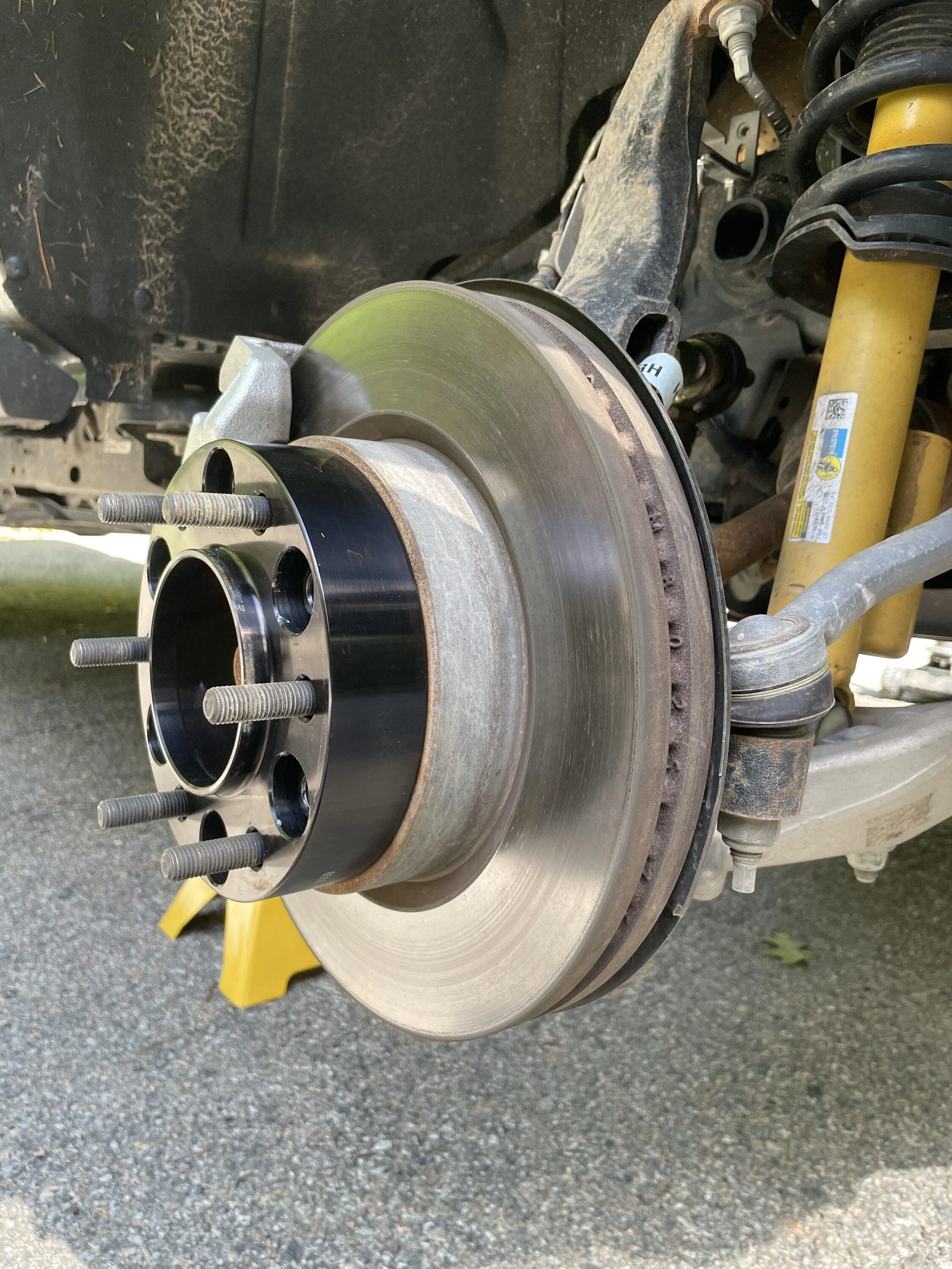

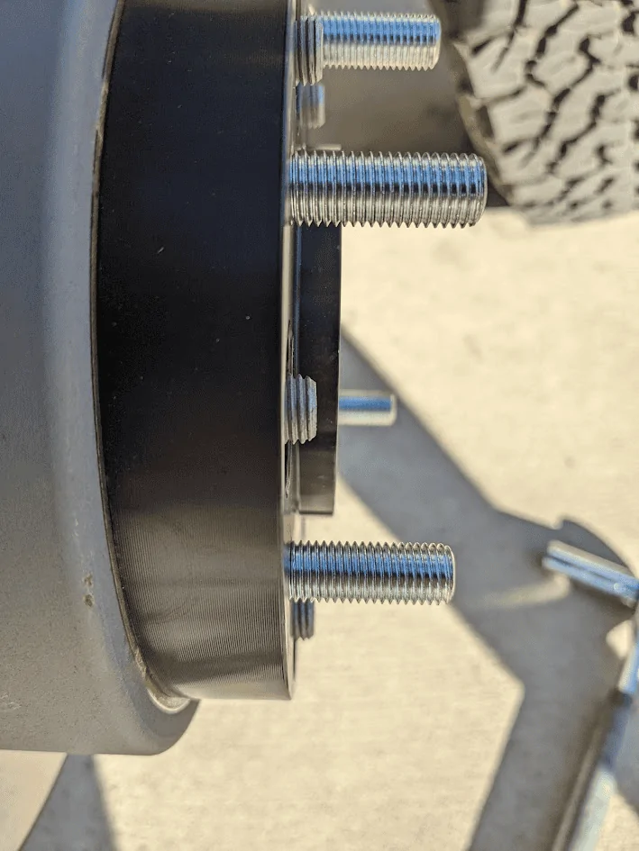

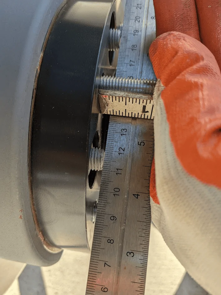

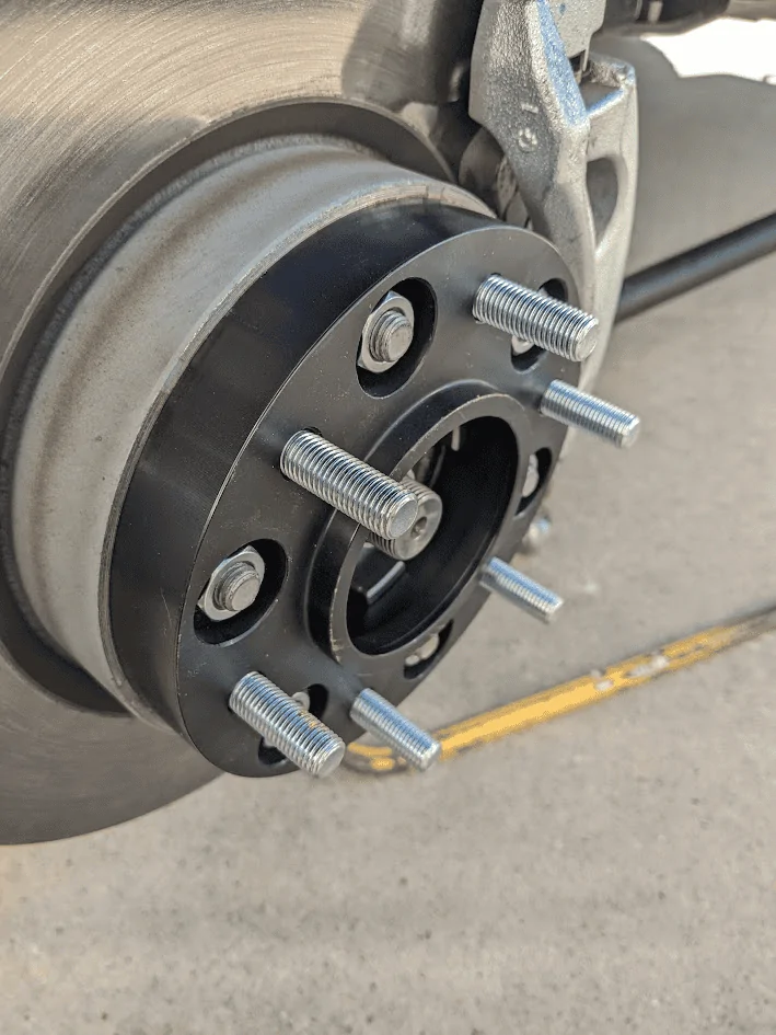

1" Bora spacer on a BL
Front:
Ford Bronco Anyone running 1 inch wheel spacers? 1704749042534
Front:
Ford Bronco Anyone running 1 inch wheel spacers? 1704749069704
Rear:
Ford Bronco Anyone running 1 inch wheel spacers? 1704749096254
Rear:
Ford Bronco Anyone running 1 inch wheel spacers? 1704749116465

Interesting. I was told we needed to do 1.5" spacers minimum....anything less would require trimming the oem lugs so the rim will set on the spacer flat. Guess that's incorrect?
BlueBronco
4,666
16,101
DFW
Depends on what wheels you are running. The optional BL wheels and the Squatch wheels have pockets on the back side that are deep enough to accept the lug poke. Scroll back through the thread for an example pic.
