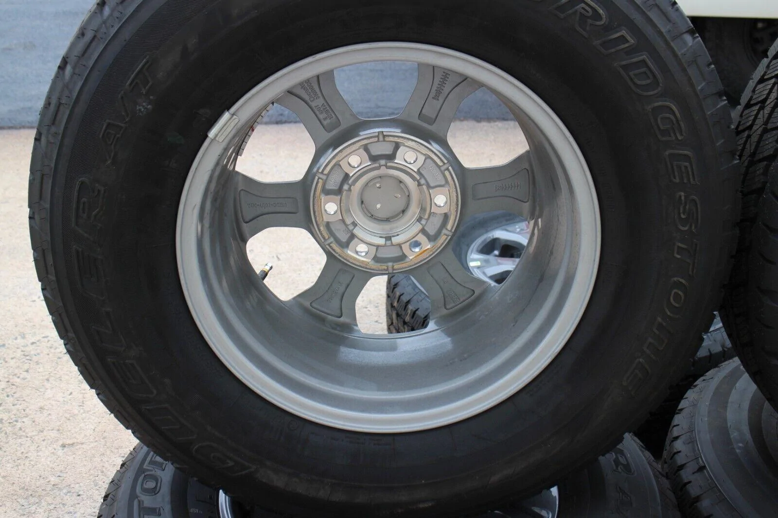

I found a picture on ebay that shows the big bend wheels from behind, there's definitely a pocket there just not sure what size.

2 things I learnt tonight trying to install 1" spacers on a BB:
1) The big bend standard wheels have notches that would allow the bolts except for one notch which is shallower than the others - it'll need one of the spacer bolts to be shortened
2) This is a 2 person job. Those wheels with tires are heavy AF.

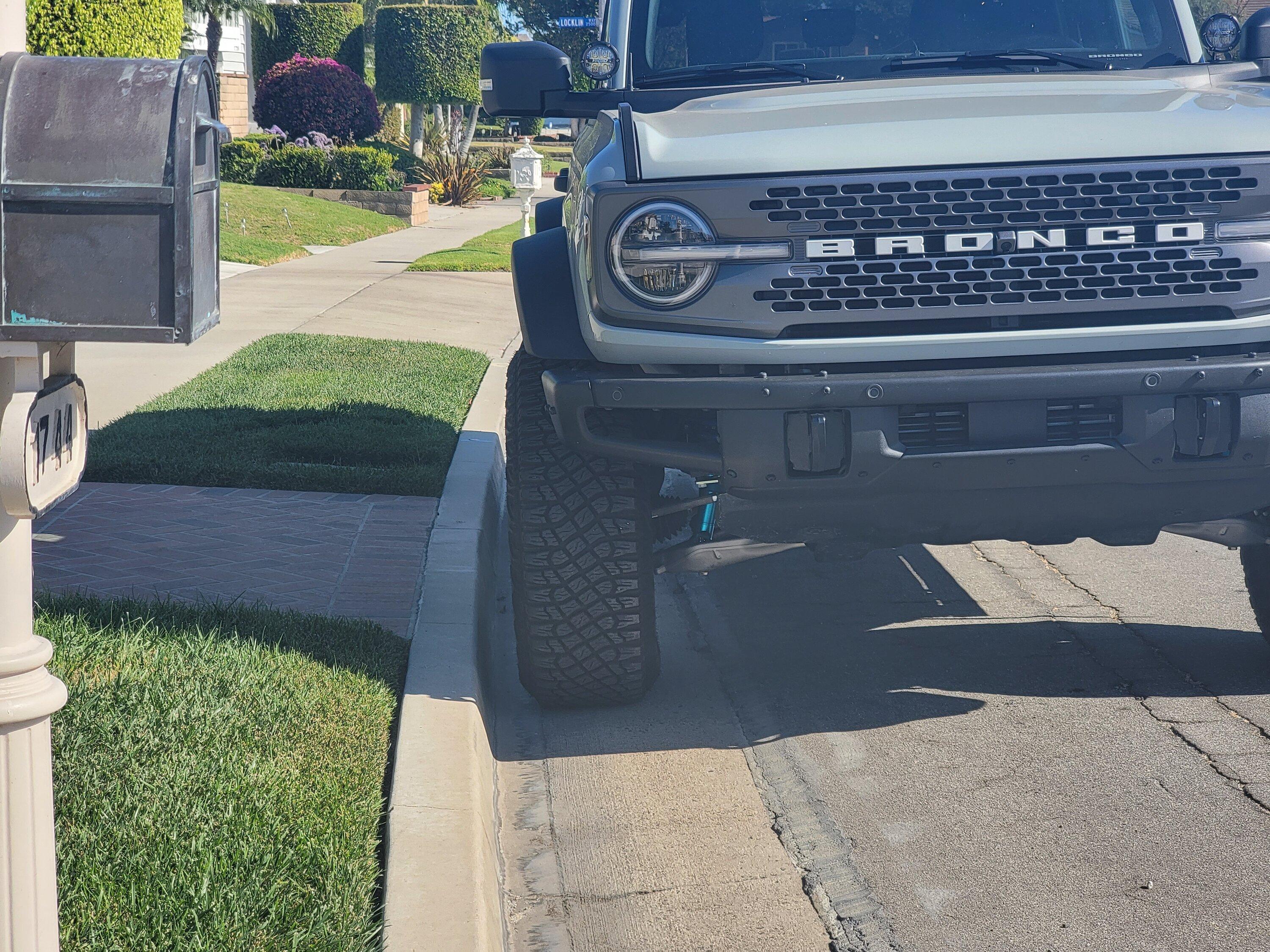

My Badlands | SAS with 1.25" BORA aluminum spacers from Stage 3 Motorsports.
Looks great. Any noticeable change in ride, steering, or rocks/dirt on side of Bronco?
